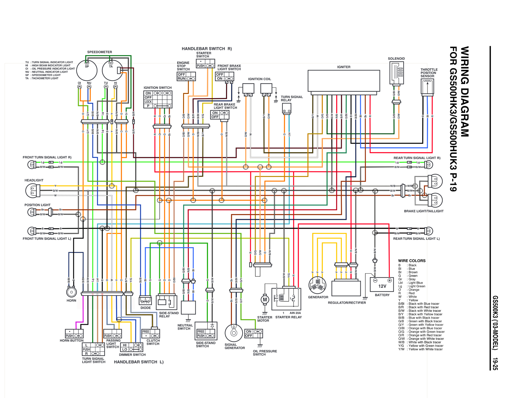

I've decided to install a command from an YAMAHA FAZER 600 from 2003, to get the WARNING button, and so replace the original command. But i can't find the correct way to plug cables between themselves. I precise that i have only onegreen flash on the dashboard, before starting this change, each time i turned left or right, the dashboard green light was working fine for each command (turn left - right).

Today, when I turn on the ignition :
- when I turn the blinker to the left, the turn signals works (Front-Back) and the dashboard 's light indicator works (it flashes)
- when I turn right, the indicators works (Front-Back), but the TDB light doesn't flash
- when I turn on the WARNINGS, the indicators work (Front-Back), but the TDB light doesn't flash.
Here's the wiring diagram for the GSE 500:
If someone could explain to me how to plug correctly the cables, i would thank him so much. I would like to go further on this bike, i have to clean carburators, and others parts...
