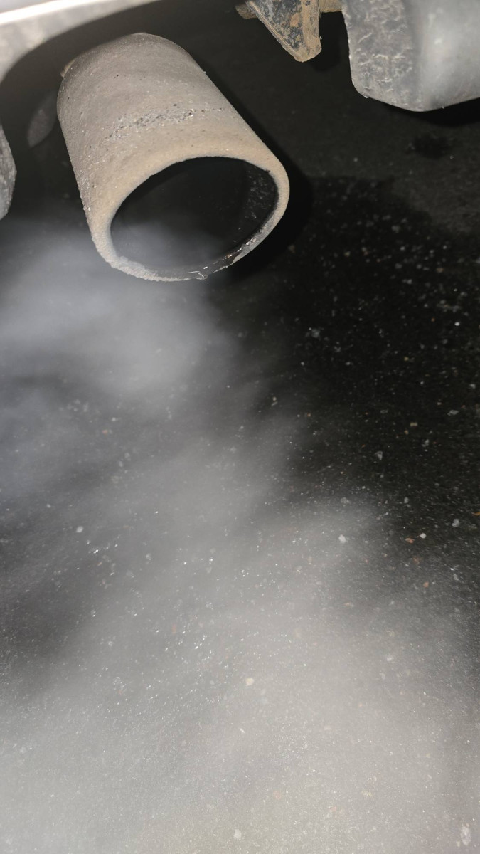

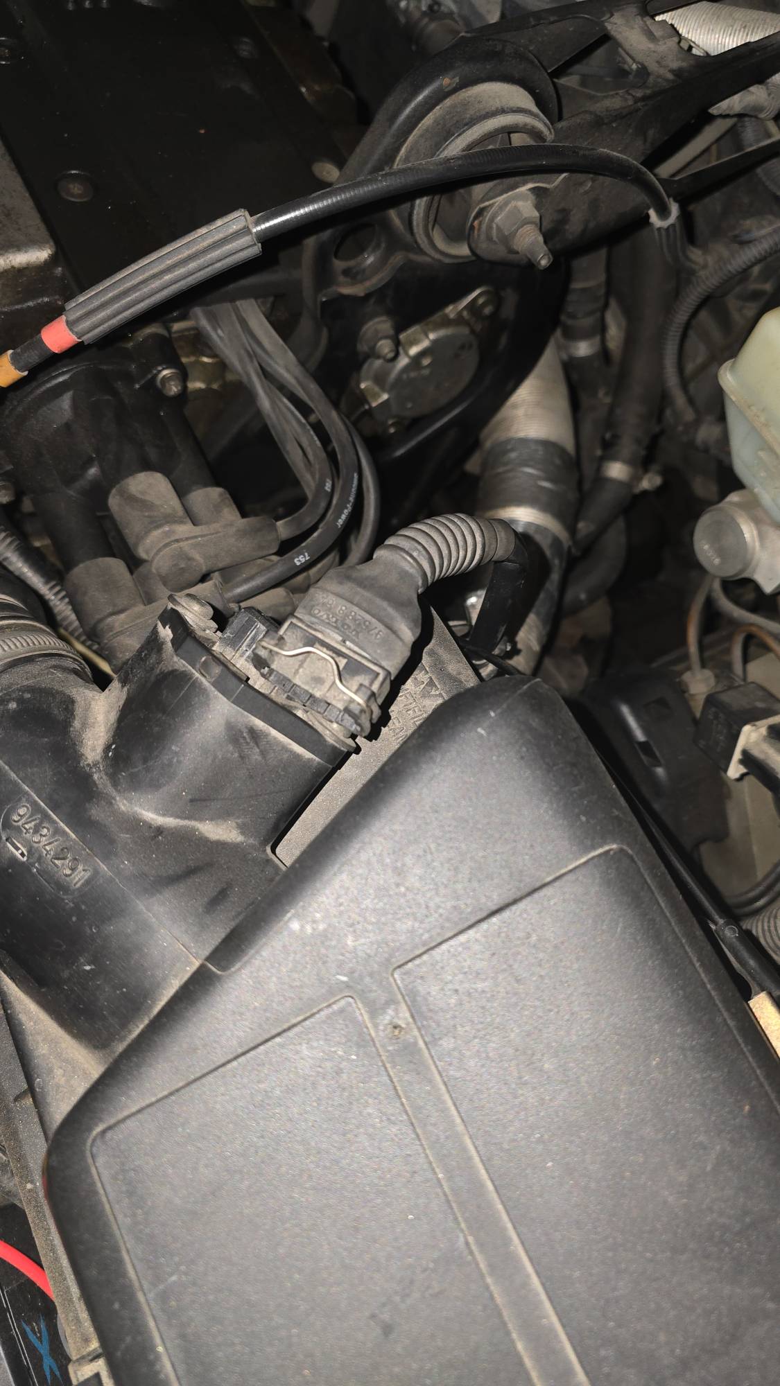

My transmission has started working again. However, I noticed that it is overfilled. I will address this issue when I change the PCV system. I was experiencing rough idling and stalling. While the stalling issue seems to have resolved (Transmission), the rough idling persists near 1000 RPM.
I disconnected the MAF sensor, and the car's RPM dropped, causing it to stall due to low RPM. If I remove it while the engine is running, it immediately stalls. This might suggest that the MAF sensor is not the root cause of the problem I guess?
Subsequently, the lambda sensor displayed a light on the dashboard. There is noticeable shaking and rough movement of the vehicle. I am uncertain whether the IACV, O2 sensor, injectors, or spark plugs are the root cause of these issues. Unfortunately, my inexpensive diagnostic reader does not provide any error codes. I have attached videos for your reference.

What about my MAF sensor? Car dies when I starting without it and stalls if I unplug during idling.
What about IAC Valve? I will check the Spark Plugs, Cap and Rotor.
