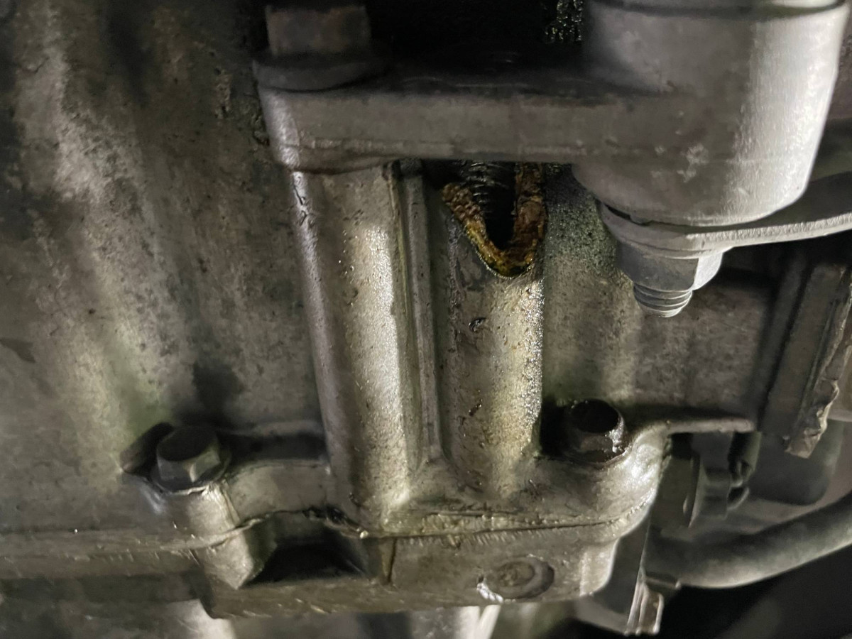

back to the Torque mount i got the back bolt out barely it was on there really tightly i removed the old mount and it was a little worn out i installed the new mount and tightened the bolts onto the subframe. then i tightened the back bolt everything seems ok should i worry about that one bolt thats missing along with the chunk of aluminum thats also missing? here are a few pictures for yall
Transmission Torque Mount bolt hole broken off

While less than ideal, can you use a longer bolt? How far do the threads go into the broken hole?

The bolt is the same as the one beside it.

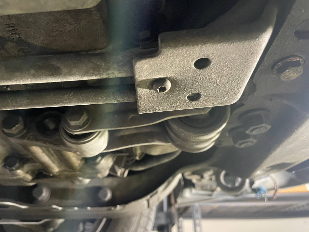

You guys down South suck. Ive never seen the clamp for the power steering lines with a torx screw that wasnt a hunk of rust. I dont even get the Torx set out, I just reach for the grinder
Load that hole up with grease, put a bolt in it, and drive it another 200k miles

I looked up the part number on the bolt and turns out its an M10 and so i ordered some M10 grade 8.8 zinc plated bolts from amazon they will be here in a few days-
yea as far as the clamp on the power steering lines i never really paid must attention to the bottom of the car most of the time when i was living on the west coast i had a shop perform all of the repairs its only now some years later that i have a house and a good size garage and i am fixing everything myself.

Ok this is fixed now i actually used a Depstech Borescope to look inside the bolt hole and the threads were clean. i think maybe the bolt fell out cause it might have come loose at one point.
I used a bolt that was about 1/4 inch longer and i was able to secure that bracket i tried using a longer bolt but it bottomed out in the housing so this other size was good enough now on to the next task.
