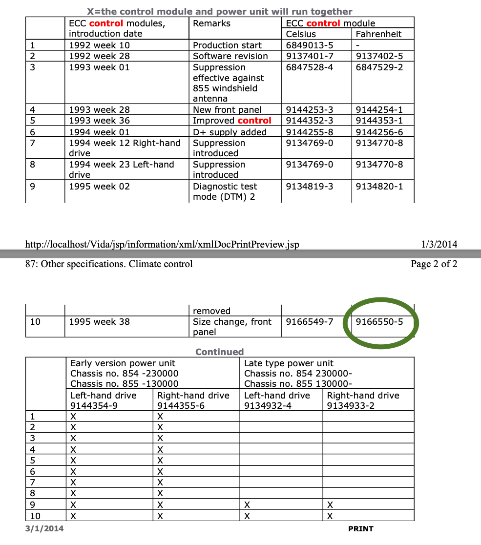

Post by jreed »
I would guess that the best bet is to replace with the identical part number. If you don't have the original, since your car is a 1996 it's a good bet that control module 9166550-5 is correct:

I checked and the sticker on it says 9166550 W627K. The unit did also come with its own harness plugs. I don’t think those would do anything switching them out. I did order this part off eBay from someone with good reviews. There are returns available as well. It says it was tested. Not sure what to do from there.
