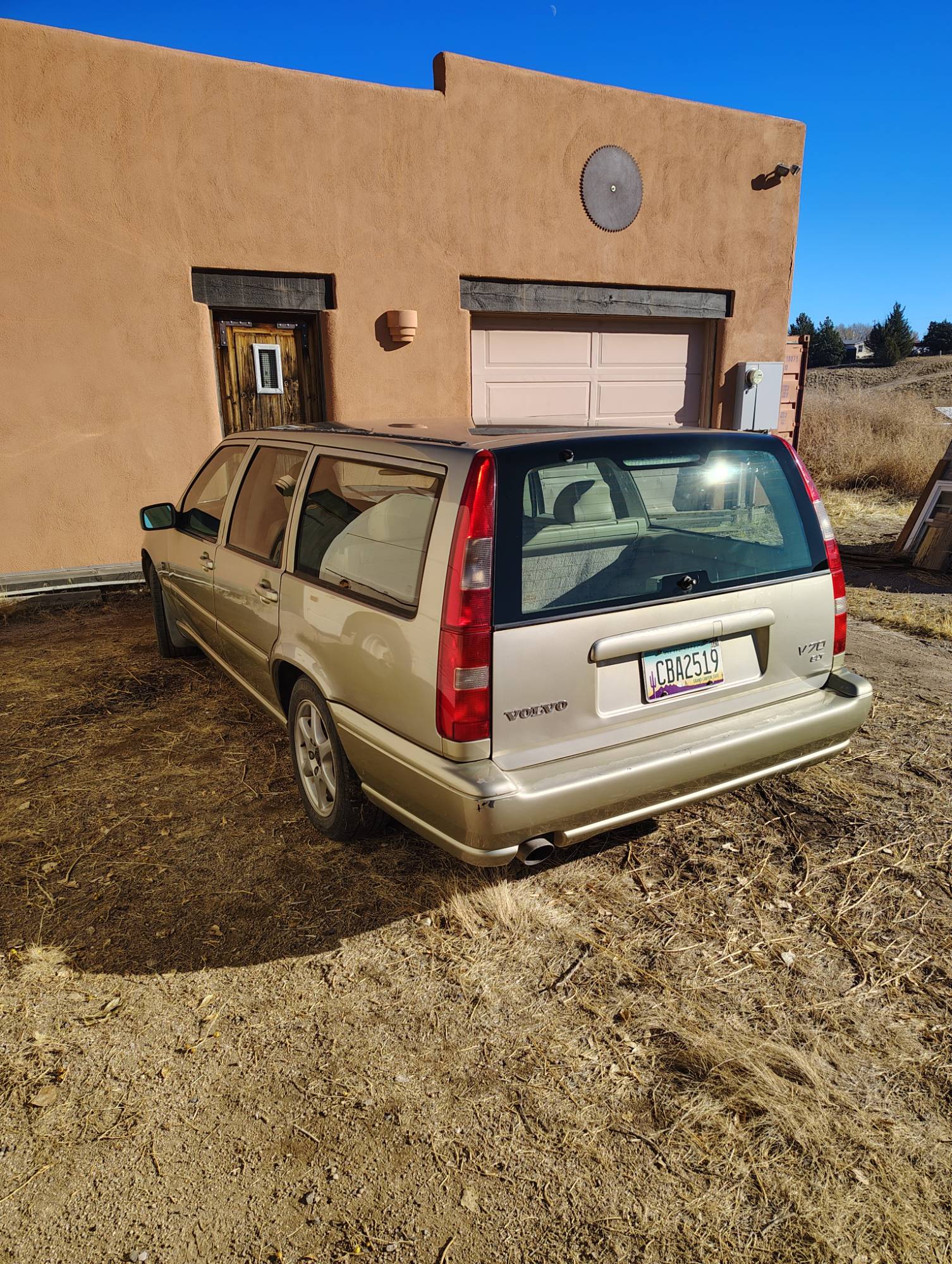

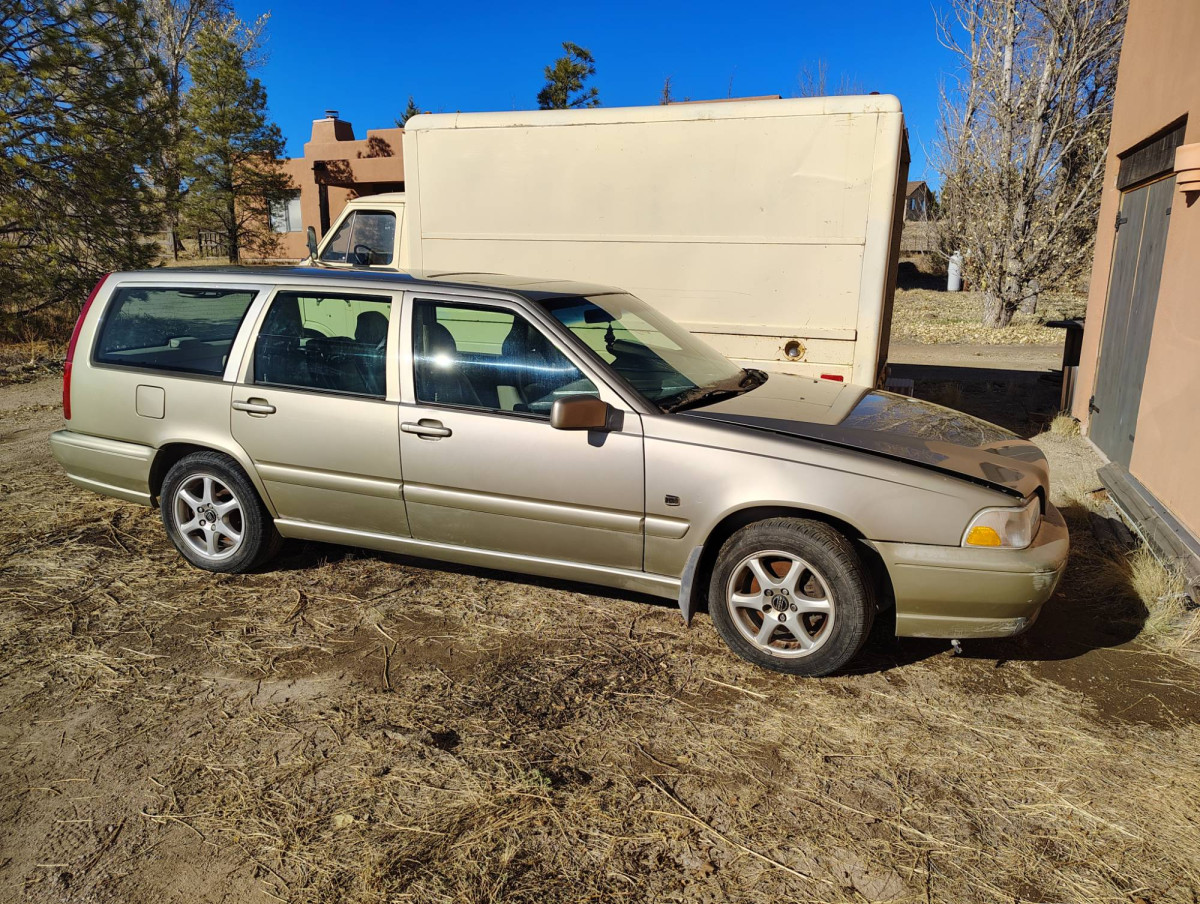

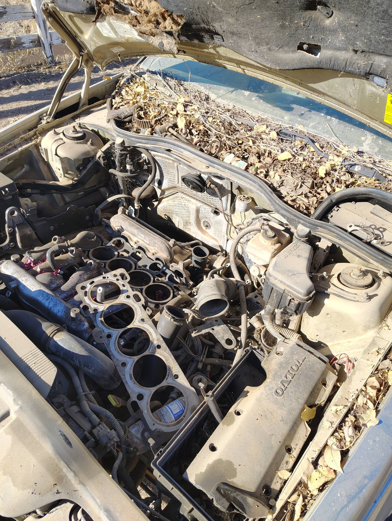

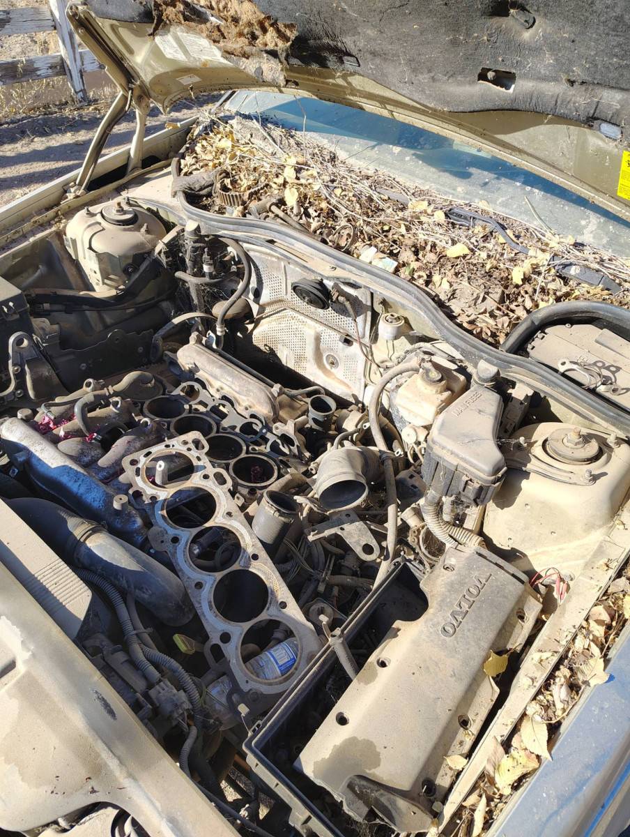

It started with me rescuing a '99 V70 that was headed to the scrap yard. 161k miles. Desert Wind paint. It had apparently been sitting for 4 years after being overheated and warping the head. The owner then proceeded to lose the head, as well as everything that had been removed to get the head off.
" $100 and it's yours. I'll even flatbed it to your house for $25." ( the family owns an equipment rental yard ). Now I had already called the local junkyard to find out what they would pay for it ( $225 ), so I bit the hook.
Got it home and started looking it over to determine if I should keep it, or send it off to Volvo Valhalla. Body not too bad, but the interior has seen better days. Top roof trim mostly gone, and both bumpers have taken some hits. But overall not too bad. I can't see scraping it.

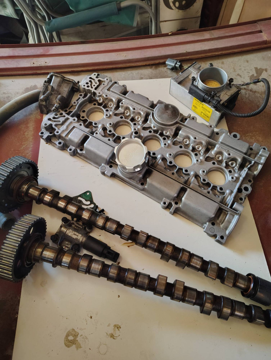

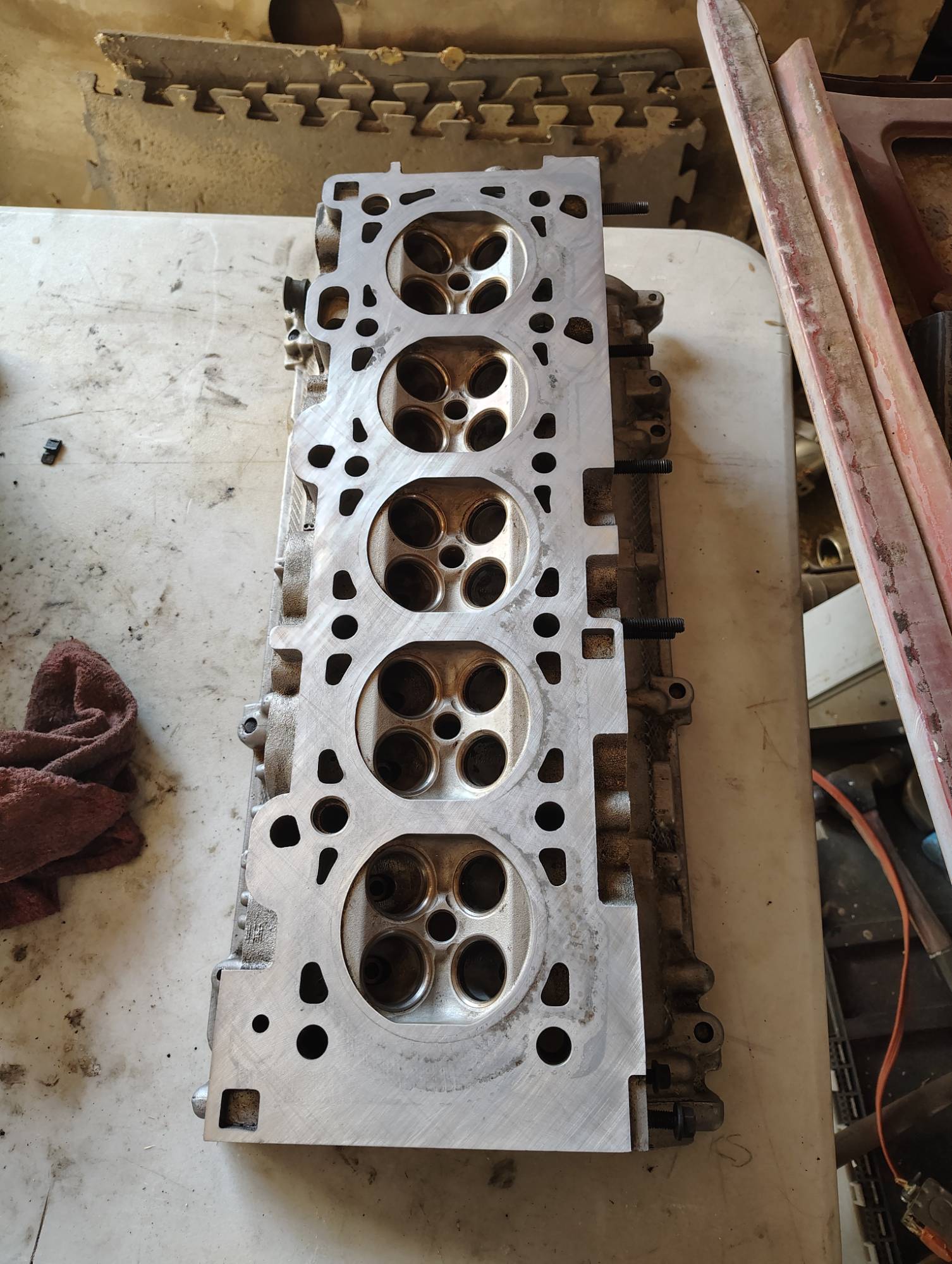

We decided on a " value engineered " rebuild for now, meaning as many junkyard parts as possible to just get it on the road. I found a cylinder head as well as most of the other missing engine parts online from a junkyard in Oregon. It even came with a IPD oil filler cap, which I had never seen ( and for $75 new, I can see why ). And then a '98 V70 showed up at my local yard. That car has so far provided a perfect set of roof trim strips, its near perfect interior, and almost new Sachs struts.

Complete with a yellow label ETM!

looks well worth saving. good luck for this project!

on a side note: that oil filler cap is amazing.

Yeah, I have to say it is a nice piece. I'd put it in the " For the Volvo guy who has everything " category.
I'll be interested in seeing if it has the same seal seepage issue that the stock caps have.

I’ve wondered if that alum cap is red hot when you go to add some oil on the road.

I can't imagine how a guy would lose a head, but some people are "amazing".
