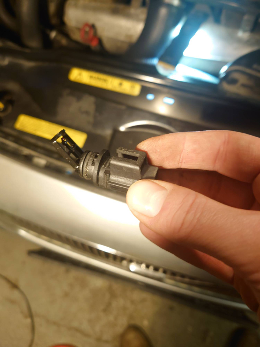

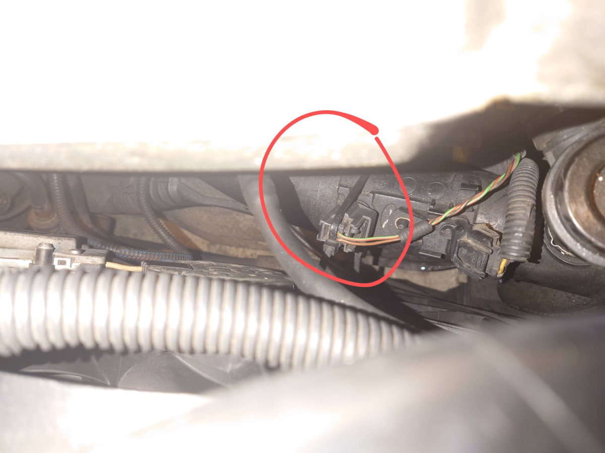

I see now that the intake air sensor is fastened by previous owner with a cable tie. The "clips" that should hold it in place I have to check if possibly there is an air leak there. But then there should be a problem all the time not only first minute..?

...and this is how it looks. Plastic broken, the small metal wires seem intact but with some dirt on them. It seemed secured air tight though
Found the sensor on the web : Air Charge Temperature Sensor - 9445153
I will order one of these anyway since it looks a bit unhealthy, but might this explain my problems..? I have not had any related fault codes (my scanner also presents Volvo specific codes)
