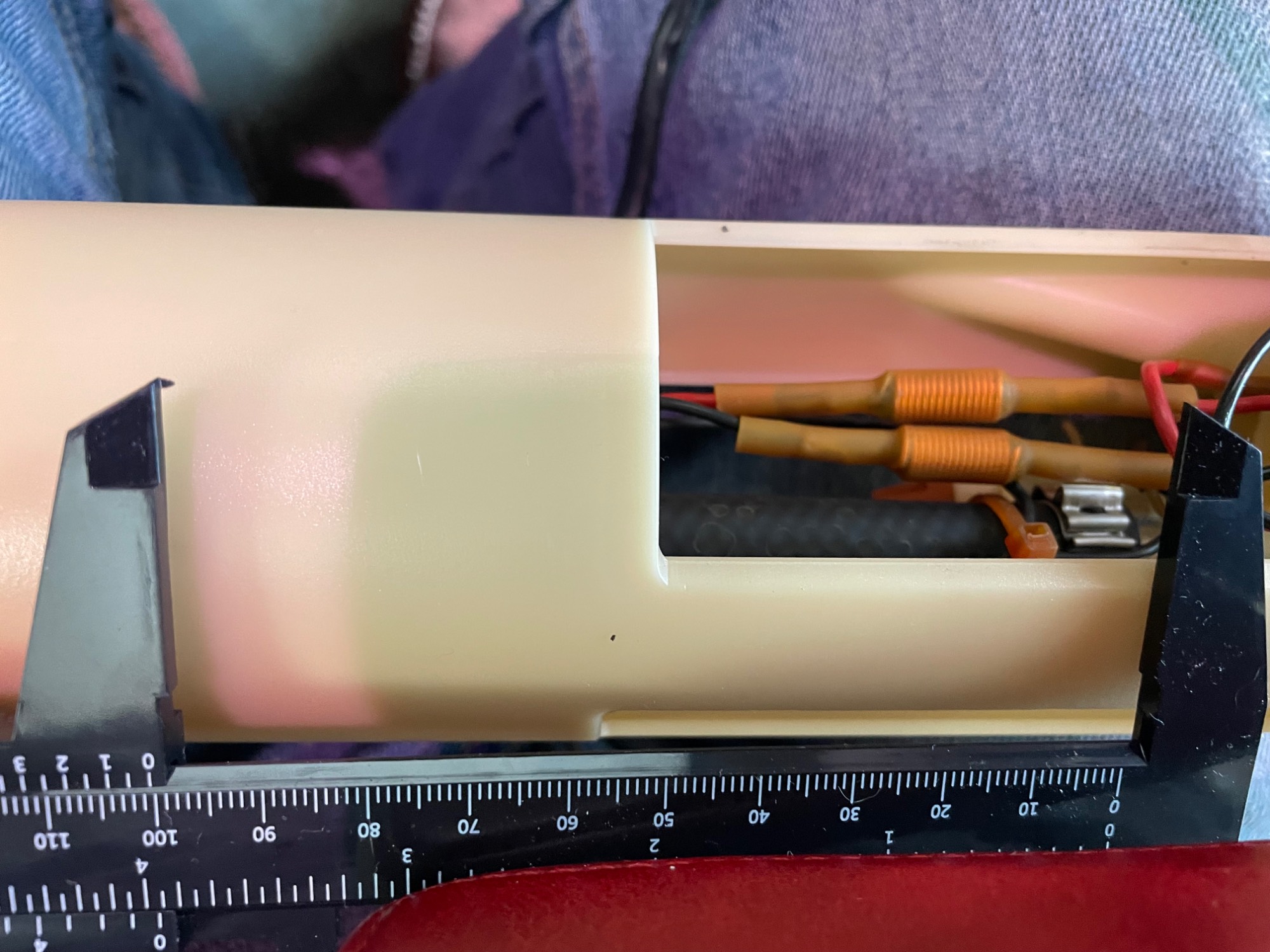

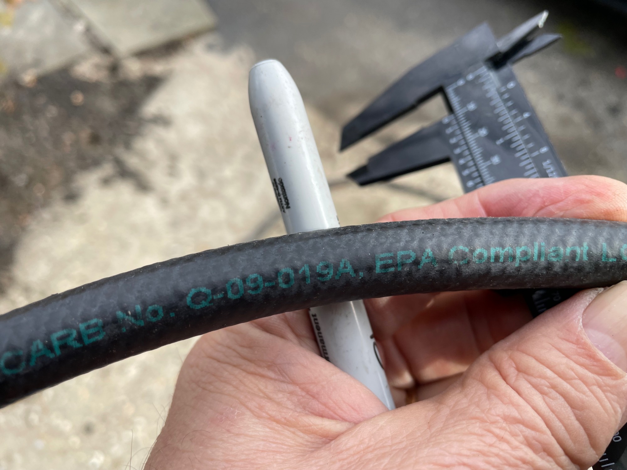

I have a pump out so I’ll try take a picture or two today with numbers on that hose. You can also reuse it with good clamps, oetiker are best

I've replaced that hose a couple times on P80 cars like yours. You can use generic, submersible fuel line hose, 5/16 ID. You need about 4 inches for one fuel pump but don't take my word for it, measure it as you don't want to be short. Be sure it is clamped well, I have also had this hose come unclamped before.
I used Gates 27093 and it was not cheap. Currently Amazon shows it for $40/foot (!!), but on eBay it's $12/foot (but is it real or is it counterfeit?). I bought a one foot length in 2017 and it has fixed two fuel pumps so far, I know there is one piece left but not sure if it's long enough to do another pump.

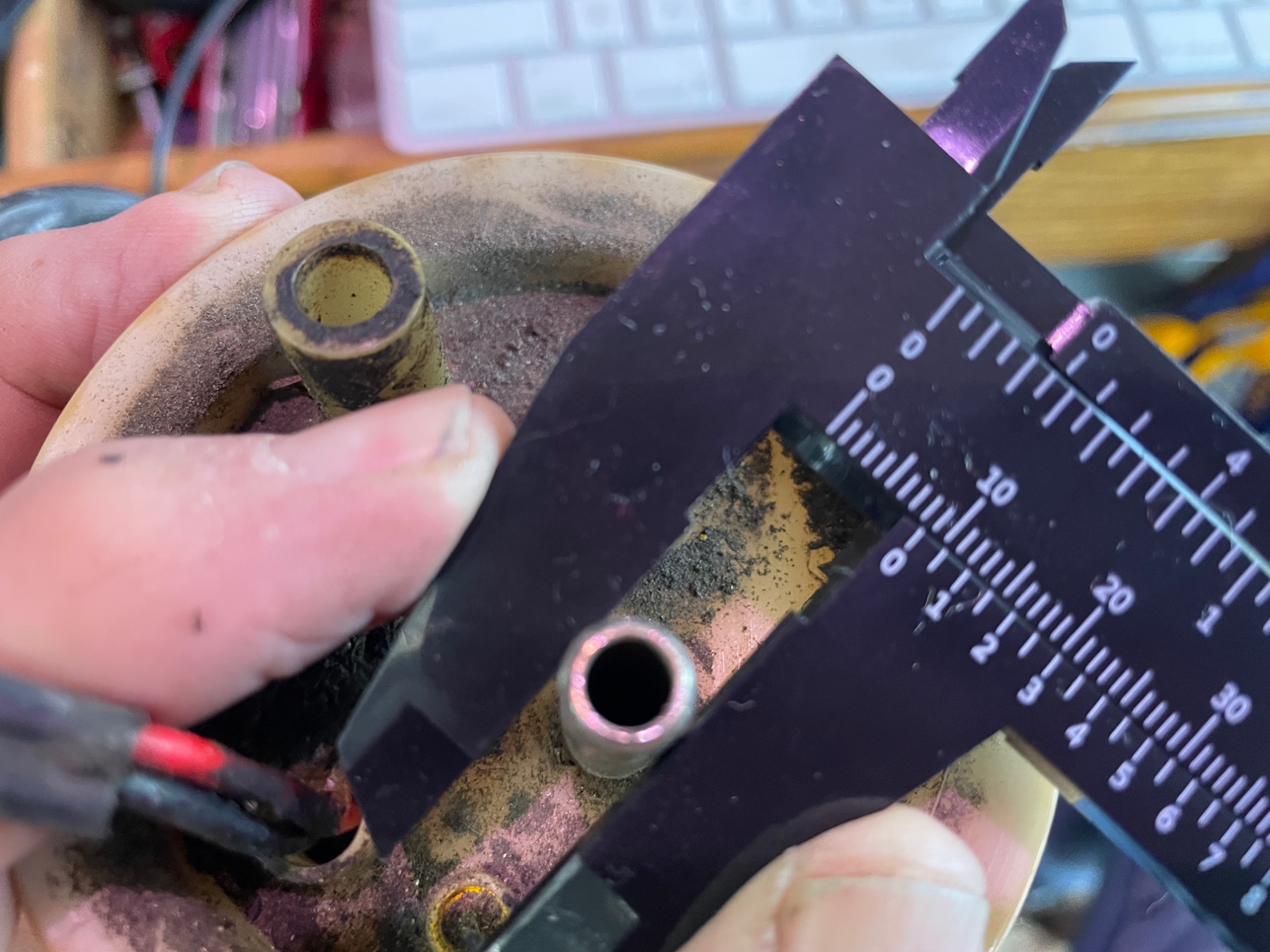

100mm long , barb is 8 mm
I used Gates barricade
About $4/foot in 2025 USD

I've also used Gates 27093 after issues with some aftermarket hoses (that came with expensive known brand aftermarket pumps...) and no issues, apart from being expensive !
