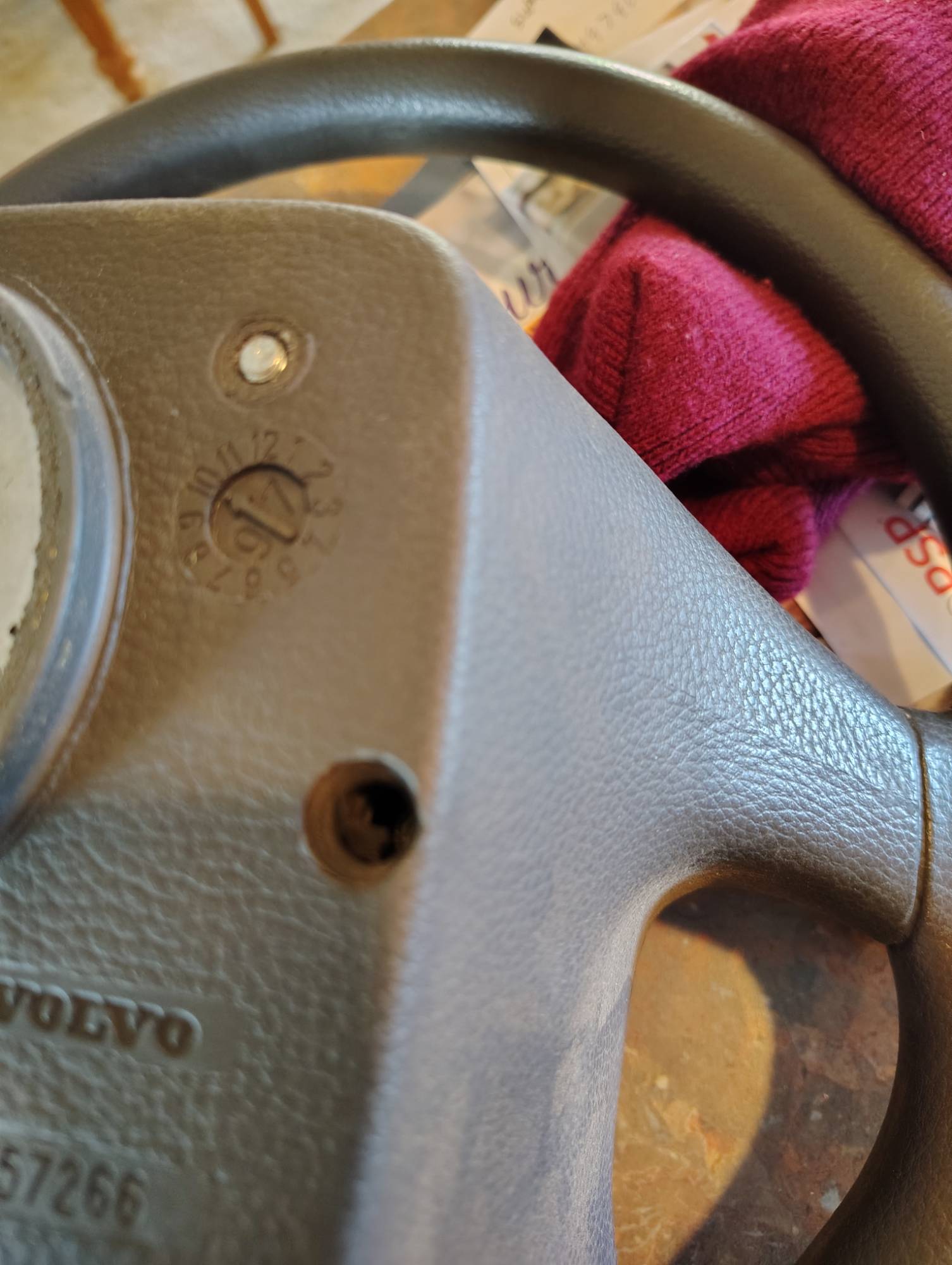

I am replacing the steering wheel on my 1999 S70. One of the torx bolts holding the airbag is stripped from the PO. Since I am coming into it from behind the wheel, I cant really drill. Any suggestions on a good way to get this out?

the head is stripped. there is no way to get sideways. the bolt is down in a hole and requires an extended bit to reach it. the bolt body is fine...just the torx part is stripped

Since im replacing the steering wheel. I could cut away the plastic shell and try to cut off the bolt head then reomve the bolt body from the airbag assembly.
hoping there is a better method to avoid that

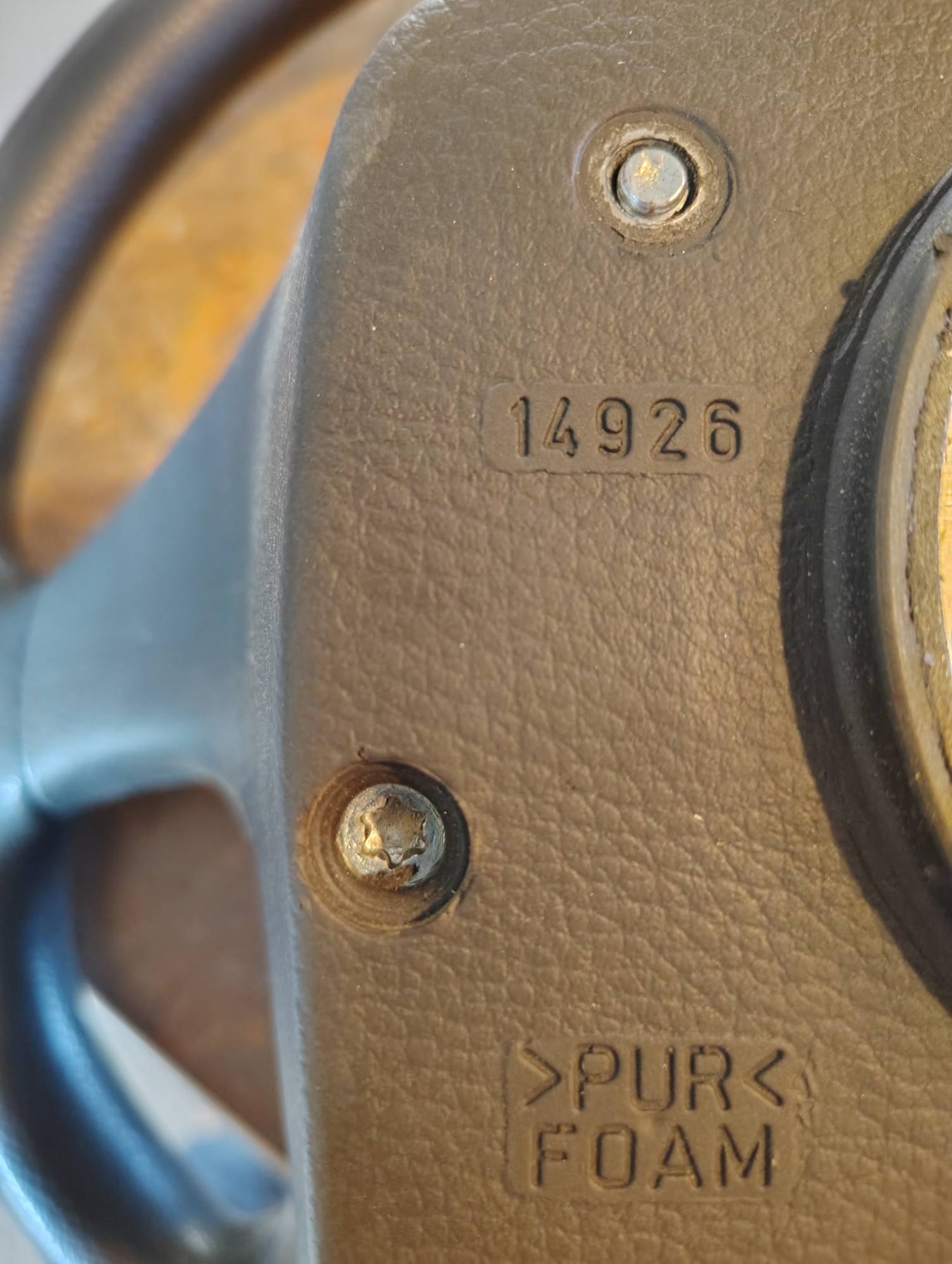

I happen to have a wheel off, so here are a couple of pics. The screw does have a beefy head, but a shallow inset. It's recessed about 1".
You could try a bolt/screw extractor with a stubby head. Otherwise it might be grinder time.

I think you could cut a notch on the side of the steering wheel and gain enough access to grab the head of the screw.

Sveedy - we had the same thought - the other day I removed the material from the side of the steering wheel to find that there is a cylindrical steel shaft the screw goes into so zero access from the side.
volvolugnut - i am considering that. I do have a right angle drill attachment - i may use a drill bit slightly smalled than the inside diameter of the shaft and drill the head off the bolt - then I can try to remove the threads on the bench
thanks for the ideas
