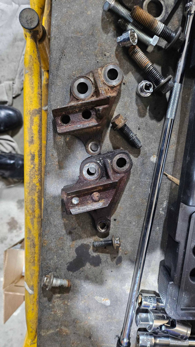

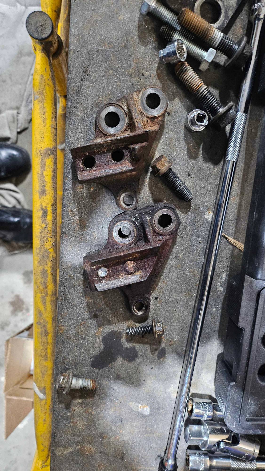

found a replacement part at my local volvo garage and managed to get that third, smaller bolt off too. these two brackets are definitely different, but the two bolt holes that screw in from the subframe mount are spaced the same, so this will work as a replacement. both are OEM Volvo parts, but I can't seem to find
notably, there is a tab on one of them to align with the subframe mount, which is not a big deal. The third, smaller hole does not line up correctly due to the angle of the two bigger holes, as well as the hole being a little closer to the center holes than the other.

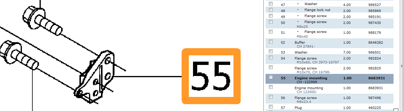

did some more VIDA digging, and there are designations that there are two different parts according to chassis number- my replacement seems to be from the "CH 0-122999" range; since my chassis # is 282859, mine must be from the "CH 123000-" revision.
to my dismay, both of these reference the same volvo part #8683931, so that isn't much help.
