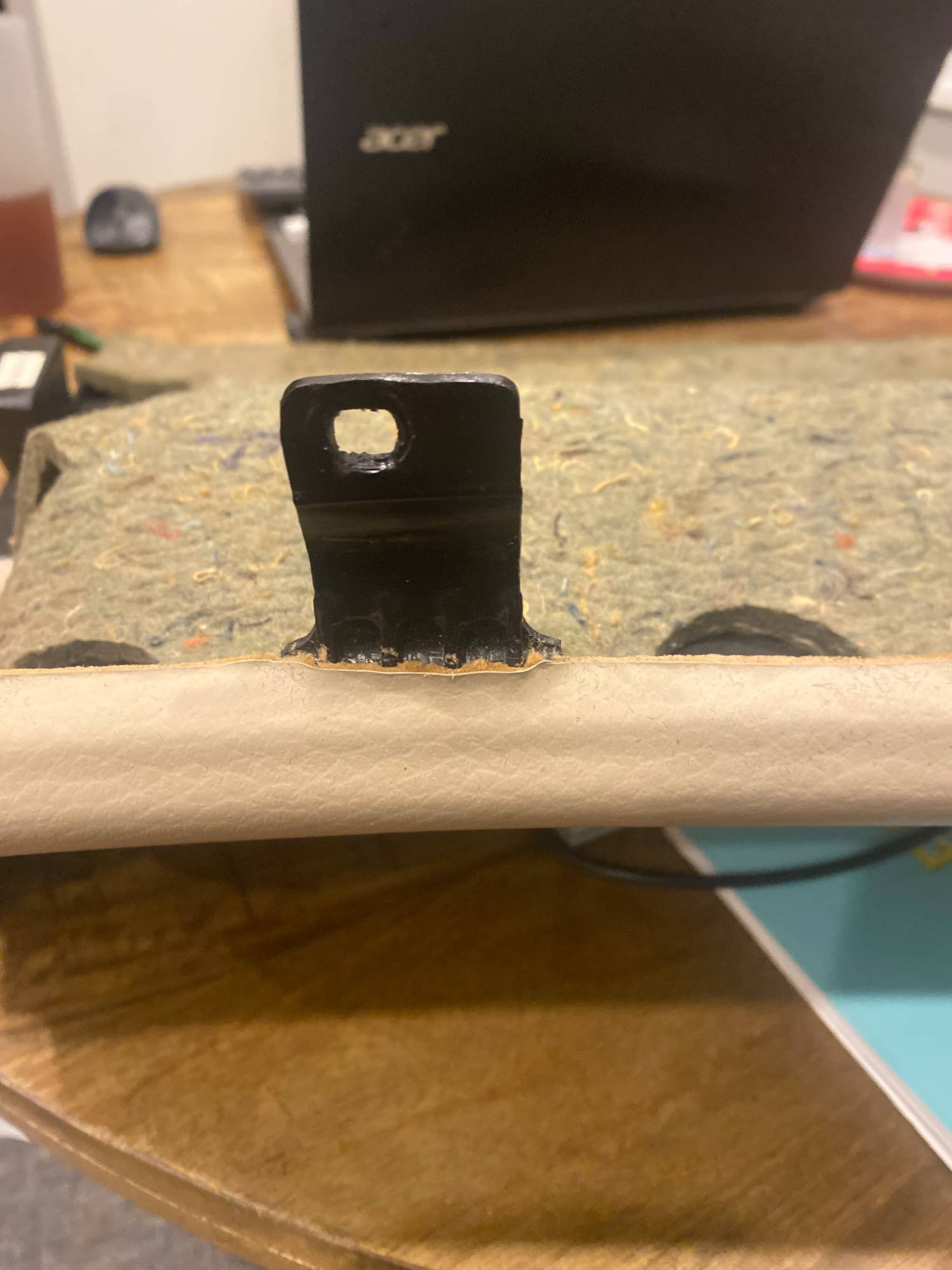

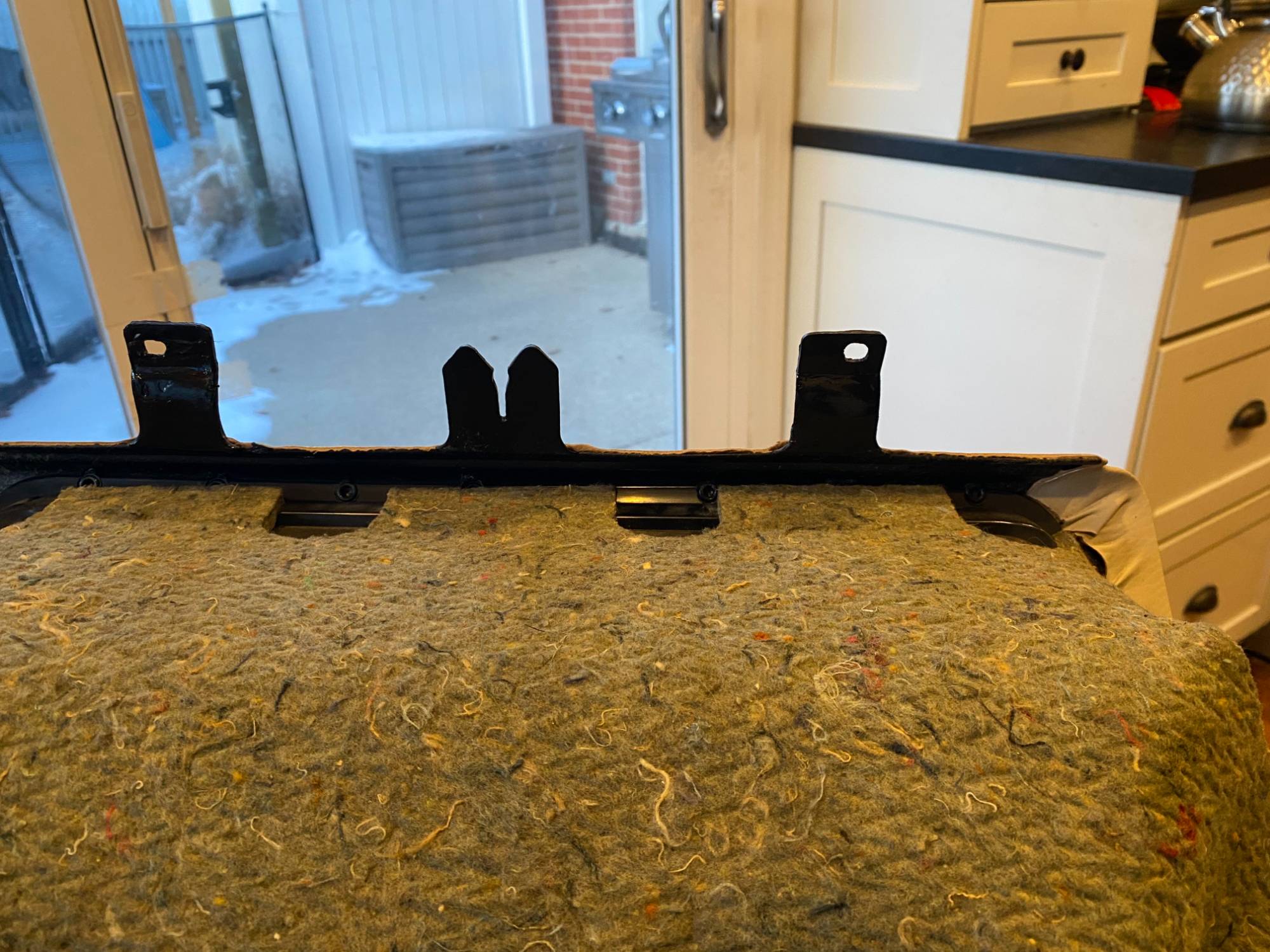

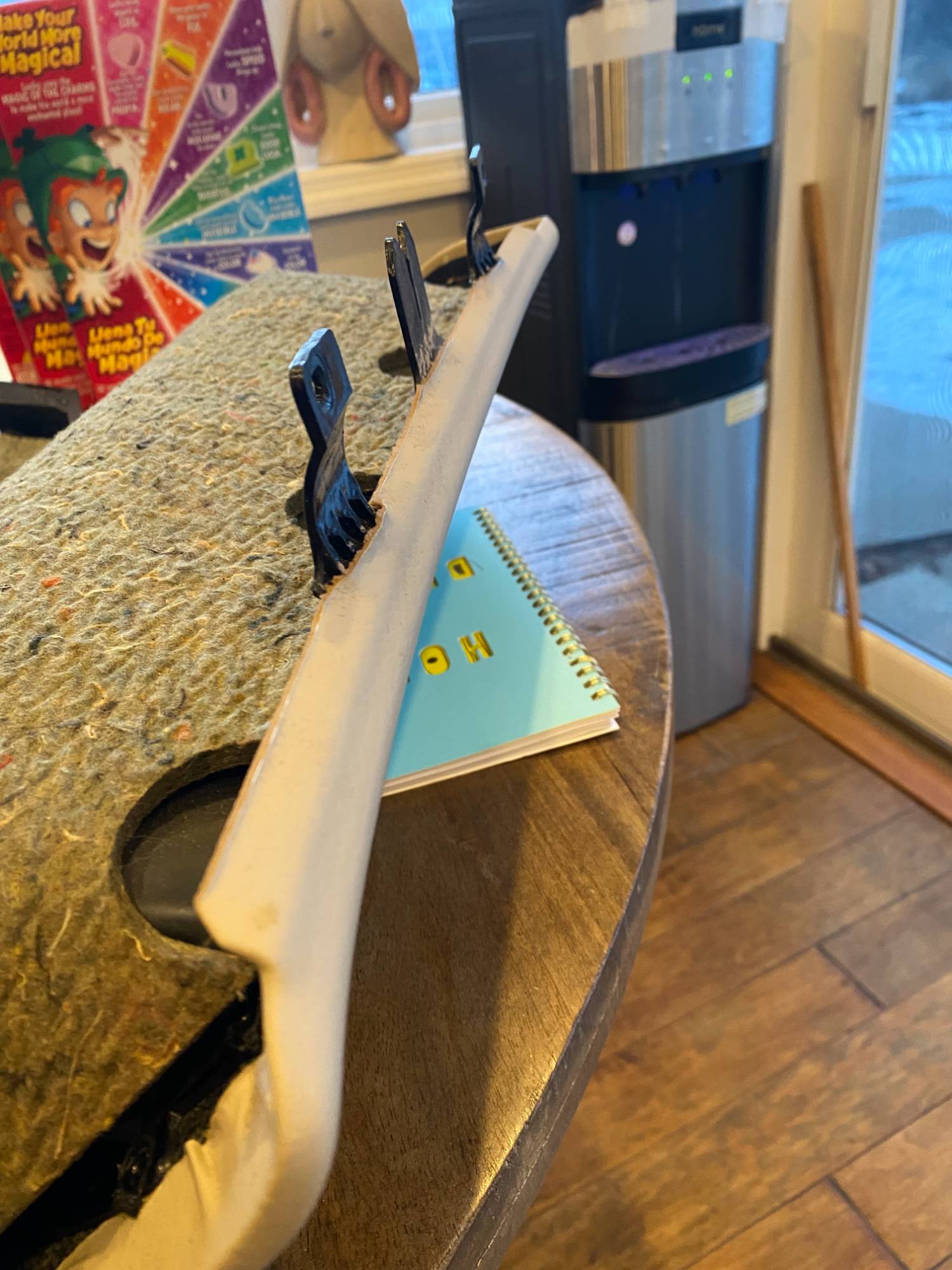

My example here is the open storage area under my glovebox. It is held by 2 braces underneath and 2 tabs above that are held by T25 screws. these tabs slide up under the glove box insert and secured. both my tabs were completely broken off and as such there was a noticeable sag in it. I took it apart last night and took it inside. I used ABS pipe cement. For those unaware ABS pipe cement is simply ABS plastic dissolved in MEK (methyl ethyl ketone). When you brush it on something the MEK evaporates and the ABS solidifies. additionally if you are gluing parts back together it sort of acts like a weld. I used a little bit on the 2 surfaces i was putting back together. Held them in place for 30 seconds and them left them for 30 minutes. afterwards I painted more on each side to beef it up a little. the result was a very strong bond like the break never happened. I do not have before pics. I apologize but here is the final result. the product can be found at any big box store or hardware store and typically says medium black ABS cement.

How strong is this compared to the original thing? These kinds of plastic pieces must endure a lot of force, especially the pulling one.
There's two forces that will act on this thing, tensile and shear. The original plastic(when new) can withstand both since it is more pliable and the bonds are strong since the structure is still locked together.

im my opinion it is at least equal to the original if not better. I also believe adding a thin layer to each side beyond the crack, added strength in this case which leads me to believe it may be stronger than original.
