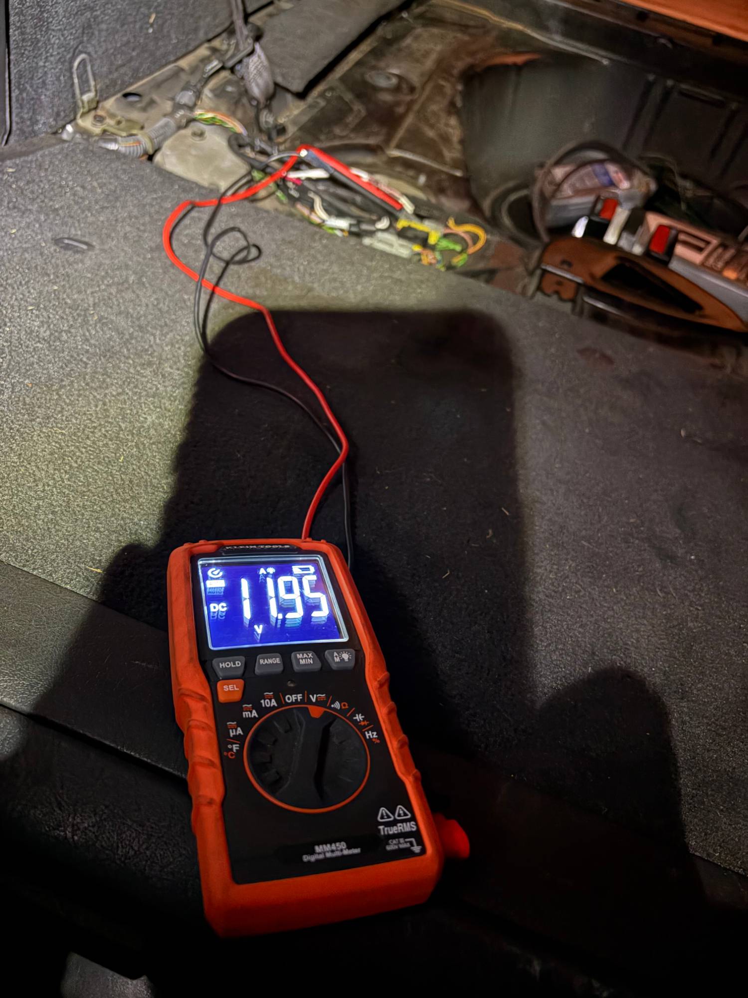

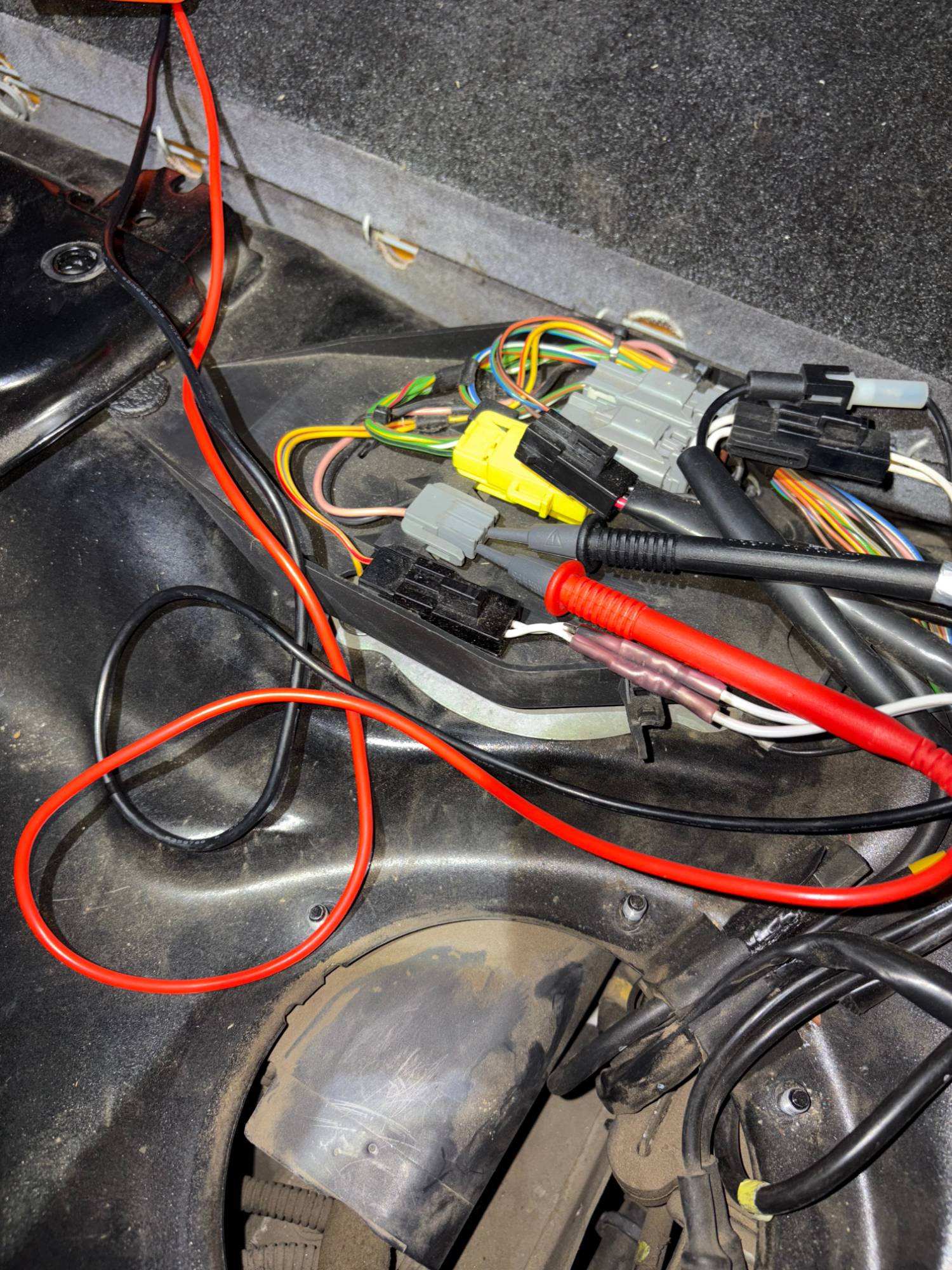

The battery was dead after starting the car so many times, I had it evaluated and charged at Autozone. Passed there, came back charged to 12.59v. After plugging the battery and jumper wire back in, I connected my fuel pressure gauge to the rail, and cycled the key to position II a couple of times. 0 pressure at the rail. I checked continuity to the fuel pump harness near the rear seats with key in position II. Pump is getting 11.95v: Additionally, after cycling the key about 10 times, the battery is down to 12.4v, is it normal to lose capacity so quickly?

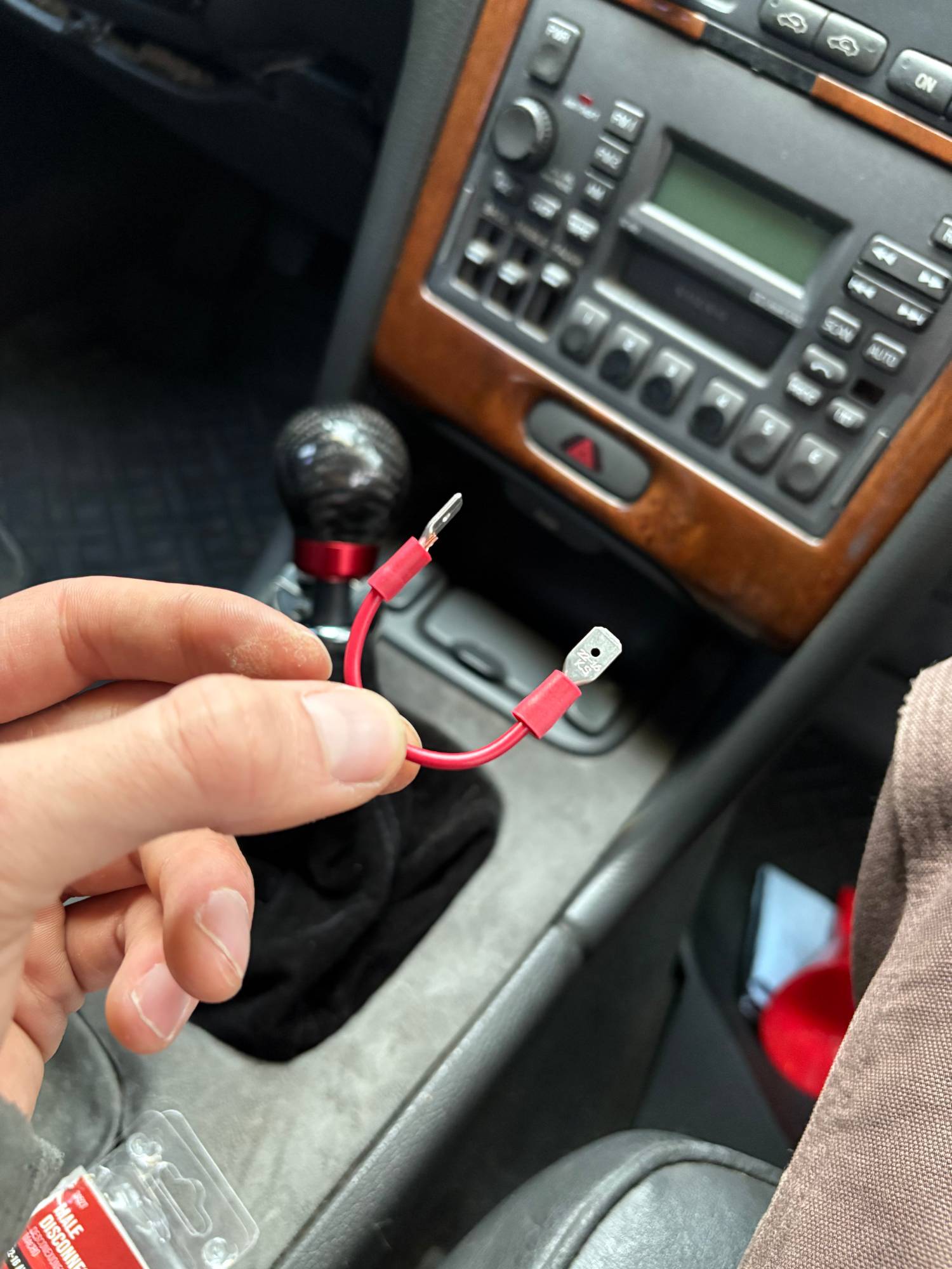

At this point I am suspecting a failed fuel pump. I cannot hear the pump running at all, and as I stated there is no pressure. Could there be something else preventing my pump from turning on?
My procedure to test continuity to the fuel pump followed this article: viewtopic.php?t=52252 by @cn90 , and the end of this article on pelican parts: https://www.pelicanparts.com/techarticl ... esting.htm

I don't believe that 12.5 volts is enough. You should be seeing 13.8 - 14.2 or so before you hit the key.
I'd start with a different battery.
