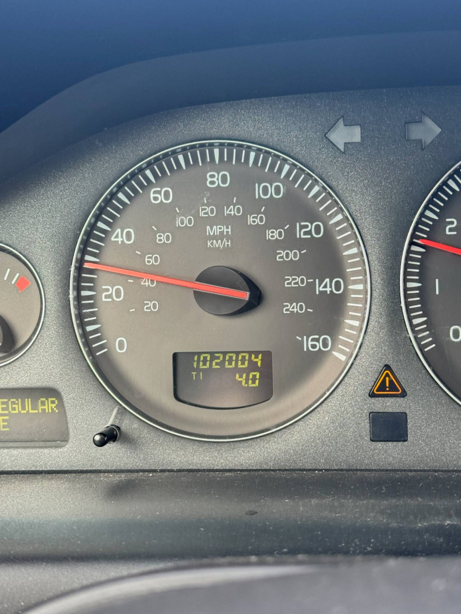

Sorry it is slightly confusing. In the center of the console you will usually see yellow triangle and message to the left "engine service..." (will include example of 05xc) I never tried to check the codes via pressing the combination that you suggested since have Vida/dice clone. If to assume that you were referring to the triangle symbol and the car is running great, I would try to see if the cruise control is turning on. If not-most likely it is brake pedal position sensor. However the problem can even be from incorrectly reinstalling radio(meaning starting the car with radio detached...that's how I bought vida). Any chance you can post a photo or video of it and maybe numbers of the codes?
