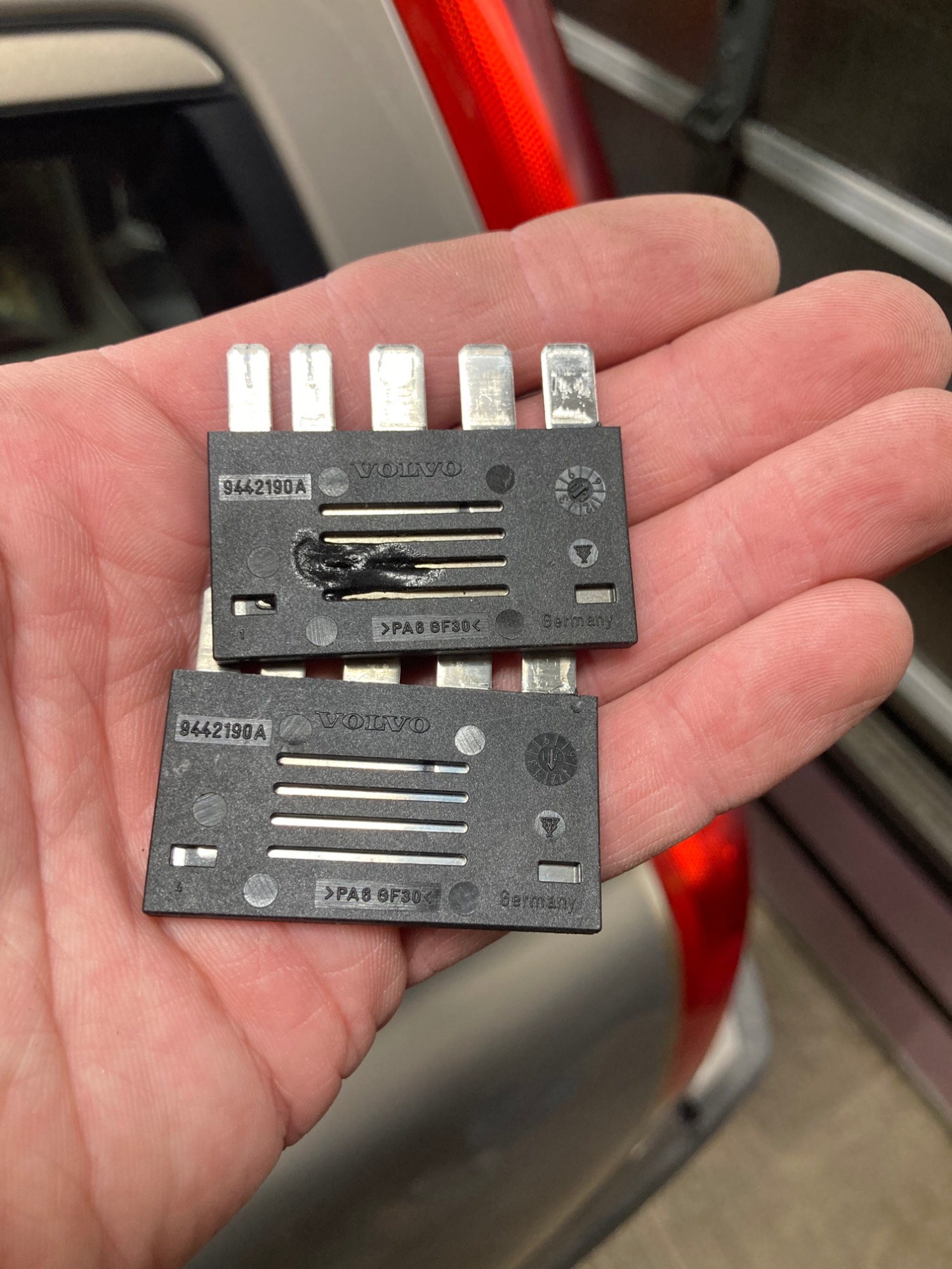

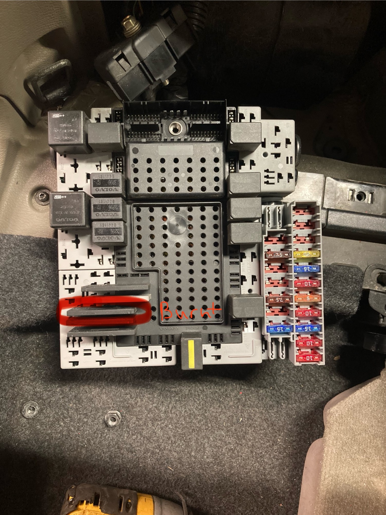

Burnt REM shunt (see photo)

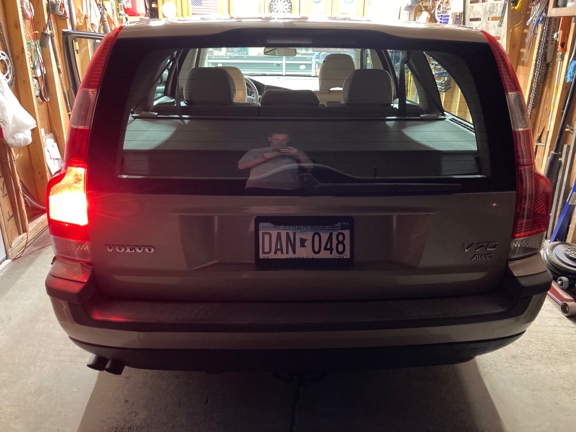

Brake lights/Position lights come on and stay on 15 seconds after (& with) ignition off
3rd brake light flickers with ignition off, shuts off if you open the hatch

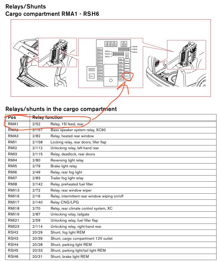

Brake lights come on if I pull relay RMA1 (2/52, 15i feed, rear)
3rd brake light works but only with ignition OFF & only after 15 seconds after switching ignition off. 3rd brake light doesn’t work with ignition on, but begins to work only after 15 seconds after switching ignition off.

Swapped REM with same model year car - no change. In fact, the REM out of the car in question worked perfectly in the other car I swapped it into. The REM swapped into the car this post is anout made no change at all.

As you are aware after wrenching on several Volvos for a long time, cars produced for worldwide consumption get weird features. In Germany there is a requirement for a left rear fog lamp. The bright light that is on in your picture is the rear fog lamp (I had to check on my XC70 to verify it is that particular bulb). There is a button on the bottom row of the headlight module for turning it on and off.
I lived in Germany for a few months and I would see cars parked on the street with their ass sticking out a bit and that light was left on. There is a trick on some EU cars for being able to turn the car off and having that bulb stay on so the rear corner of the car doesn't get hit. Try unplugging the headlight module and see if the light stays illuminated.

Yes sir, of this I am aware. It wasn’t the photo I had wanted to share - I thought I had a photo of the car with just the position lights illuminated & ignition off. My wits are becoming fragile evidently.DavidE7 wrote: 30 Mar 2025, 18:39 As you are aware after wrenching on several Volvos for a long time…. The bright light that is on in your picture is the rear fog lamp (I had to check on my XC70 to verify it is that particular bulb). There is a button on the bottom row of the headlight module for turning it on and off.
The rear fog light functions as it should. The position/brake lights are the only ones I haven’t successfully been able to troubleshoot. Some of the other groups I posted this in are suggesting the wiring is the most likely culprit since I’ve comprehensively evaluated component integrity (fuses, REM, relays, shunts, bulbs…)

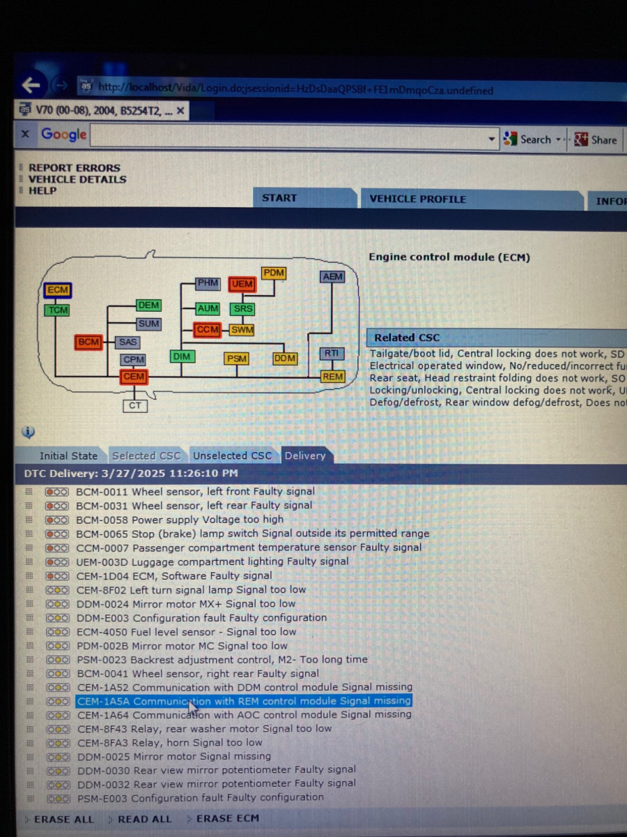

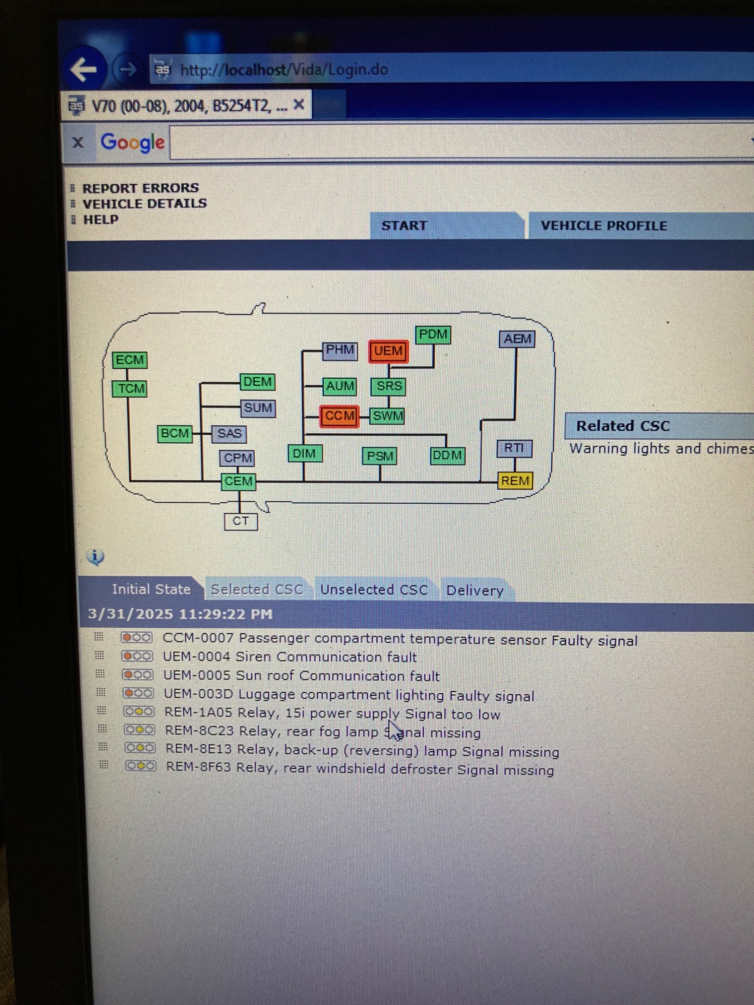

With Vida erase all the codes. Try to do 2-3 start/stop cycles without pressing the brake pedal. Recheck of you have any codes. If no codes I would interpret it as a good sign(self test is good). If code is immimediatly present(hard code, system self diagnostic recognizes issue on start cycle) I would check power and ground to the REM with load light of 2amp. If those check good and we know the rem from the car works great in the test car- issue is likely in Can twisted wire pair. Maybe some body metal pinched it, or not careful body work cut,repair.

I try to save the original list of codes for reference before erasing so I know if the code is a repeat. That is a long code list! There is a tab where you can print the codes and I select print to PDF to save them.
I had problems with the CEM module and the right turn signal not flashing and not turning off. It turned out to be a fried TOPFET on the CEM PCB. There are also TOPFETs in the REM for controlling lights. Search for TOPFET. The TOPFETs can be replaced for much less money than sending in the REM for replacement with software transfer.

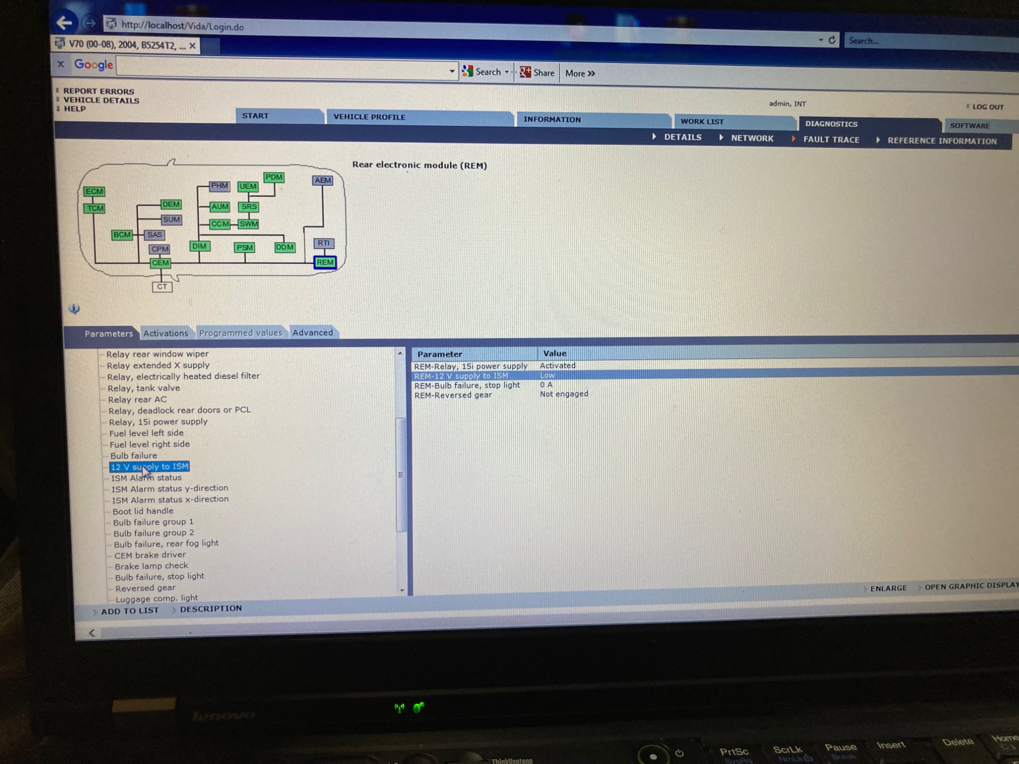

Vova585 wrote: 30 Mar 2025, 23:20 With Vida erase all the codes. Try to do 2-3 start/stop cycles without pressing the brake pedal. Recheck of you have any codes. If no codes I would interpret it as a good sign(self test is good). If code is immimediatly present(hard code, system self diagnostic recognizes issue on start cycle) I would check power and ground to the REM with load light of 2amp. If those check good and we know the rem from the car works great in the test car- issue is likely in Can twisted wire pair. Maybe some body metal pinched it, or not careful body work cut,repair.
Apologies for not responding sooner. Here is what I show on ViDA this evening. I don’t recall seeing the REM-1A05 code before. When I look that up it tells me the supply voltage relay (RMA1 in REM, 2/52, 15i rear feed) has signal missing or signal low, check for short circuit…
I have yet to find a wire or connection that makes me cringe. Of course, in the headlight & tail light housings that were smashed there were mangled contacts. Yet the car-side wiring (and connectors!) all appears to be unharmed.
So thinking that this relay might be fried I pulled it & the brake lights come on immediately after removing it. Obviously this is without pushing the brake pedal. I swapped it with a known hood relay & no change in behavior.

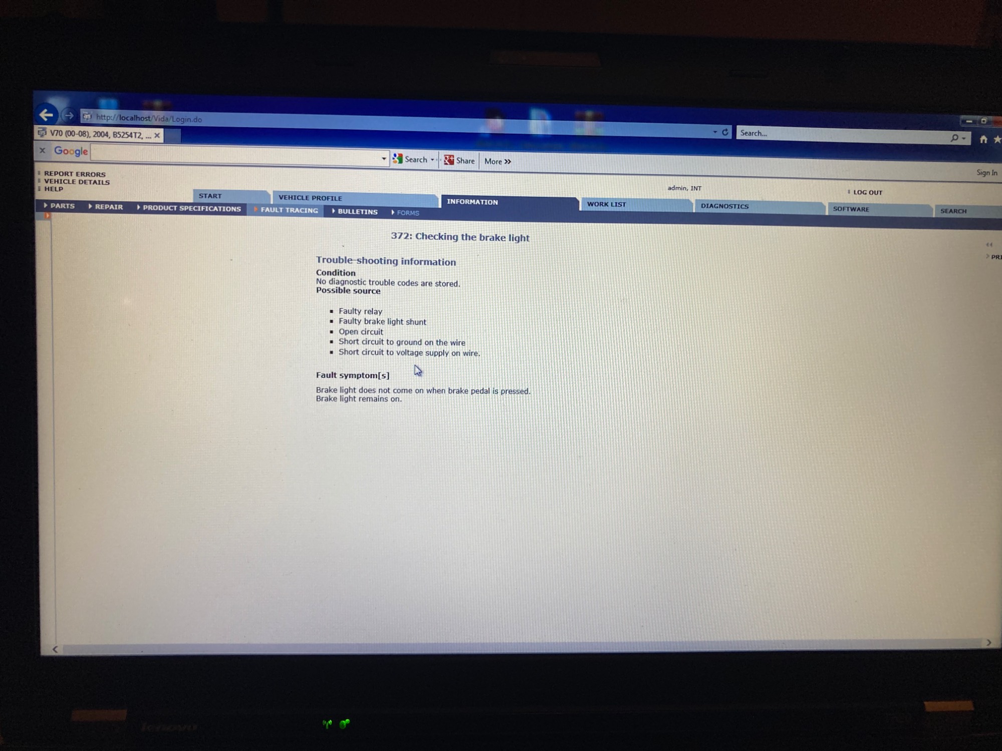

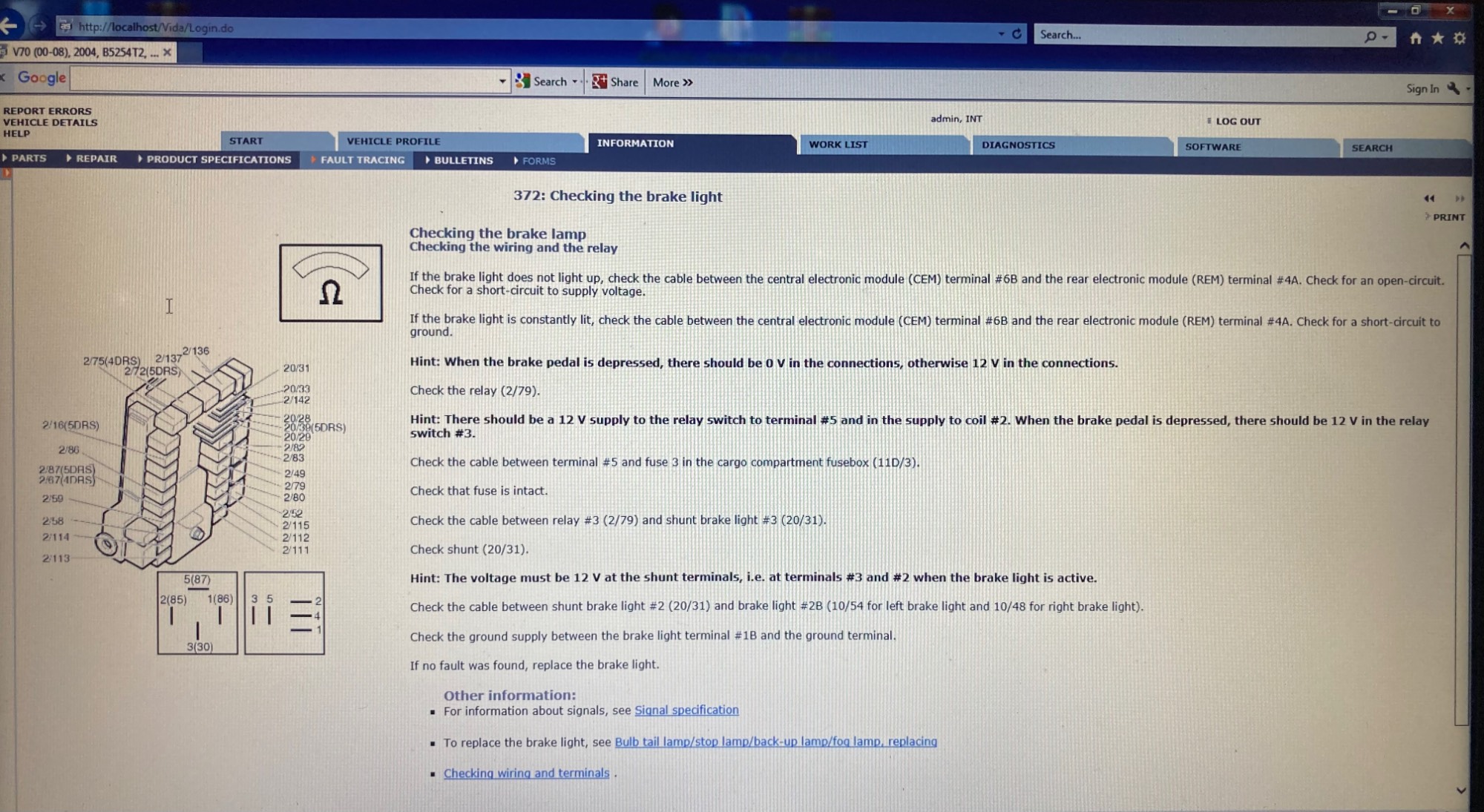

You know, after swapping the REM’s between 2 of my like year P2’s and seeing no change (in either car), I am less than convinced the REM is to blame. That being said, I know for a fact that my P2 knowledge is far from limitless and can conclude that I am also less than convinced that I am correct in my assertion just prior to this sentence. One thing is for sure - something is afoot, amiss … awry ...Vova585 wrote: 01 Apr 2025, 21:04 I feel sorry for you on this one. Pass of least resistance if money is not a prohibiting factor- send Rem to xemodex and let them verify it is all ok. If such is not an option, try to locate wiring diagram to the REM. Let's focus on that relay and see where it brings 12v. Knowing which fuse it feeds from(for example 5amp) we can substitute load with 55w bulb and see if it is able to make ot shine bright, if not- maybe fuse contact or fuse itself are faulty. If nothing like that would be discovered, I would try to cut the wire and supply 12v through the fuse to the power side and see if anything will change. Another wild option if DavidE7 can look at your REM and see if he can fix it for a fee(much respect to him for being able to fix his unit with all involved soldering)
I came across this this evening in ViDA. Seems like a good place for me to spend some time. I will post my findings. Thank you for putting up with me.
