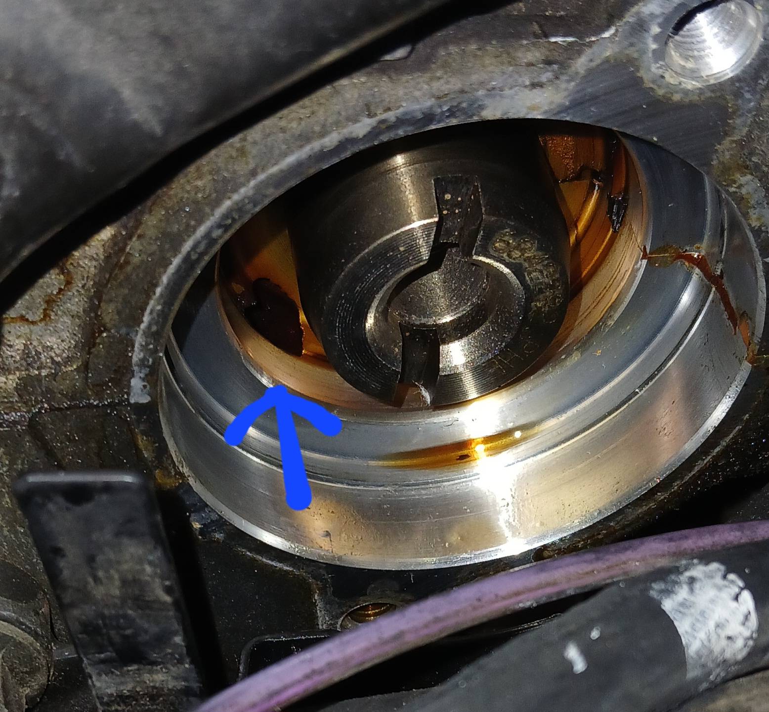

1998 rear cam exhaust has hole behind seal area

Is this normal?

That's normal.
EDIT: this thread shows a pic of the same hole behind the cam seal in one of my cars
viewtopic.php?t=65764

It is an oil return drain behind the seal. I thought you were pointing to the small chip out of the edge of the seal area.

Just my poor phone markup skills!
I see that chip now though.
