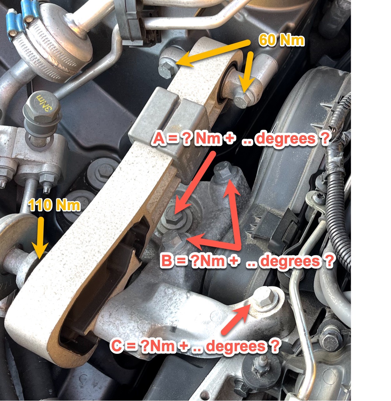

Removing the engine support/mount is no problem, with a jack underneath the oilpan to hold it.
However, I am still looking for the torque values of the bolts in the photo. If I'm correct, the torque values of the yellow colored bolts are as described in the picture and do not require any additional angle of fastening.
Can somebody help me please with the torque values and angles (if applicable) of the bolts with the red arrows?
Some of the bolts need to be replaced (get extra tension) any part numbers would also be appreciated.
