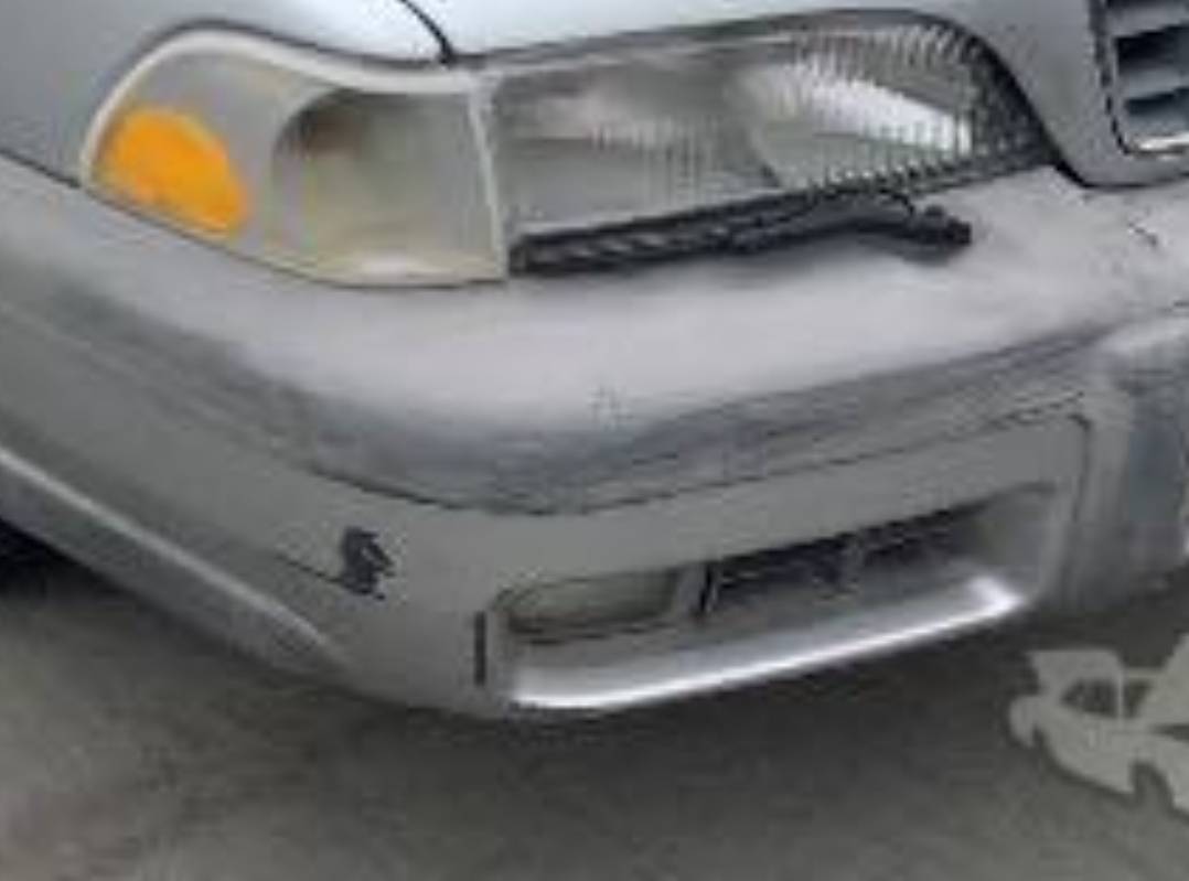

The Grey 104/108 relay does have an extra connector than stock green one. I pulled another J relay, from under dash, but don't know if its different. There is a plug behind the panel next to rear fog light switch, Plugs for fog lights are near front valance. You need special trim like the one I found in photo and of course fog lights!

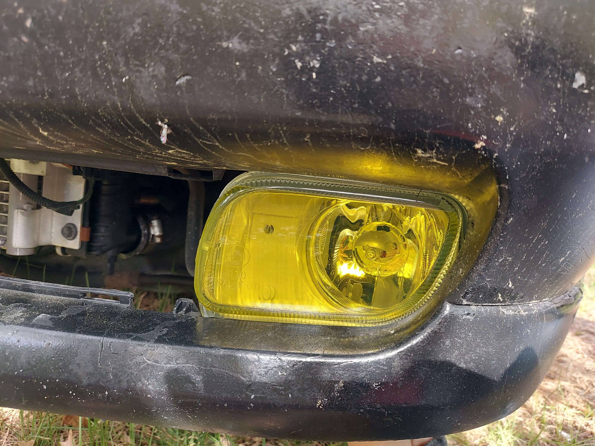

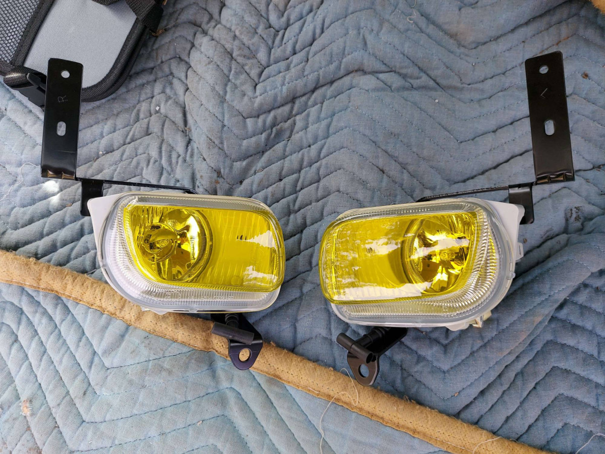

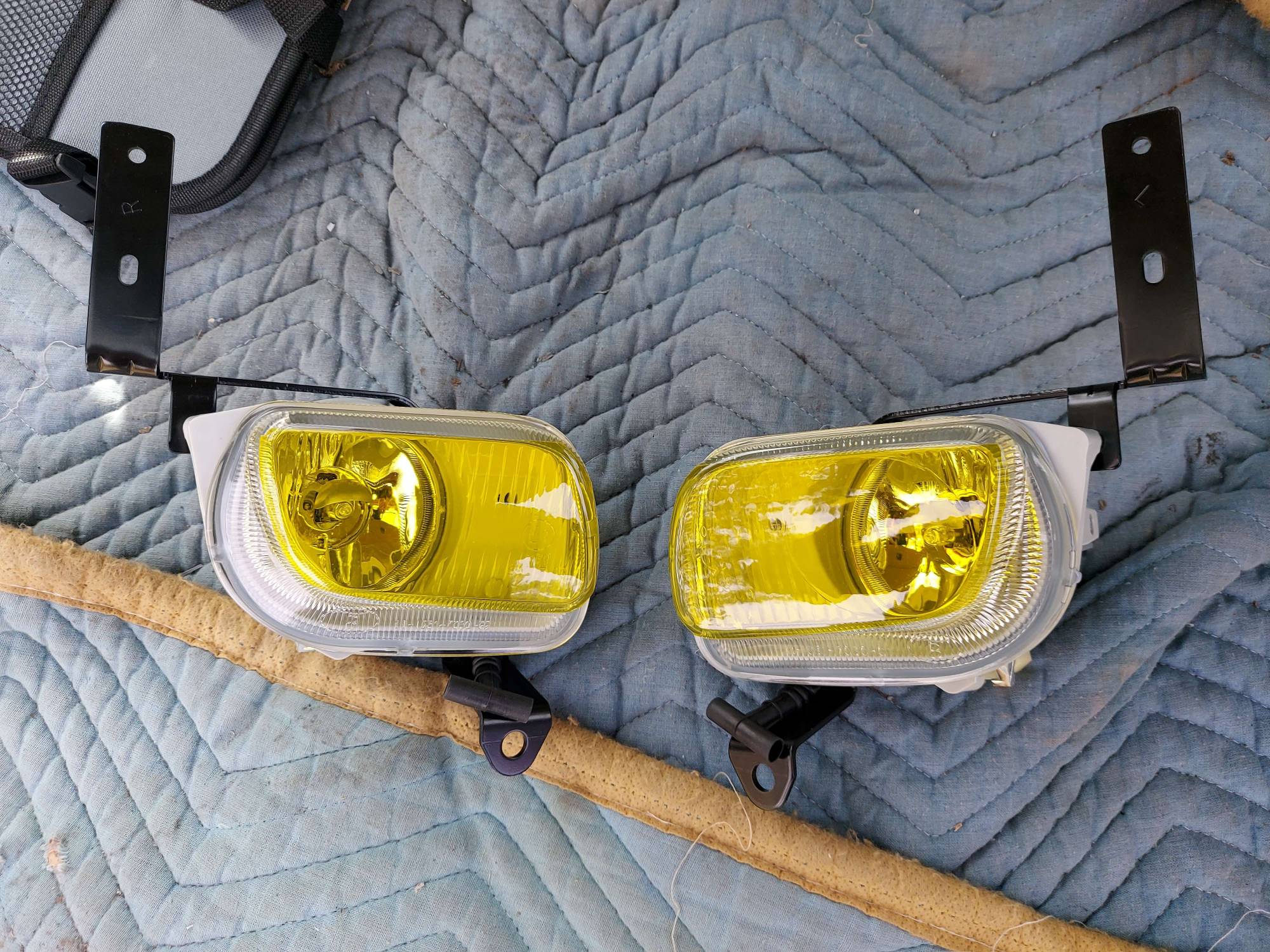

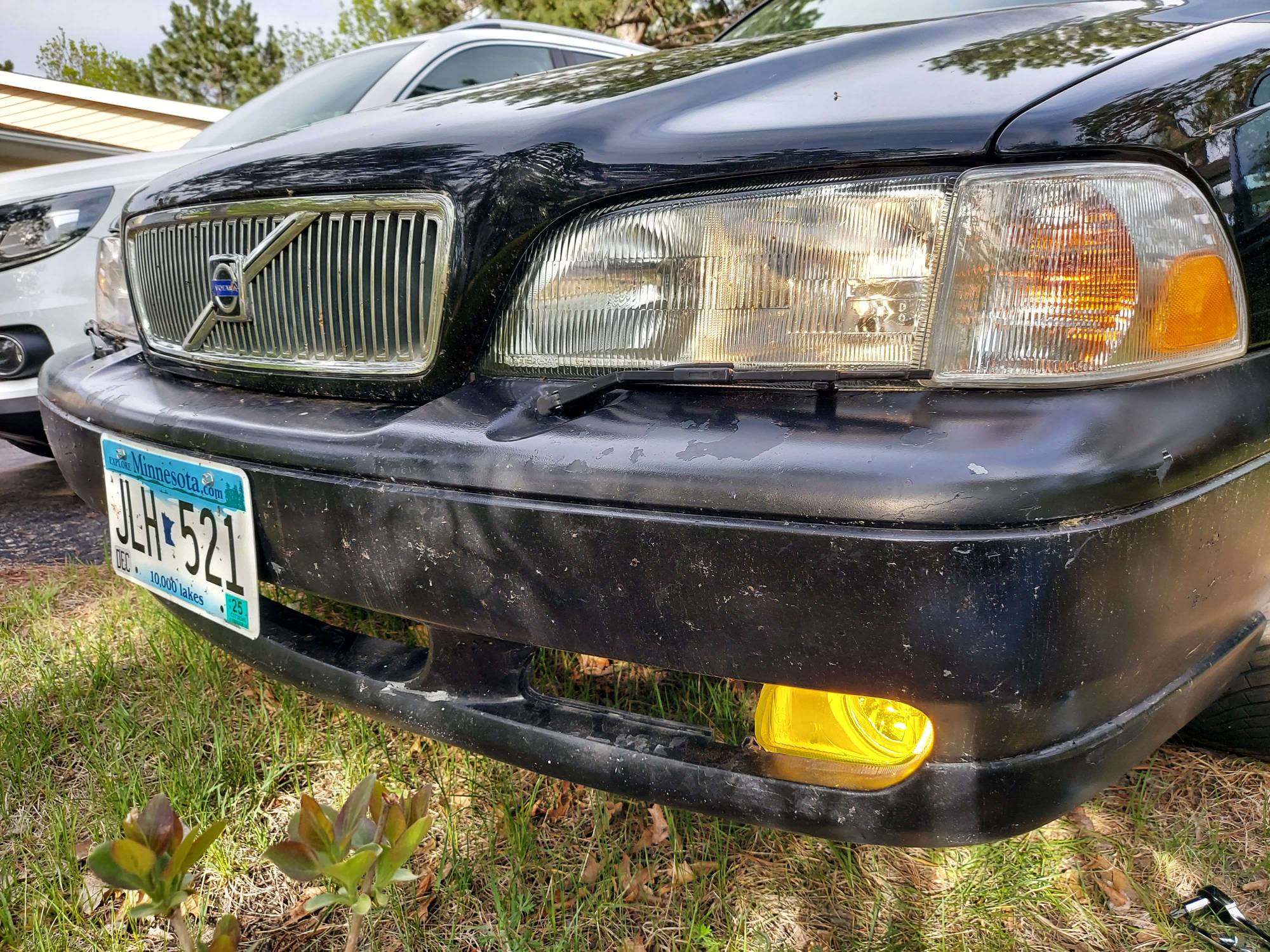

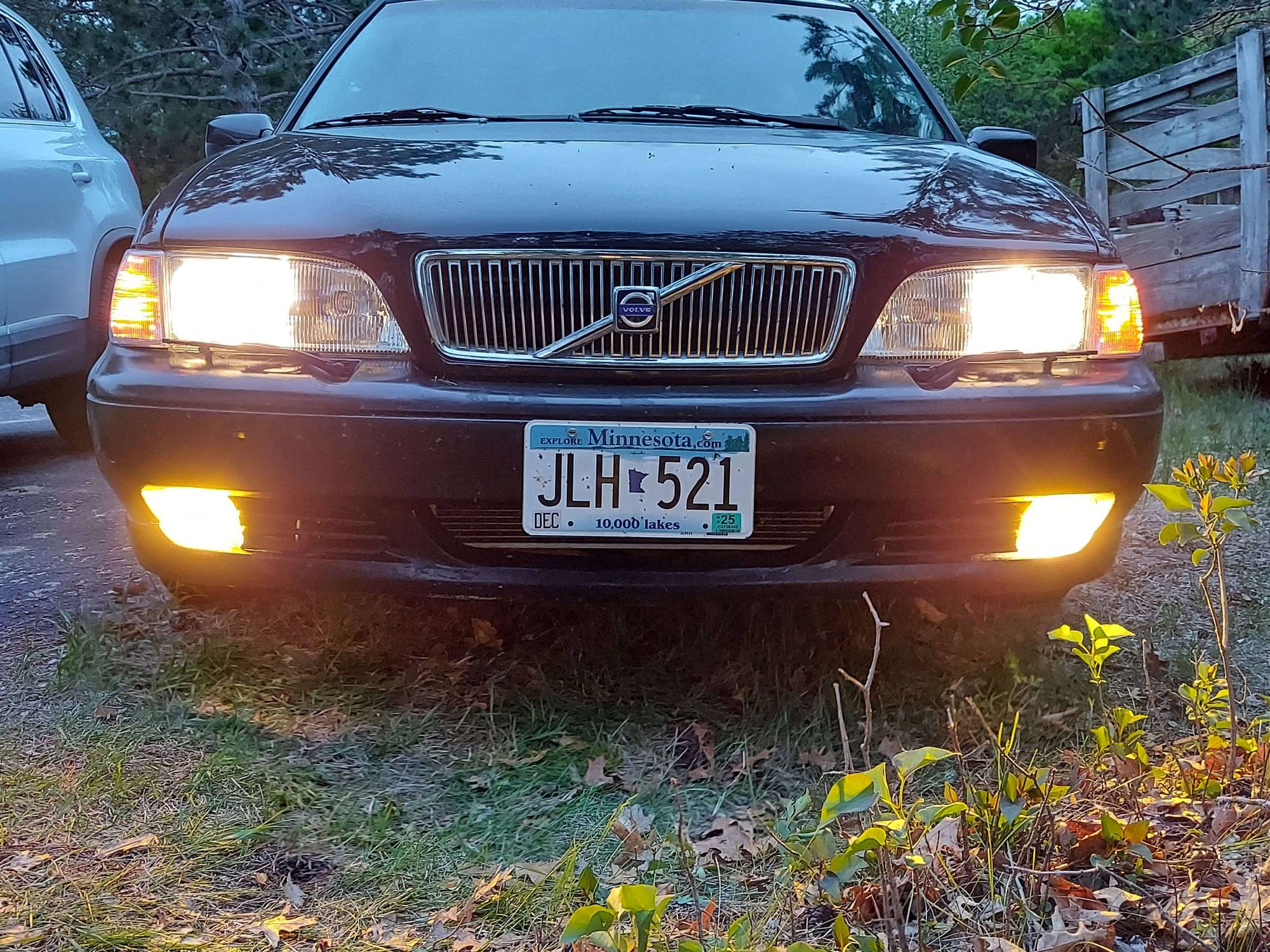

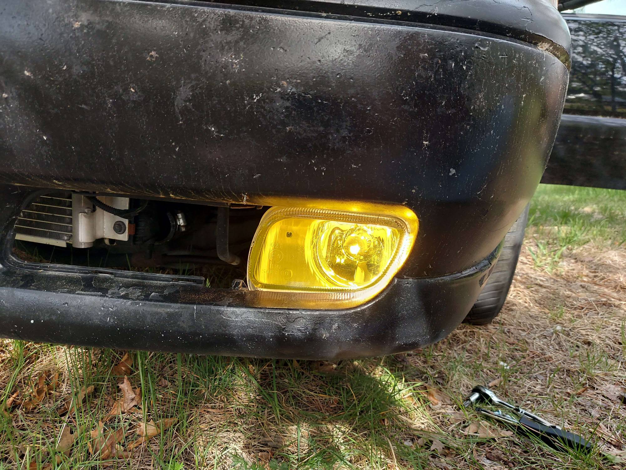

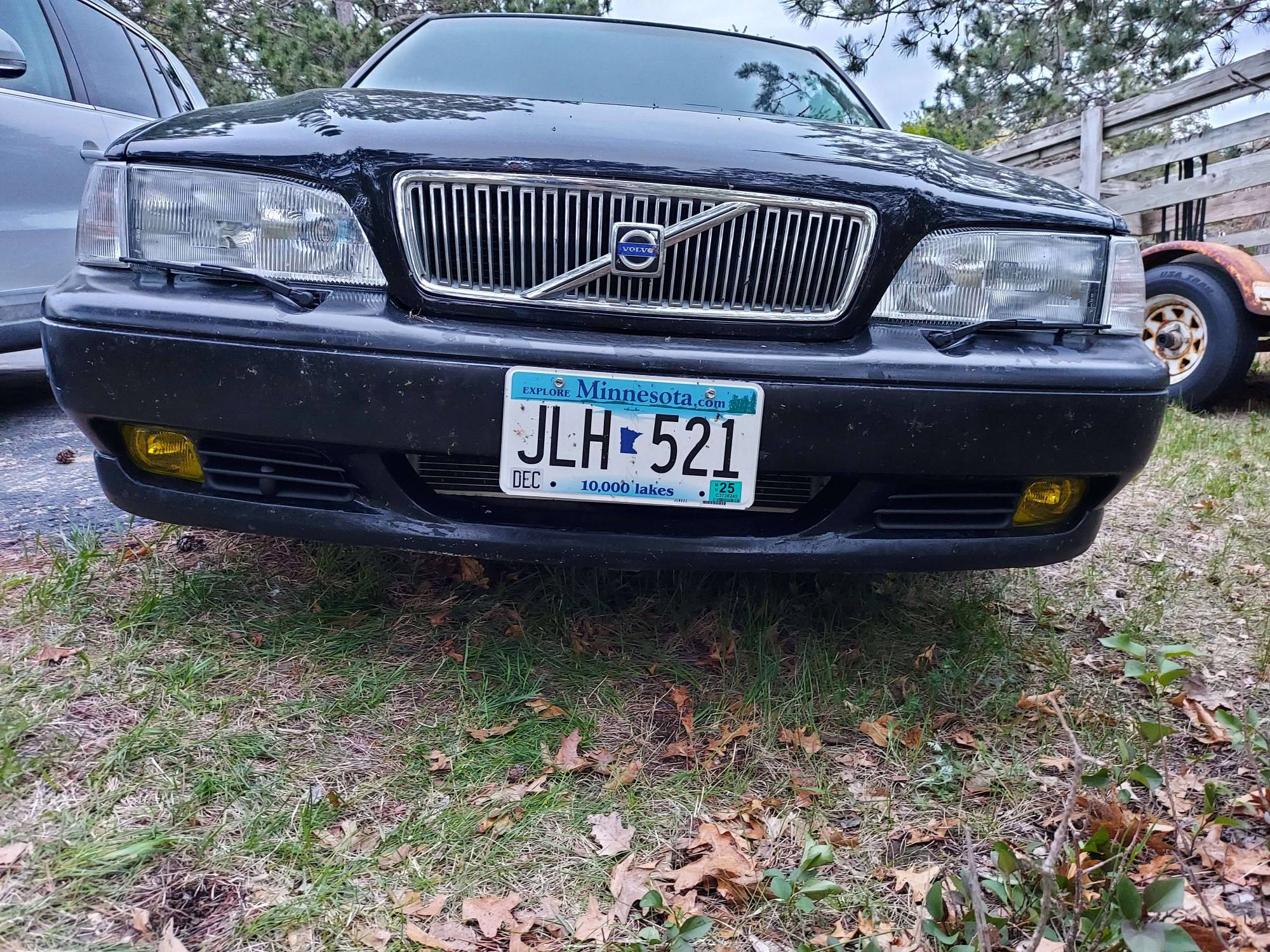

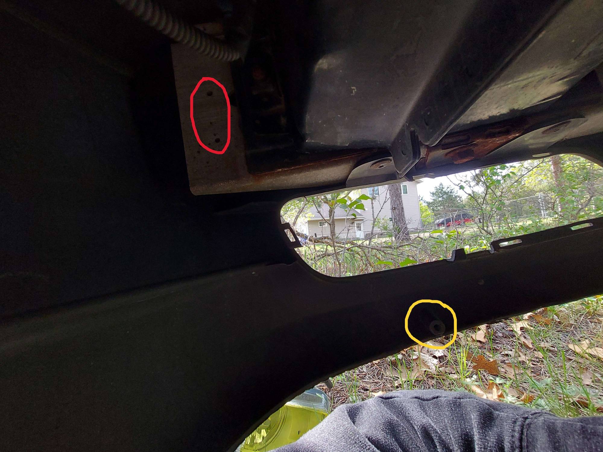

I finally received my new fog lights after ordering them a little over a month ago (they were on back order). I just installed them today and figured I should post what I did in case anyone else wants to reference it.
Here are the aftermarket lights I bought on iPD (made by Professional Parts Sweden). They came with the black brackets that my car doesn't have. I also bought yellow tint for the fog lights, because I think it's cool. The bracket secures to the car with one sheet metal screw (threads into plastic boss on the bumper)[yellow] and two self tapping screws (threads into the two small holes in the crash bar)[red]. A power tool was needed for the self tappers to bite into the metal. I needed to cut off this tab on each side of the car as it otherwise blocks the fog light from sitting properly. That's pretty much it, plug in the harnesses and insert the grilles. Here are some pictures taken during and after installing them.

Nice job, and the yellow looks good too.
