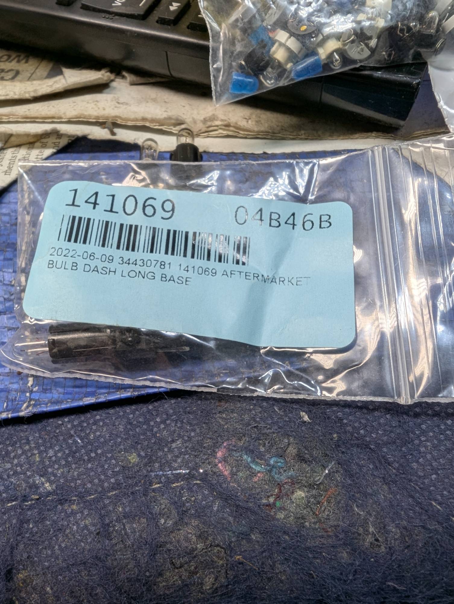

For the gear shift bulb now I just get them from IPD maybe 5 at a time so I have then on the shelf. They at least offer an aftermarket one for around $6-7 US or cheaper in their sales.
https://www.ipdusa.com/products/23023/G ... umbs=0,970

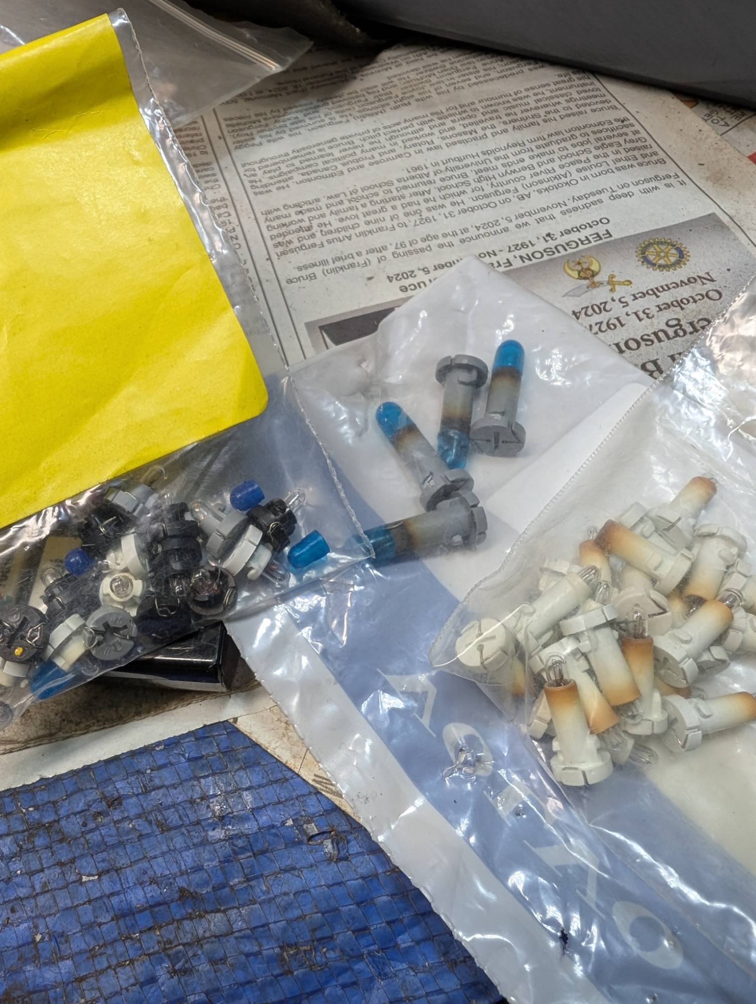

However, I do buy small LED bulbs to repair all the bulb holders for switches and other mainly dashboard and console switches.

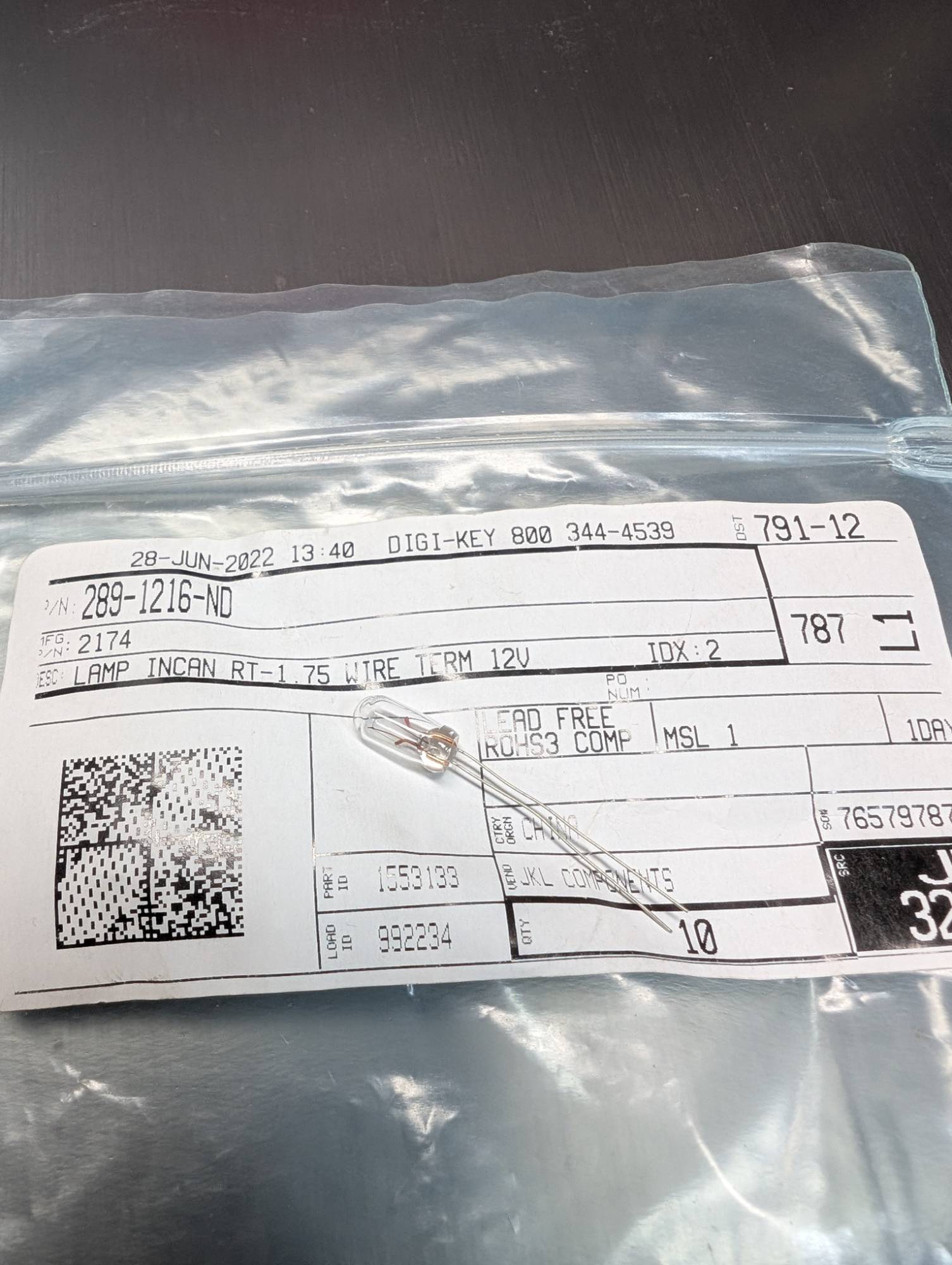

There are 2 LED bulbs I typically use. The first one below is for most of the switches:

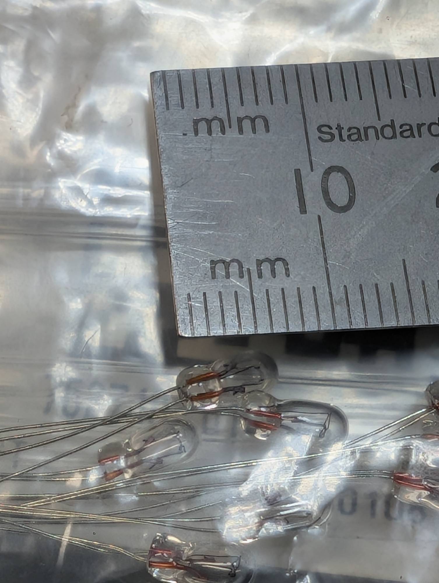

Approximate dimension of the bulb:

The smaller bulbs are relatively easy to do with a little patience and a small sharp pick , pliers and small pointed wire cutters.
