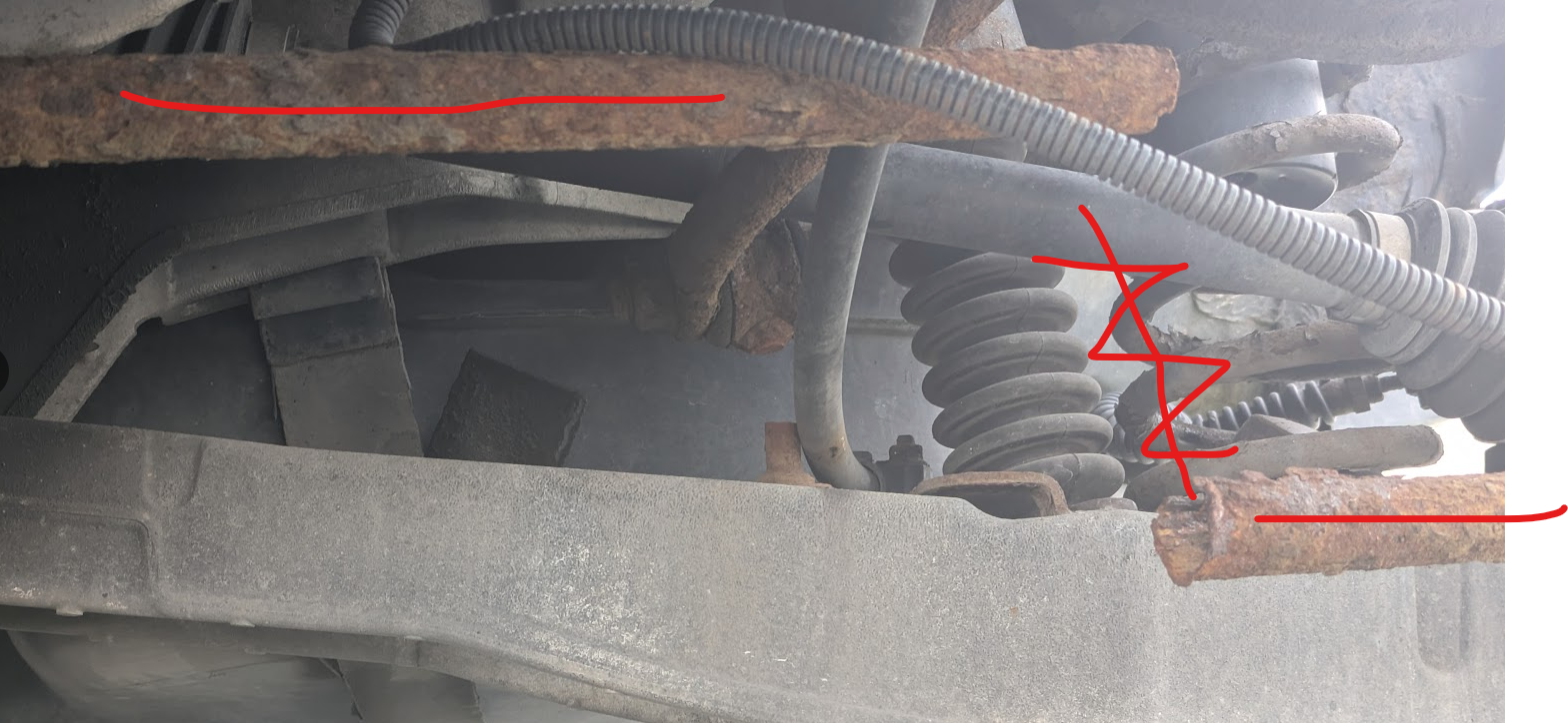

Take a look at the panhard stays at the rear and make sure they aren’t rusted out. There are some unicorn parts back there you have to be careful to not break.

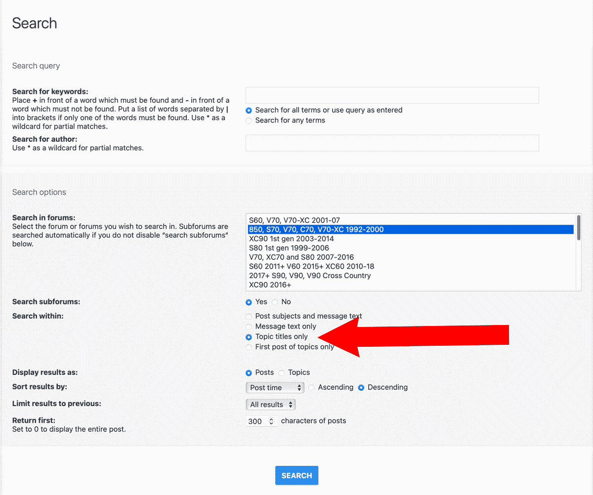

Everything on MVS that isn't in the forums is the Volvo Repair Database (2% of MVS pages), which, to my great surprise, also contains lots of news items, but ignore that. Everything in the Repair Database is the creme de la creme that is (usually) pulled from the forums (98% MVS pages) over the last 20 years and promoted to VRD due to significance/importance. The forums are very broad and very deep, but you can handle that with a well structured search, which you're probably done. Forums search tip: use Topic Titles Only first, then to broaden results, select any of those other radio buttons. Start tight, then loosen.
Don't be afraid to ask questions. There's a lot of info here and because we're pre-AI Singularity, it takes a bit of "knack" to get to it all via search.

Example of a bad panhard stay/rod:
