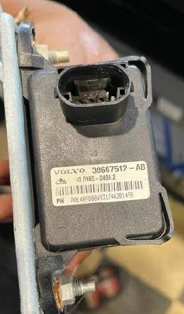

I have a 07 XC90 3.2 FWD with 130K. Two months ago I had all the ABS / vacuum pump replaced, they said at the time my it would be a good idea to replace my ASC yaw sensor box as they said because of the age it may have corrosion and send a code. It was an additional $700 so I said no. Well a few days ago I had the antiskid triangle come on, so I took ASC yaw sensor box and the plug does look corroded, dirty and such. I know my drains for the sunroof are good I replaced them several years ago so I do not think it is water damaged. Anyway I am looking for any information anyone has for the best place to source the anti skid ASC yaw sensor box Volvo part # 30667512-AB.
Thanks for any advice!![Image]()

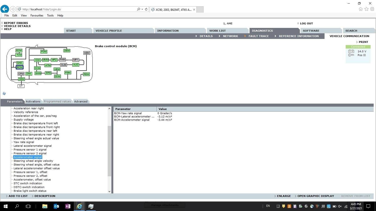

Re-connect the module in the car and fire up VIDA (you have VIDA right?).
Connect to the car, go to Diagnostic, Vehicle Communication, Select the BCM and look under Parameters.
You should see the data returned by the sensor - is data available and sensible (see picture)?

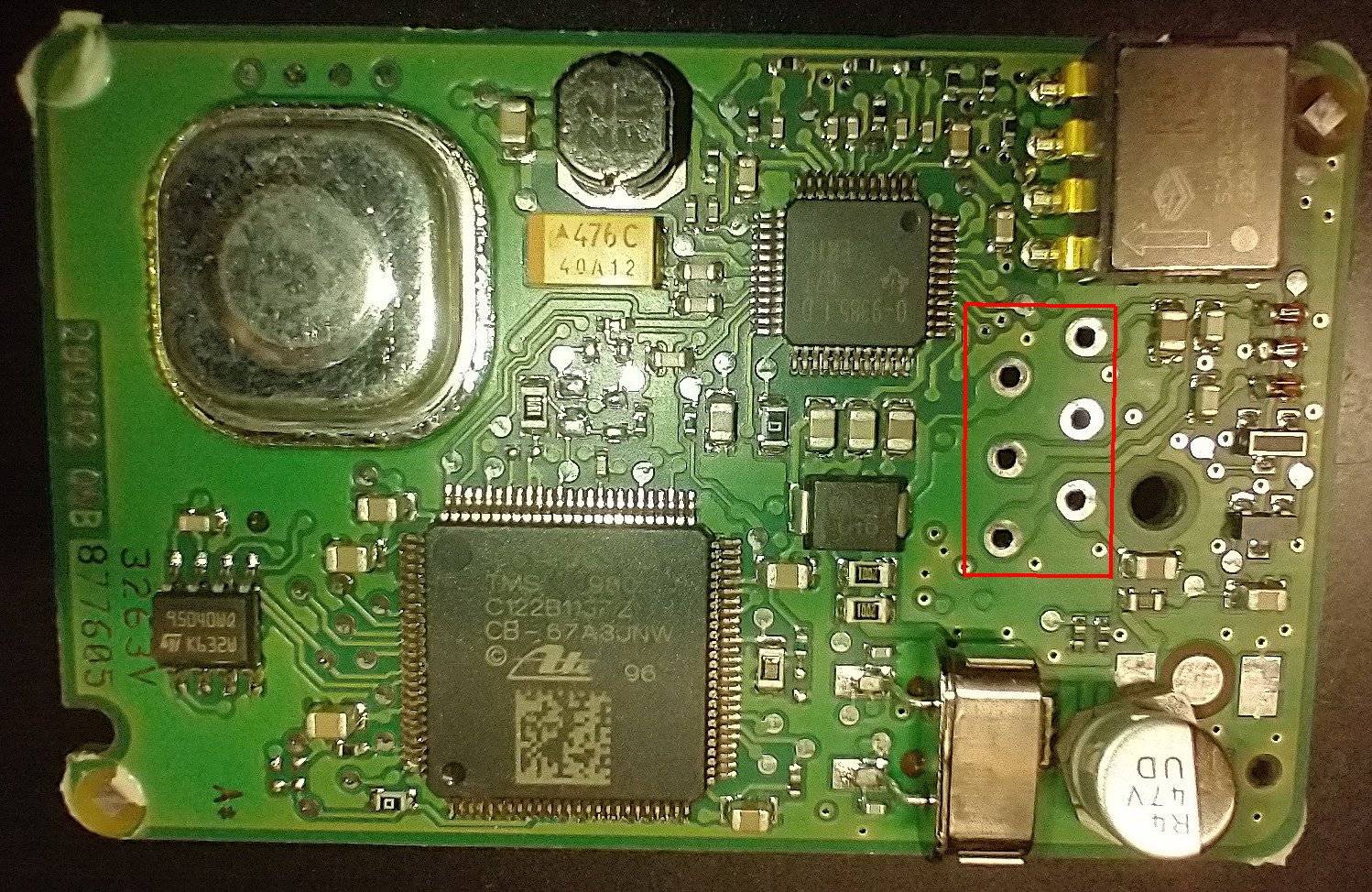

And for fun, here's the magic inside these modules:
2x accelerometers, measuring front/back and side-side axes (upper-right)
1x gyroscope for yaw measurements (upper-left)
1x Custom masked TMS980 DSP chip.
PCB holes (red rectangle) is where the outside pins connect.
You can bet that a fair bit of engineering has gone into this unit.
