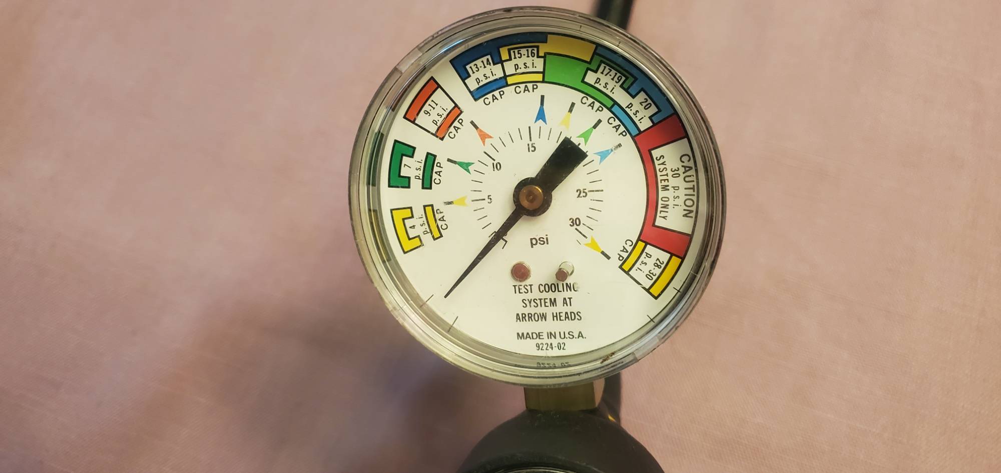

the coolant cap is usually rated around 12 psi, so 10psi would be ok.

Based on quick search green color cap is rated for 1.5bar which is 21psi. As far as I remember correctly lots of rental tools dont have volvo specific adaptor. Adaptor is about $45. You might get lucky with buying something from harbor freight and maybe in their master set there is correct adaptor. I think at this point I much rather pay dealer $180 per hour of diagnostic and drink coffee in their waiting room or enjoy a loaner for a day. To buy adaptor +shipping+tax +plus trying to find correct pressurizing tool+ time to get the tool and return it+labor(it might be way easier to see this problem in a lift)..long story short I dont think this job is worth your time u less you are particularly passioned about doing it yourself (180- 45(tool that you likely would never use again)-10 for shipping..)

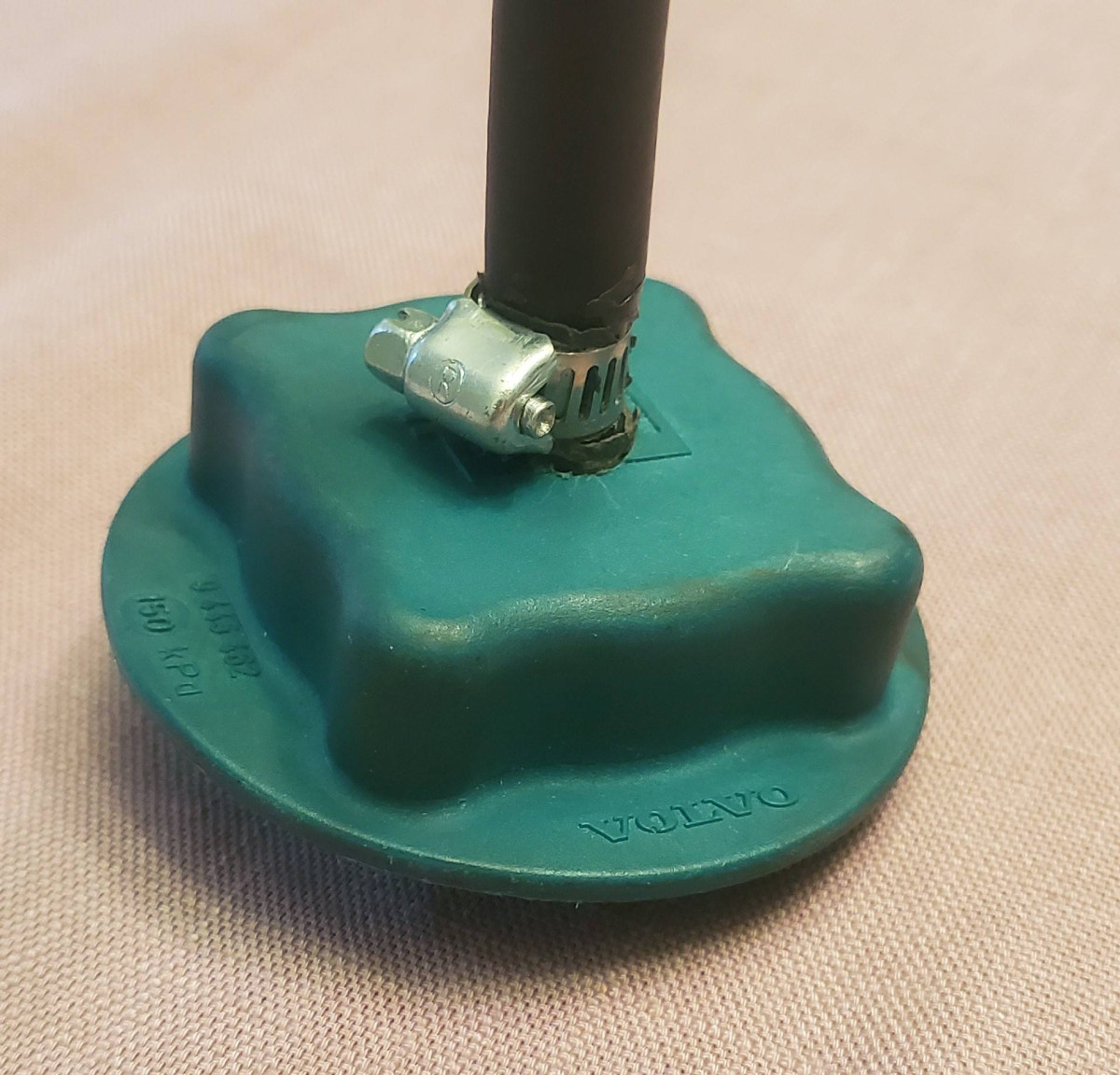

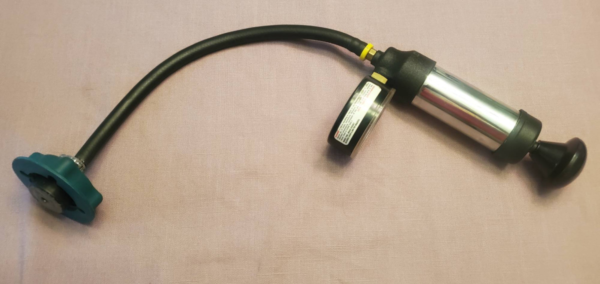

I have taken an old cap, drilled a hole, tapped for 1/8 pipe thread, and added connection to pressurize with air. With a gauge in the connection, you can monitor initial pressure and bled off.

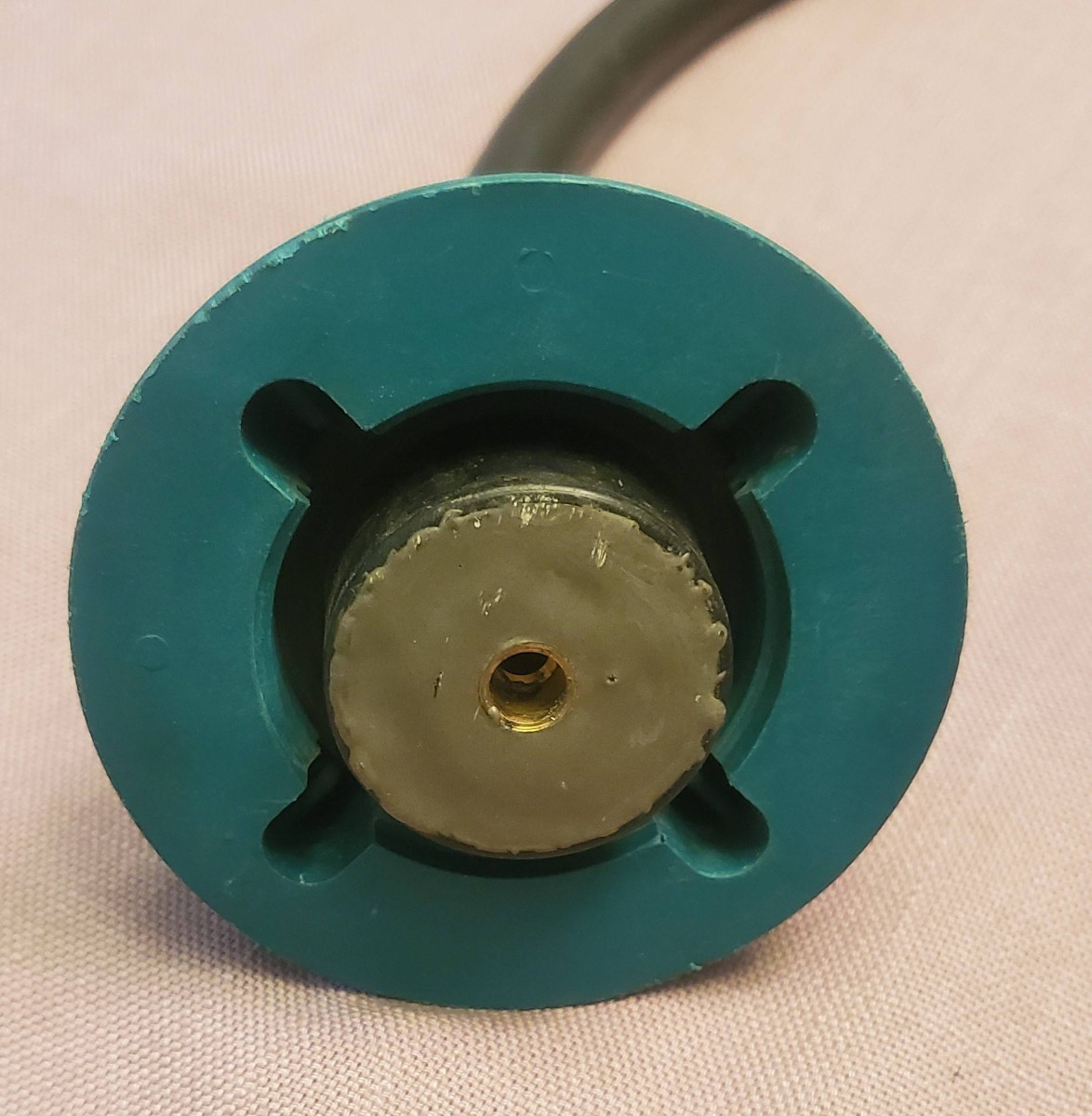

I did the same thing as volvolugnut and drilled an old Volvo coolant cap, tapped for a brass fitting, and made my own adaptor. You have to disassemble/unsnap the green top part of the cap off the black bottom part to access the area for drilling and tapping the threads. I had a little leak after finishing so I roughened the plastic a little and sealed it with JB Weld epoxy.
