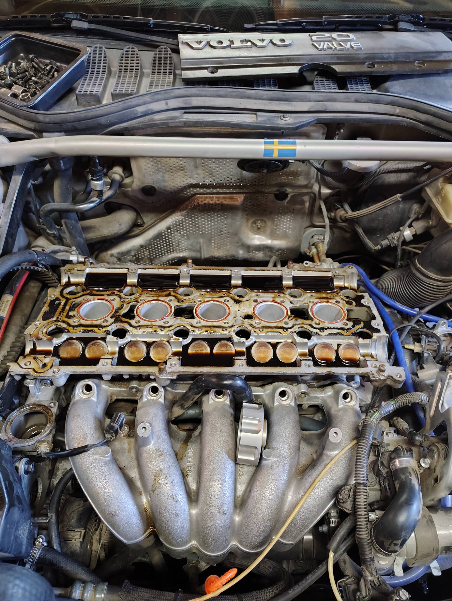

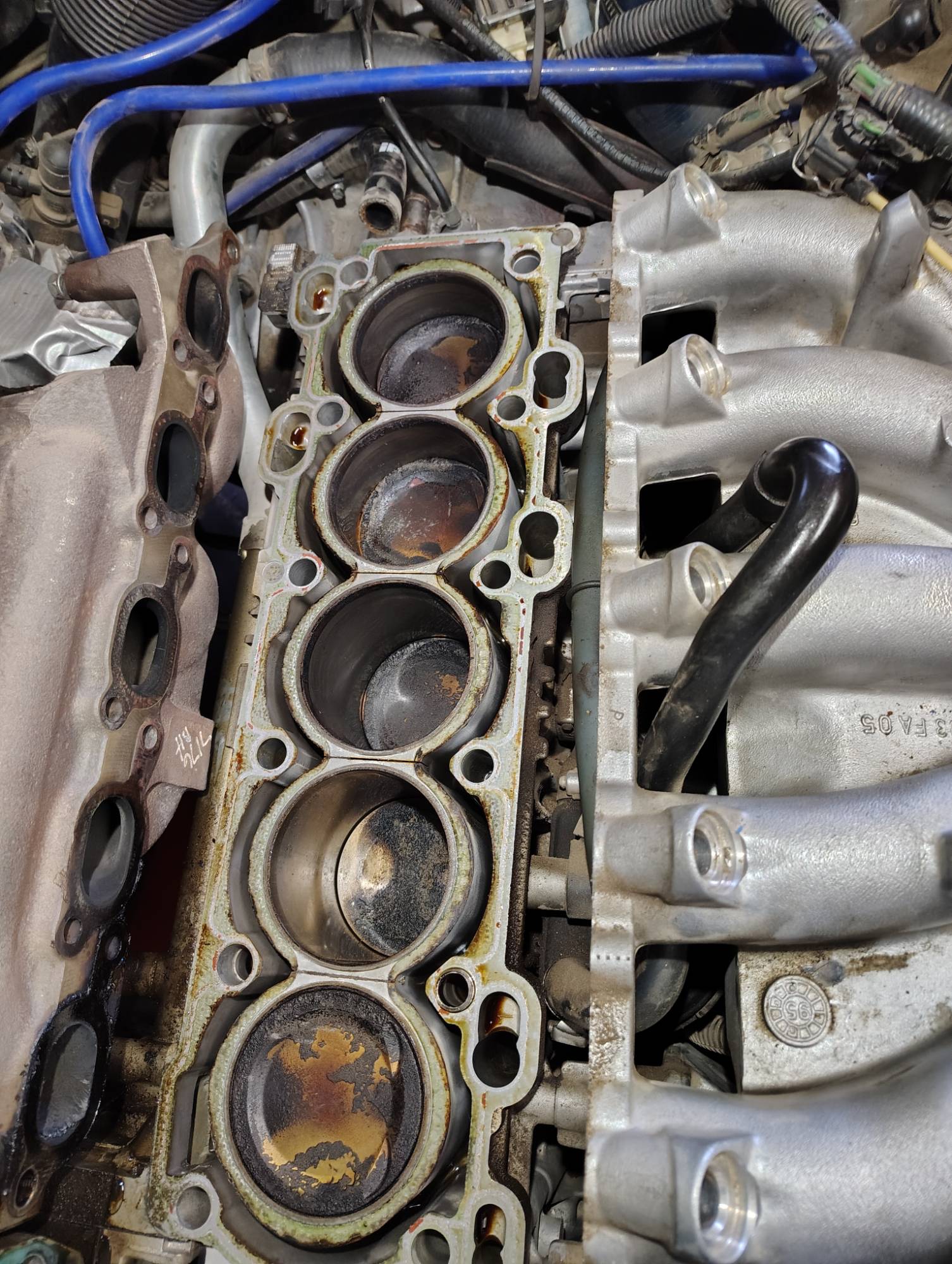

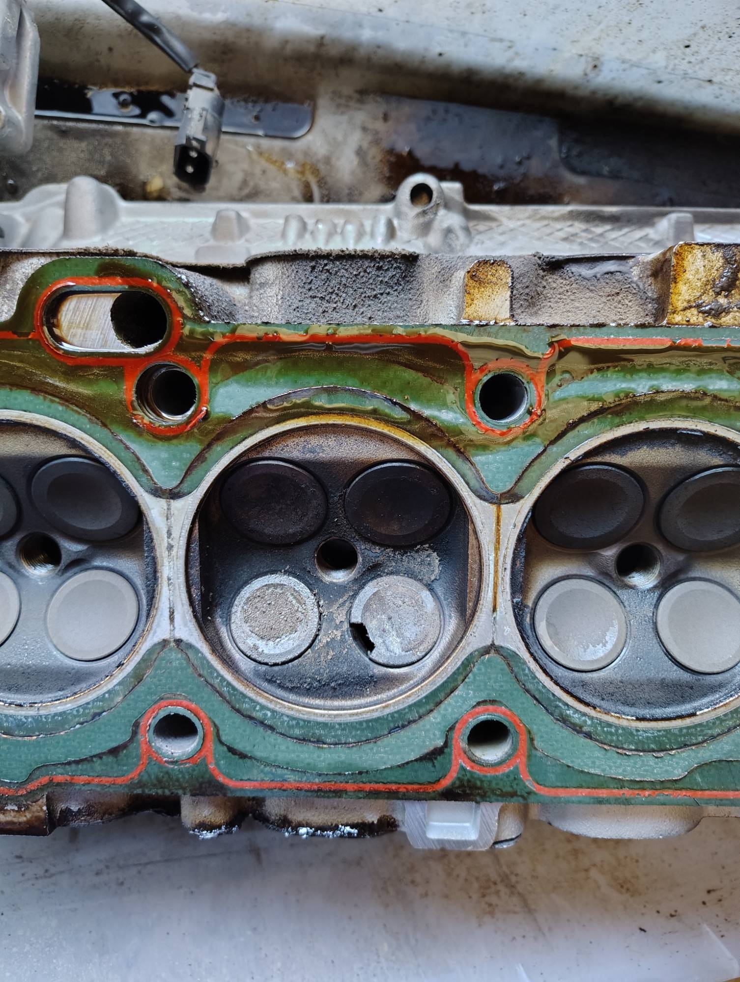

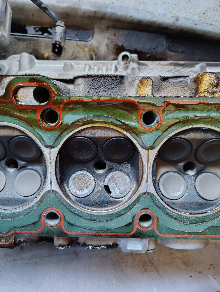

Took a week off from head work. Don't want to have too much of a good thing
This is pretty much what I expected ( a hole in #2 cyl exhaust valve ), but I am wondering about the amount of carbon or burnt oil present.
It seems excessive for only 30k on the rebuild. So I'm going out on a limb, again, and guessing that it was caused by bad valve stem seals.
When I dropped the engine off at the machine shop, I also gave them a engine gasket set, which came with the aftermarket valve stem seals. I went back a week or so later to give them the blue box seals when I got them, but I didn't think to ask for the ones that came in the set back. So there was a 50-50 chance that the wrong seals were installed. Guess I'll never know.
So it looks like two new exhaust valves will need to be sourced. With some aftermarket seals of course
