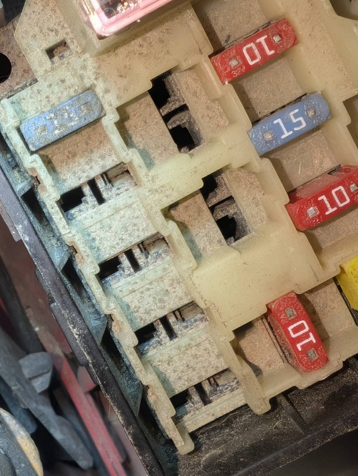

Today, I decided to tackle the mini-fuses in the box as they looked like they were dirty and had been sprayed with dirty water:

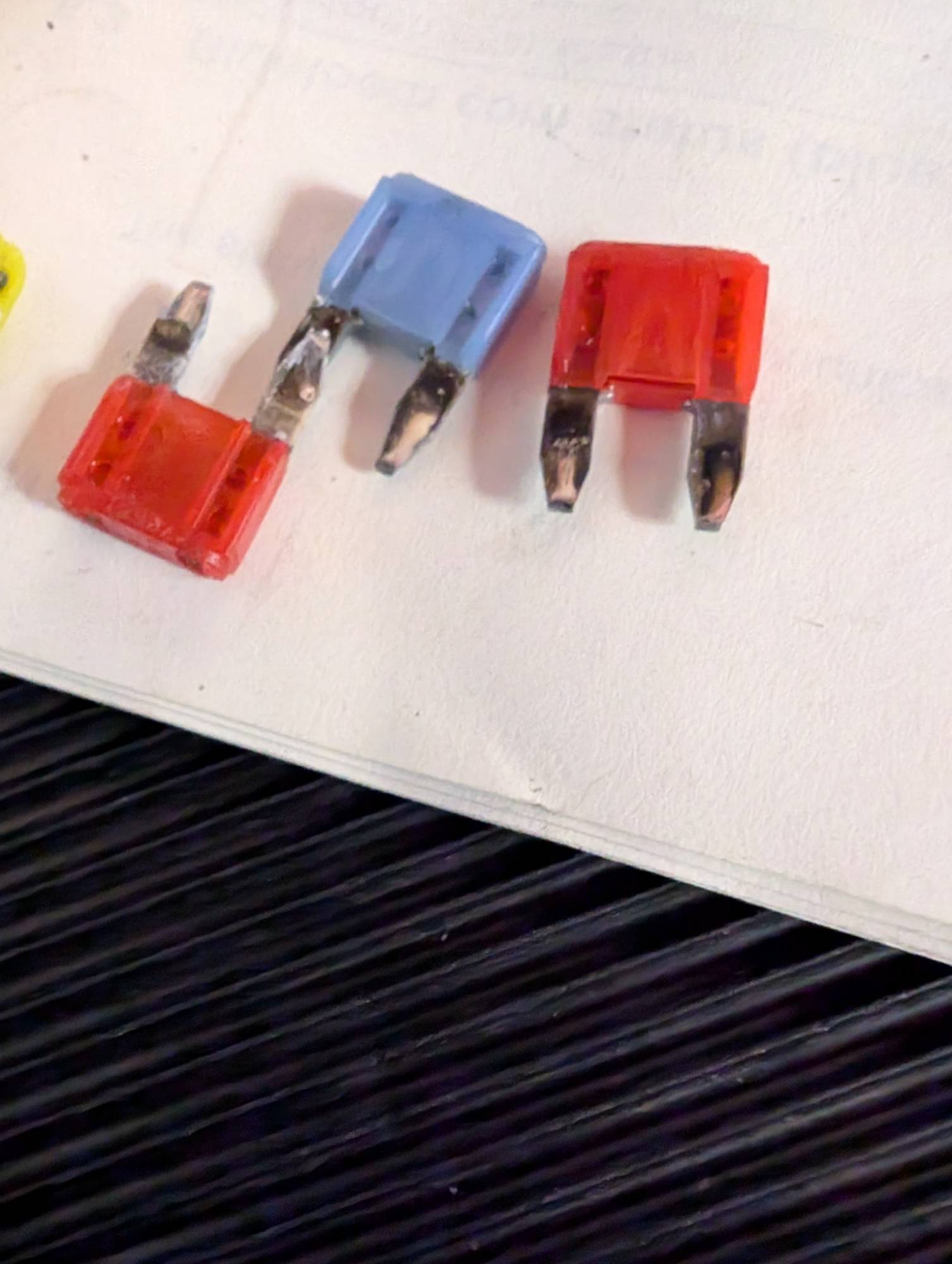

I removed all the fuses (after taking the above picture for fuse value and position reference) and this is what I found:

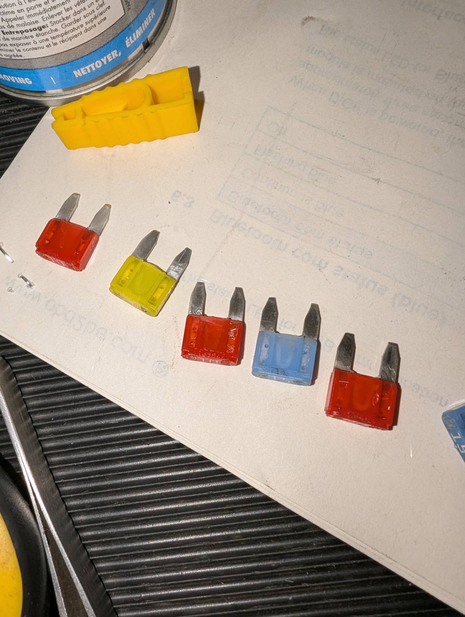

All the 10-12 fuses were like this or worse. I have removed them then and cleaned then all with a fiberglass brush so they now look like this:

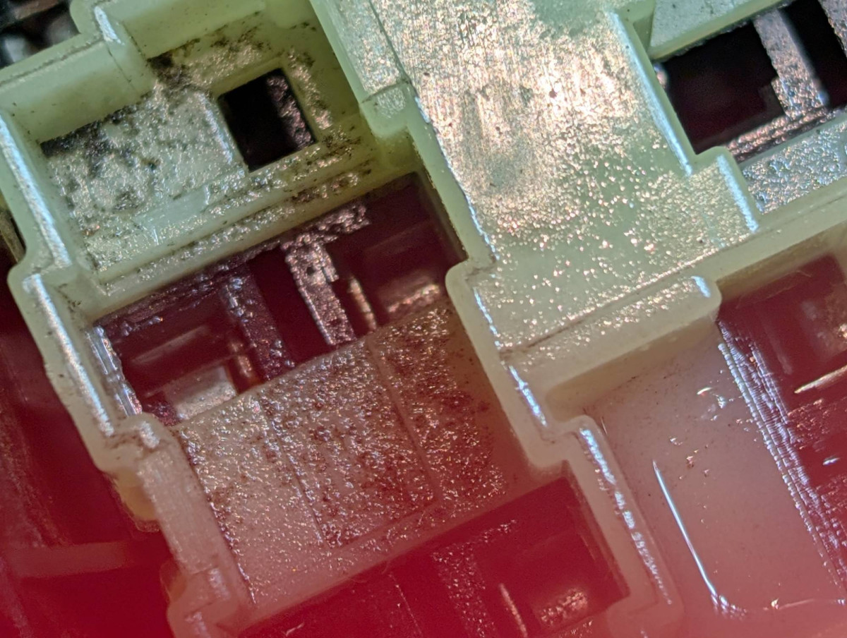

I have soaked the fuse box contacts for the fuses in the Wurth contact cleaner and I'm leaving them the ferment for a few hours before blowing out and remaining residue and fluid with compressed air. My 2 questions are this:
1) Even though the fuses have cleaned up pretty well, would you re-use them or just use new ones. I have a box of cheap mini-fuses for our 06 XC70 as emergencies, but would I be better off using those or reuse the old one ok. In both cases I will brush the contacts with No-Ox-it.
2) I have as mentioned left the contacts for the fuses in the box soaking in contact cleaner. Should I clean the contacts mechanical some how? If so what should I use? Normally I'd use a toothbrush but due to the design and position of the box, it is hard to get into the contacts as they are countersunk:

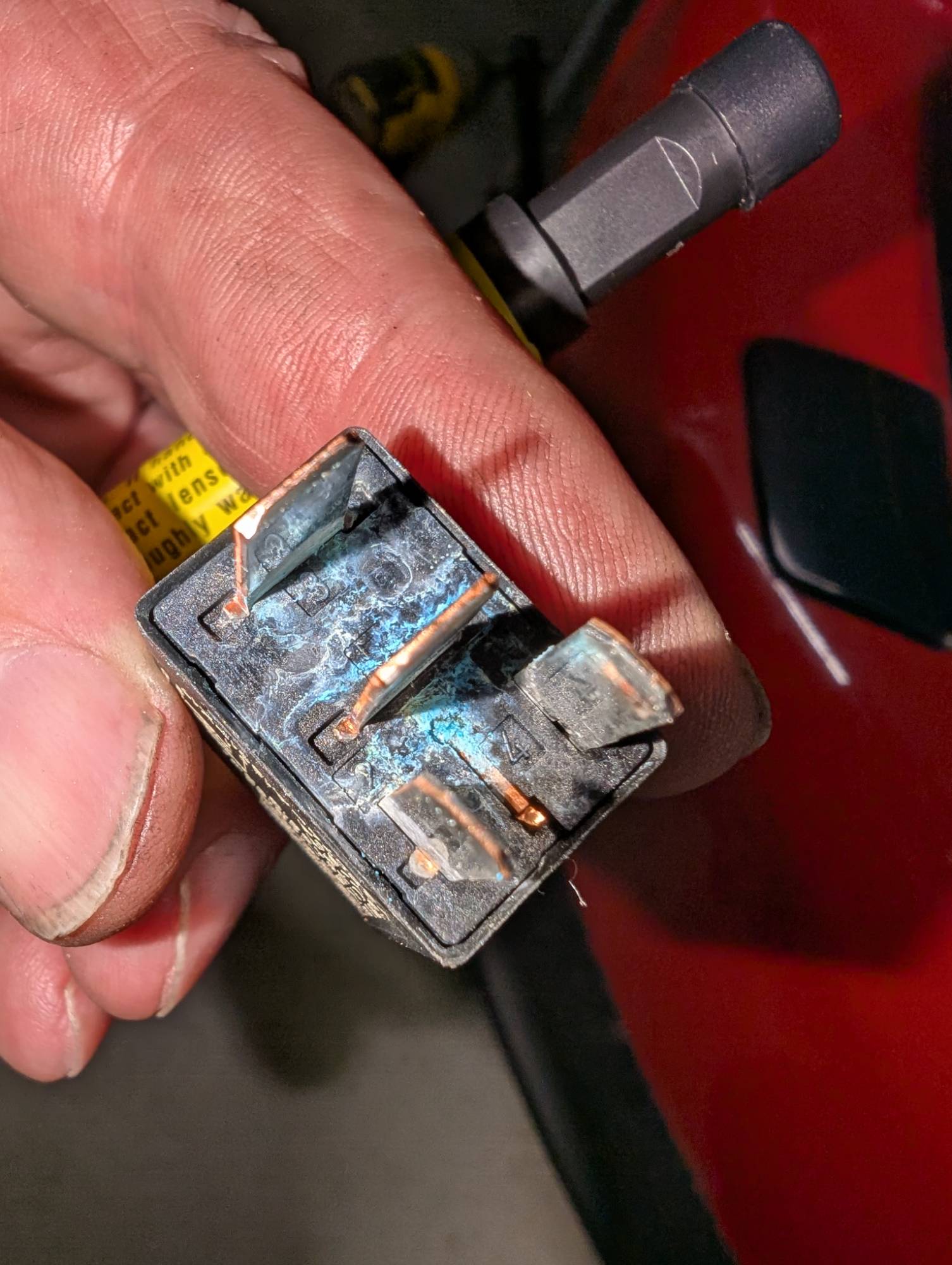

These are what the 2 relays looked like. The others were lightly oxidized:

https://www.amazon.com/Electrical-Termi ... 7898&psc=1
That's the idea about how to clean pins inside.i would be slightly worried about corrosion entering inside the relays or corrosion too much inside the fuse box in the areas where it is hard to see or reach. Possibly can consider just replacing all the relays from the donor after the main issue will be fixed.

You can buy a set of jewellers/ watchmakers flat files that are less thick than the fuse tabs. I would find some files and clean them up that way.

Actually, the Wurth cleaner did an amazing job and the connections were really clean after leaving for an hour or so.
All the fuse engine bay main fuse box relays and fuses were cleaned, as well as the pin connectors, particularly the fuses that were bad.

I just cleaned all the fuses with a fiber glass pen. They came up real nice and clean. I came to the conclusion that mush of the black on the fuses is actually meant to be there. It is I think an anti-oxide coating. When you push the fuse home for the first time it only scrapes away the contact area. If that is the case then I just ruined them all as I cleaned them all, then De-Ox-ID'd them, before refitting.

I forgot to add. I did open both of the corroded relays and internally they were pristine.
