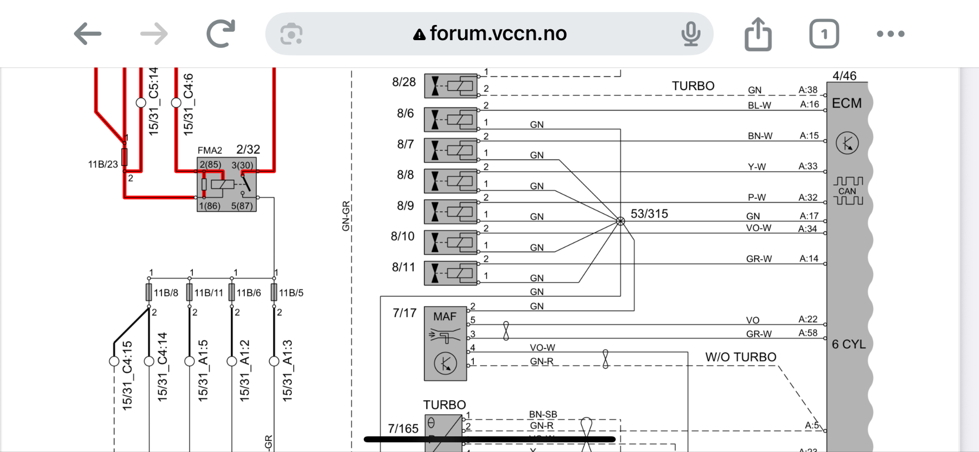

My 2004 Volvo S80 T6 2.9, Im replacing the fuel injectors wiring harness and cut all the green wire without labeling to what injector they served. The color wire w/white stripes I did label. Since all the green wire in the wiring diagram shows they all tie together before connecting to the PCM terminal does it matter which one I connect to each fuel injector?
