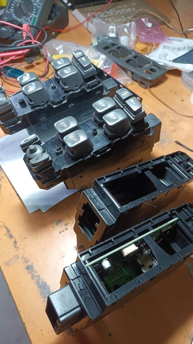

volvo 2001 DDM
volvo 2001 DDM
ddm volvo repair.jpg (108.81 KiB) Viewed 430 times

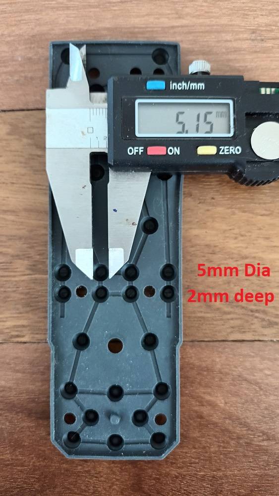

I have four DDMs to play with, i should get atleast one working. I bought some conductive pads or pills of the internet and they work great, problem is attaching them as nothing will stick to silicon rubber. The graphite or carbon tip on the drivers door window switch is showing a high resistance compared to the others so i am fairly sure thats the problem. Theres a repair shop in the US called Buttonworx who makes new button that can be stuck under the keypad, this might work?
volvo DDM silicon rubber buttons
window switch.jpg (75.92 KiB) Viewed 430 times
