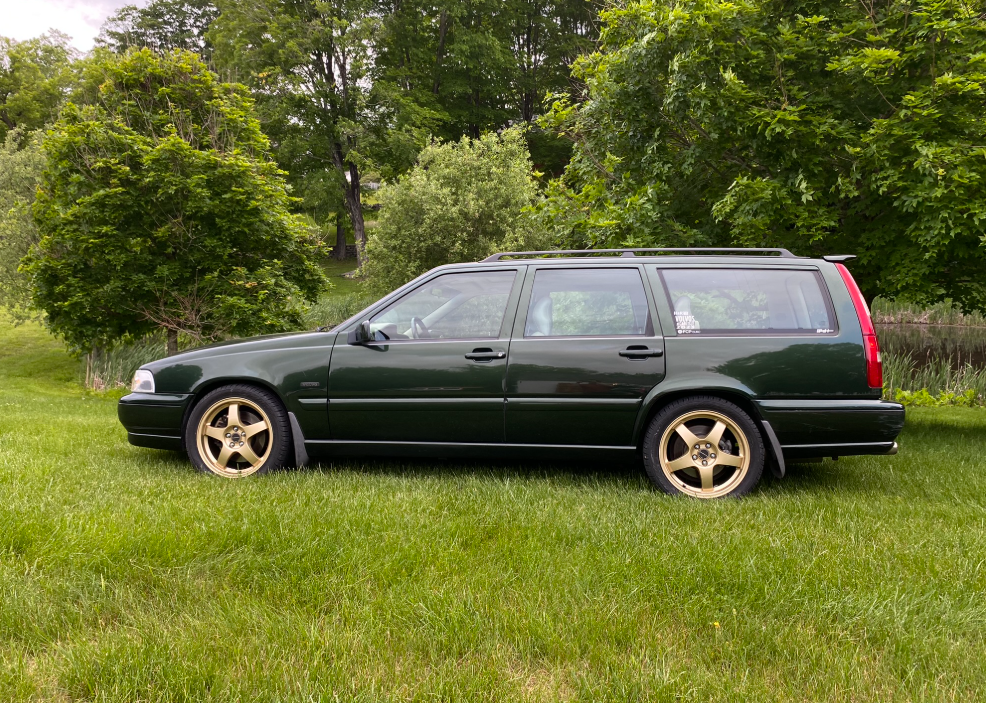

Post by V50M66 »
The most comfortable setup on these cars that I've experienced is Bilstein B4 shocks/struts and H&R 29955 lowering springs. Rides better than stock, looks great, and handles fantastically. By far the best setup for P80.

V50M66 wrote: 05 Jun 2025, 20:58 The most comfortable setup on these cars that I've experienced is Bilstein B4 shocks/struts and H&R 29955 lowering springs. Rides better than stock, looks great, and handles fantastically. By far the best setup for P80.
That is a beautiful car !!

Post by V50M66 »
P80 V70 uses the same suspension as 850. Note that factory springs are awful and ride like garbage because they’re under wayyyy too much preload.
You’ll want the H&R spring variant that is for non-Nivomat (not self-leveling) shocks.
Regular Bilstein B4 (black body) are what you want for shocks. Not B6 or HD (yellow body) - those ride like crap.
Being that you have an R, you already have the best sway bars for handling from the factory. Don’t touch them.
I run Vredestein Hypertrac in the summer months and Nokian WRG4 in the winter.
Thanks guys! It’s been a long road to get that car to this point.
