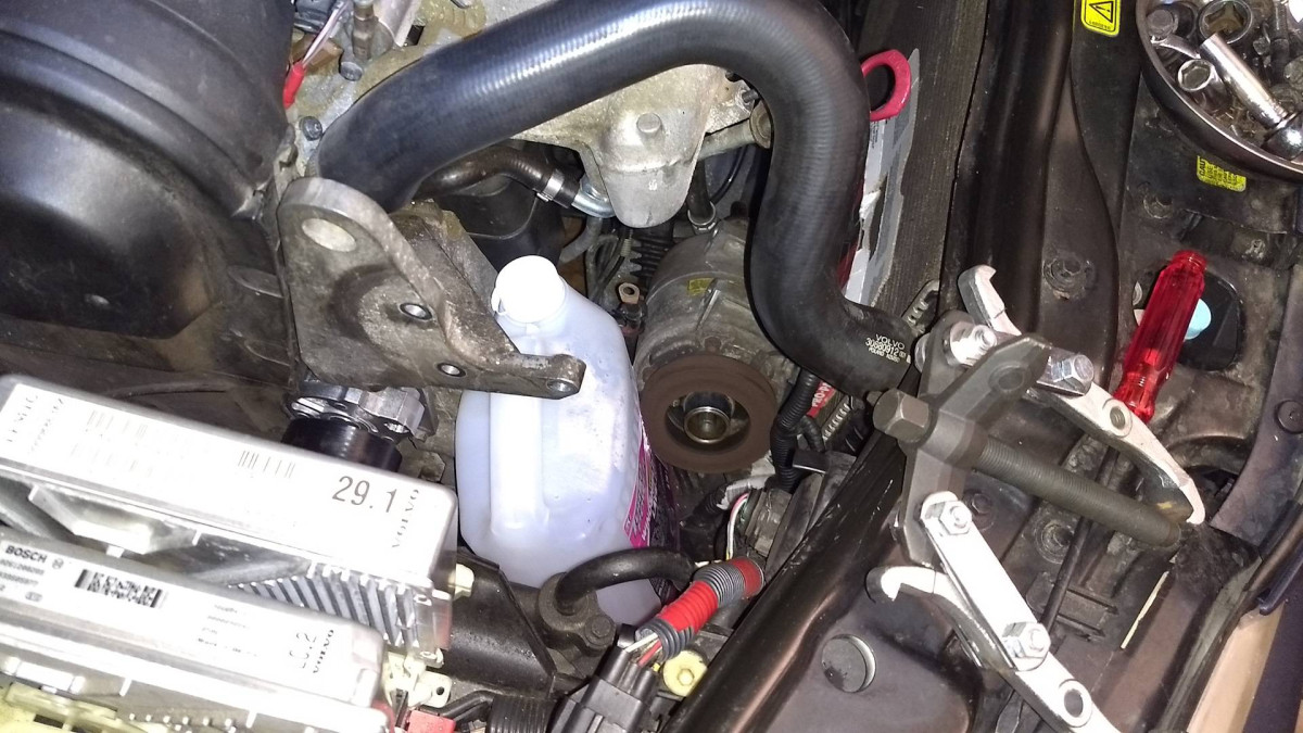

I have this type of AC
and not the one where commonly the zip ties are used
So for my variant. How do I apply the zip ties?

Doesn’t look possible, I wonder if you can shim the clutch like other compressors?

Need to pull the clutch, there're a couple of shims (make sure you drop them and spend good two hours trying to find where did they go). Remove one, so the gap is around 0.6 mm.
Can inspect the bearing and replace if needed. Or just replace.

Can the compressor be moved around like that with the system full?
In VIDA it says Image
I can tell just from a visual inspection that the gap is wider than 0.5mm on my AC. Actual measurement showed on engine off(cool engine 25c), ambient temp 25c that clutch gap was around 0.75mm, maybe 0.8 but 0.75 was closer.
There is also a nice video of someone pulling this exact AC

dikidera wrote: 15 Jun 2025, 02:37 Can the compressor be moved around like that with the system full?
Of course it can.
dikidera wrote: 15 Jun 2025, 02:37 I can tell just from a visual inspection that the gap is wider than 0.5mm on my AC. Actual measurement showed on engine off(cool engine 25c), ambient temp 25c that clutch gap was around 0.75mm, maybe 0.8 but 0.75 was closer.
You need to remove one shim.

Do you think I can only remove the compressor's bolts slightly, to move it more towards the bumper and work from underneath the car? In the videos I saw the guy removed PS pump, alternator and then compressor. I can do it, but it does seem quite a lot of work to get access to the clutch. I do have access even now, I just can't prop the clutch not to spin so I can give my spanner a nice hit from the hammer and get the 10mm bolt loose.

Yeah, you can try it from below. Protect the radiator with cardboard if you happen to pull the fan.
