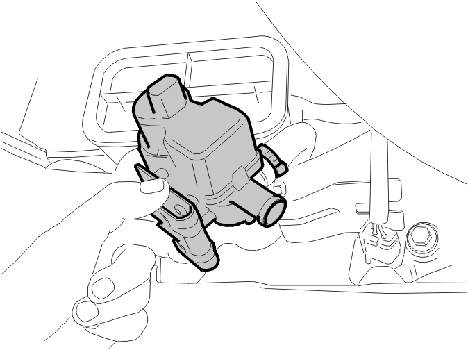

I don't know if the 2006 XC70 had a canister vent solenoid or one of the pumps for pressurising the fuel system. The solenoid and pump are used in conjunction with a pressure transducer to detect leaks. The tank is either pressurised with a pump or vacuumed using the manifold vacuum and then the solenoid is closed. If the pressure or vacuum dissipates then there is a leak in the fuel system. The solenoid can get stuck closed which will prevent fast refuelling or the pump can break in a closed position.
I looked in VIDA for 2006 XC70 fuel system repairs and saw that Volvo calls it a Leak Diagnostic Pump and the picture looks like this: The solenoid looks like this (Volvo call it a Shut-off valve in the parts catalog):
The Volvo parts catalog also says the solenoid was used up to chassis number 47,999 and the pump was used on chassis number 48000 and after.
