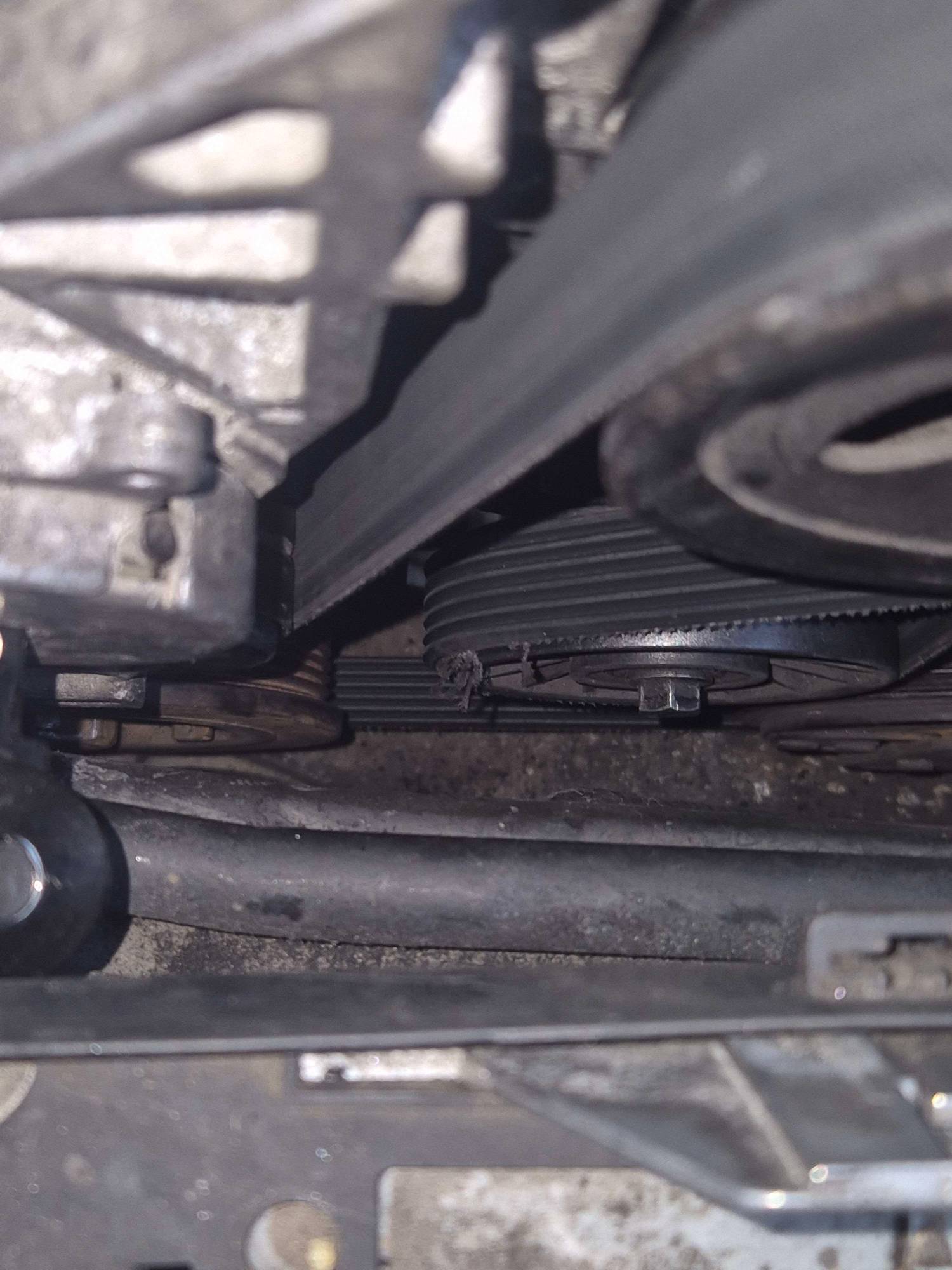

I've checked the belt itself which is brand new and it now has frays on the side away from the engine.

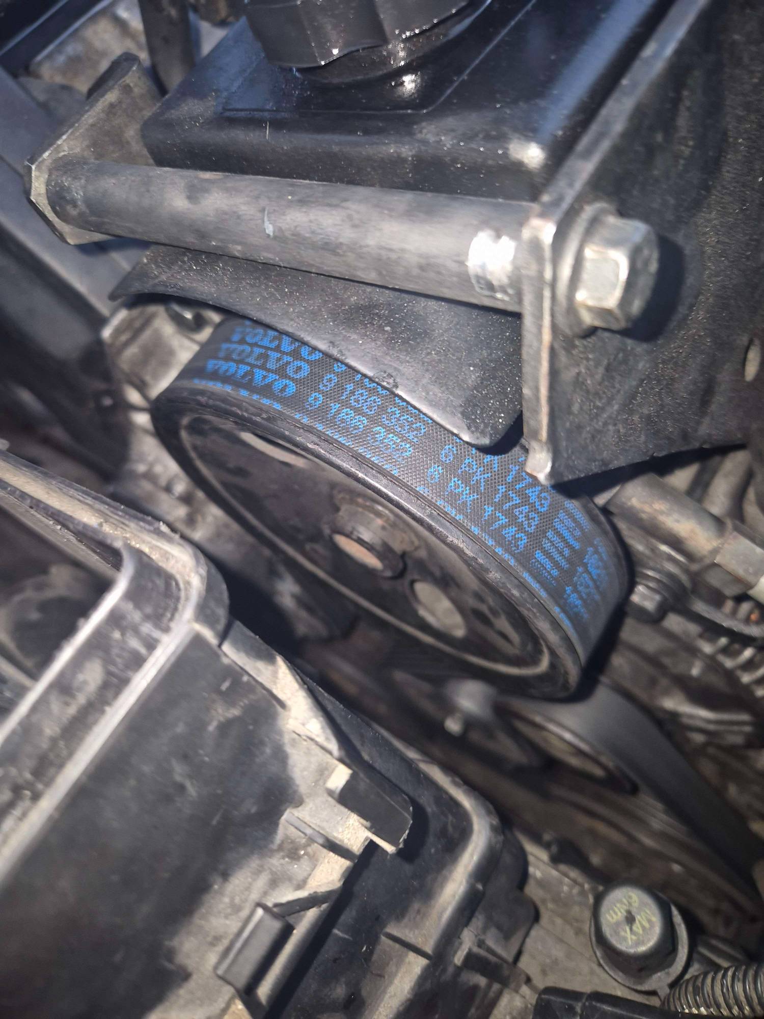

It also looks like its not centered on the idler pulley. I also checked the power steering wheel itself and It looks ok to me.
Im running a 6PK1743 belt with the newer routing as it doesn't seem like the belt is short enough for the older one instructed in viewtopic.php?t=60913. Im thinking of buying a shorter belt to see if that fixes it.

Hopefully the top picture is of the original belt as it has pieces shredded on the side of it!
Check the tensioner is doing it's job. Mine failed shortly after doing this job after being tensioned out of the pressure point.

Based on the top photo one of the components has "play" which eats into the belt and causes its shredding. I would replace tensioner assembly and alternator pulley as my top suspects. Ac compressor bearing might have some wear as well. Power steering pump is less likely suspect.

Some of the -1998 belts have been reall tight on tolerance. Where does your tensioner sit relative to fully tight?
