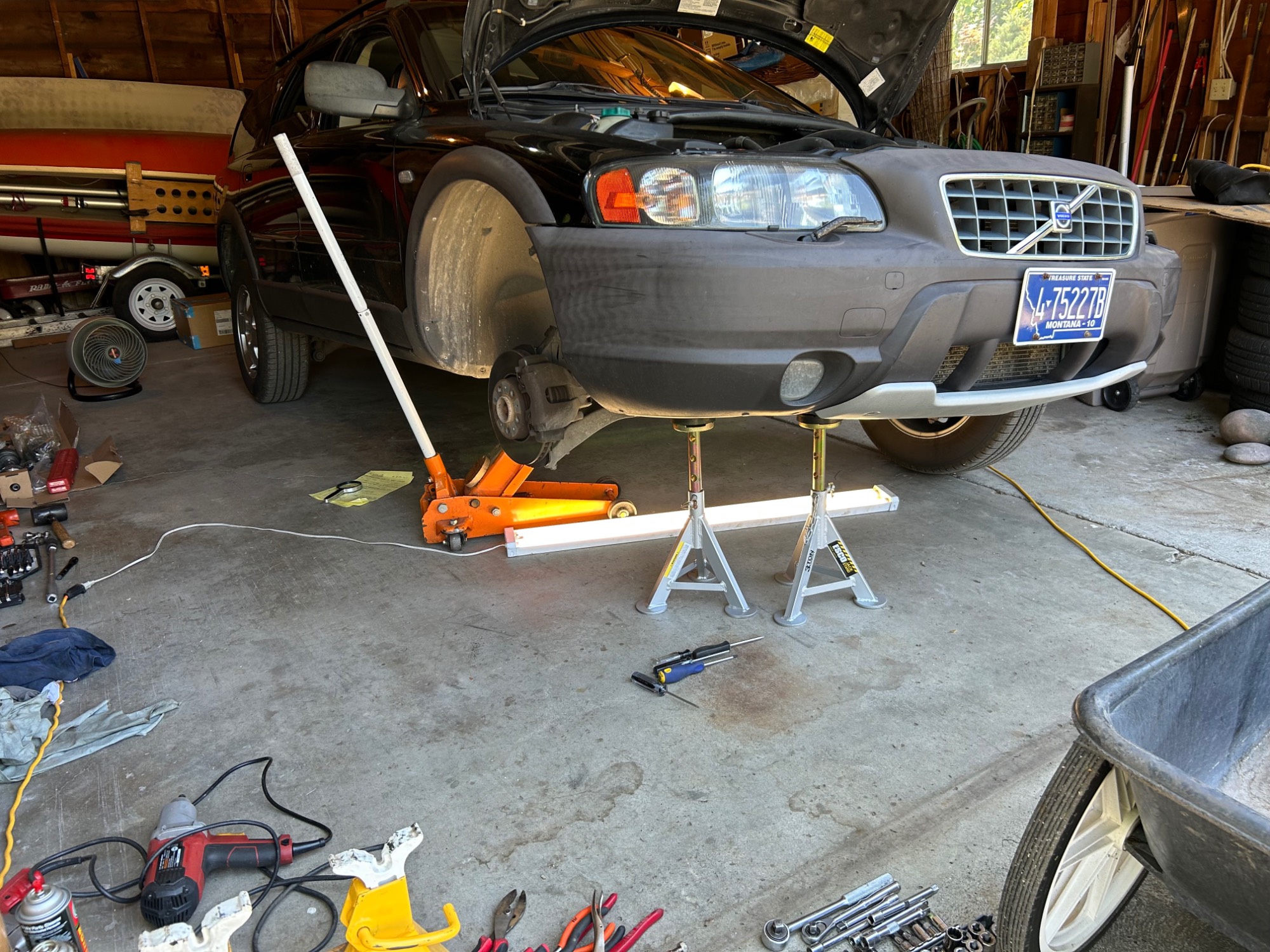

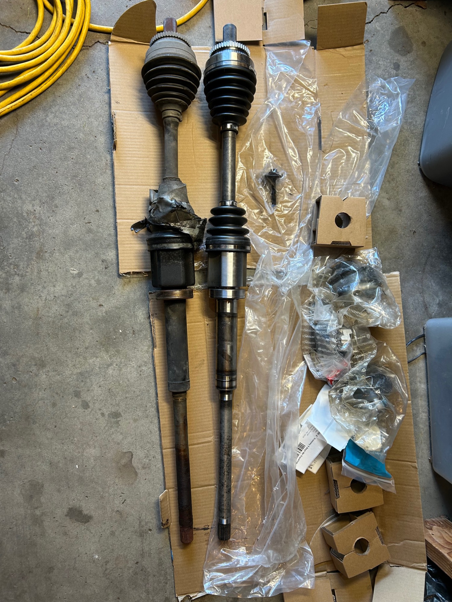

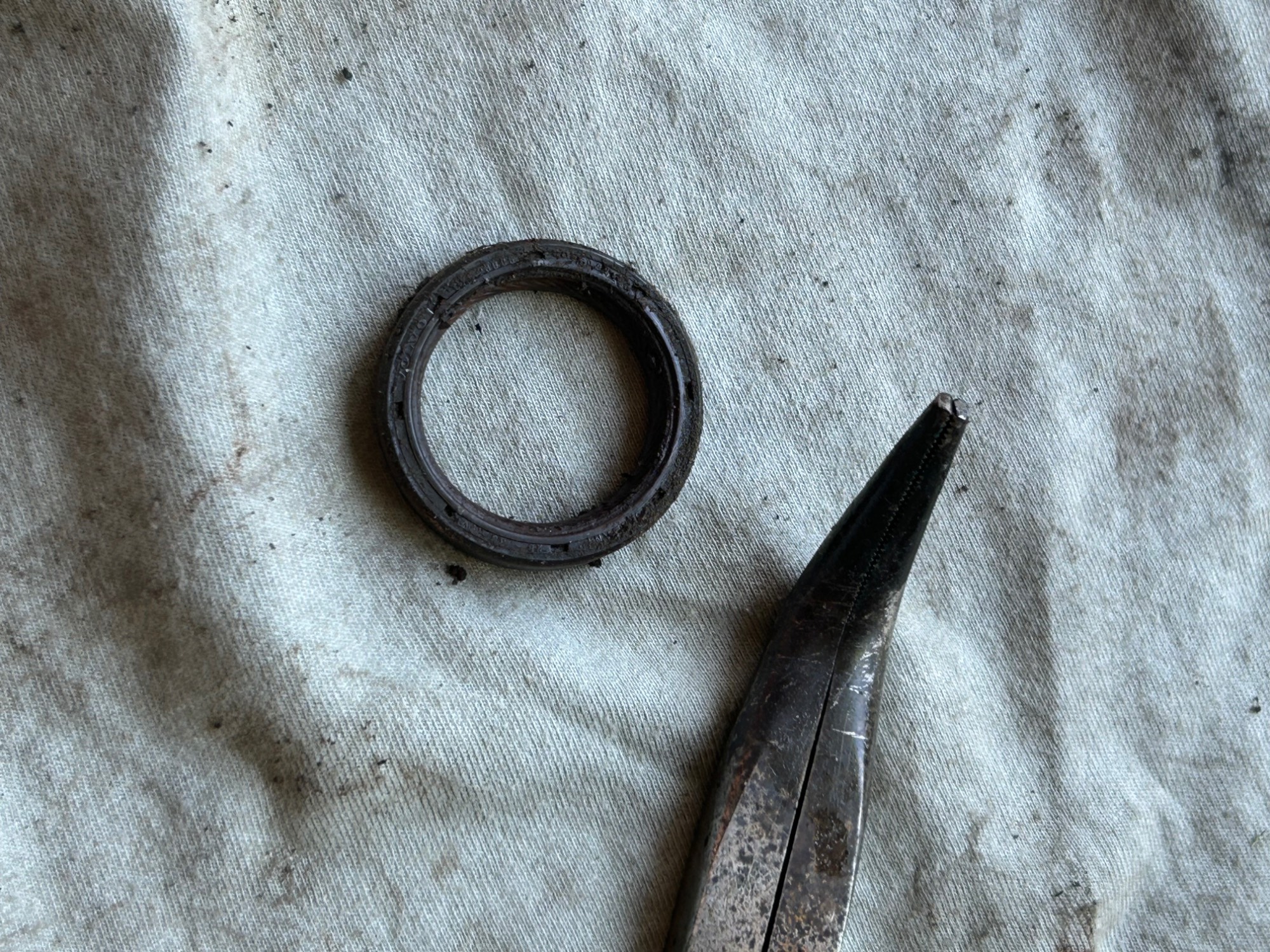

Pulling the axle to replace - hoping to get to the subframe bushings and motor mounts next.

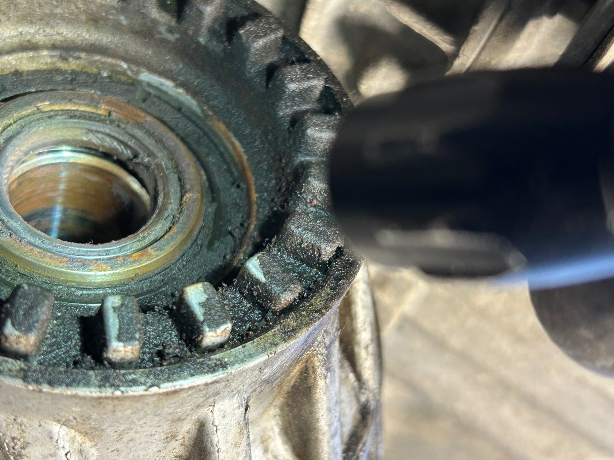

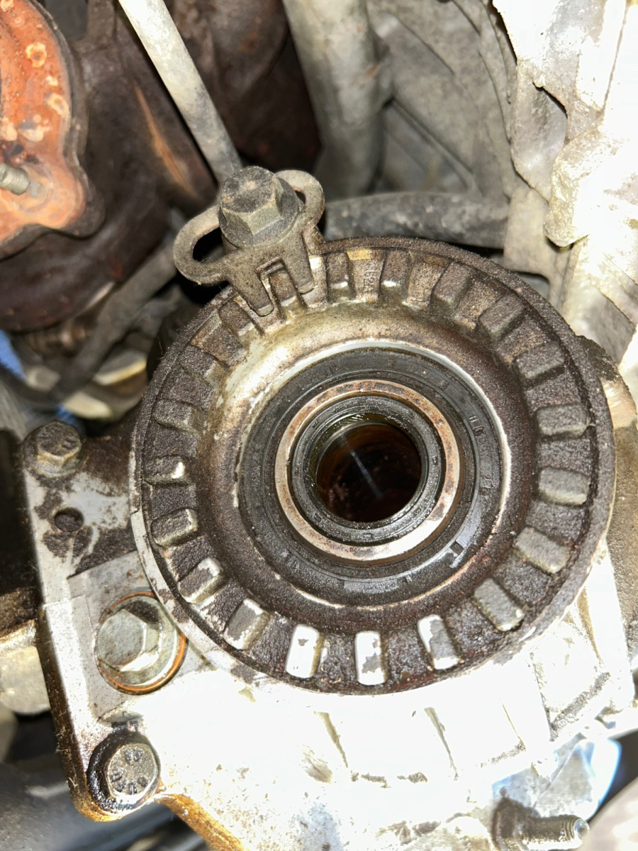

Advice on the seal? I did some light scraping with a pick.
Axle shaft & seal? (2004 XC70)

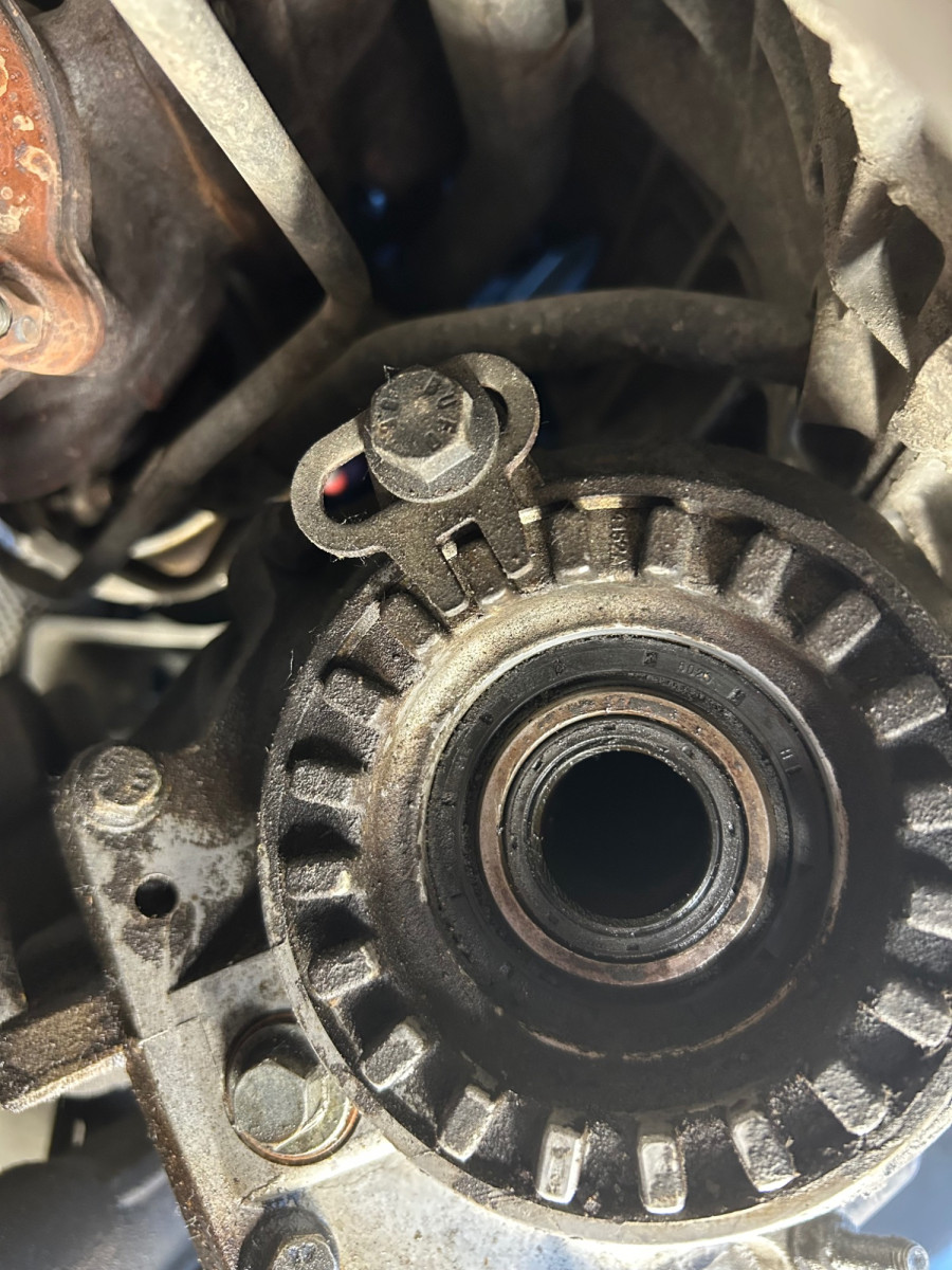

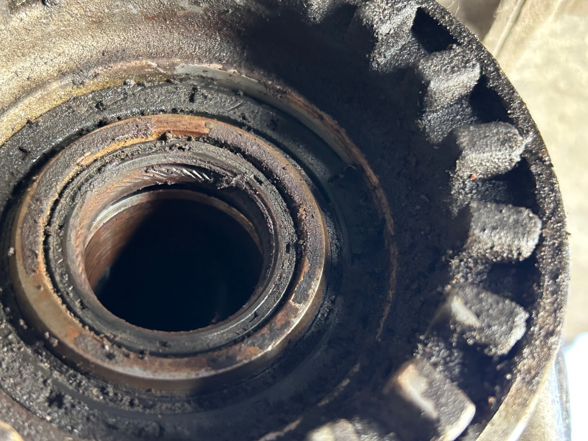

It doesn’t look bad, but it’s out.
Used a long bent needle nose and pried carefully behind it.
A 30mm deep socket seems about the right size to push it in with.

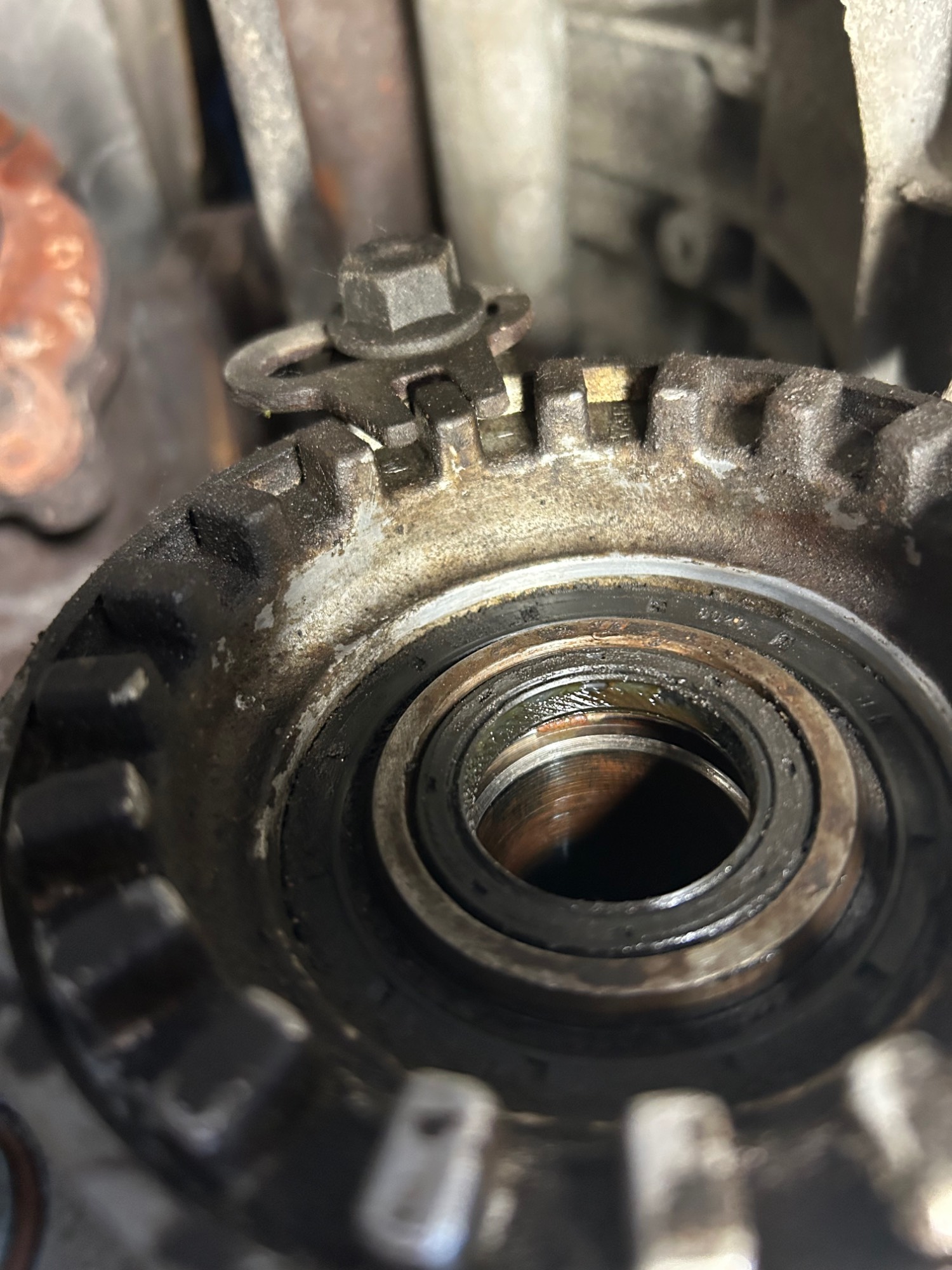

In.
The old one was just a hair in from flush, so I tried to match that.

That seal doesn't really do anything important, its just a dust/ water seal. Did you get the driver's axle out without a fight?

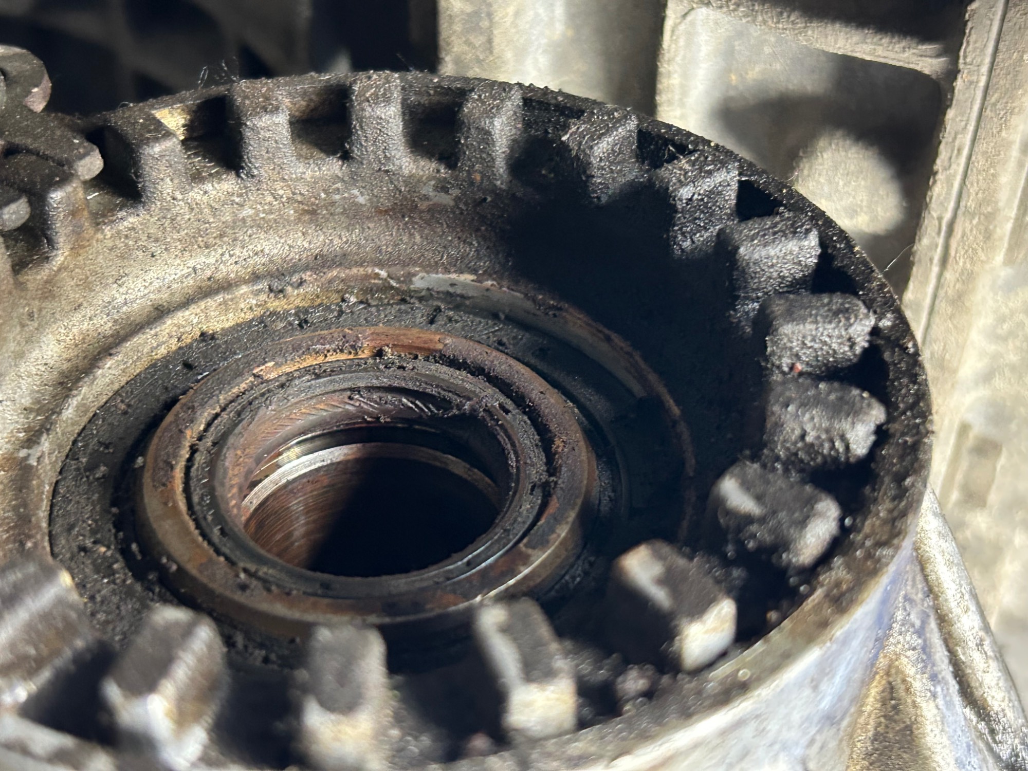

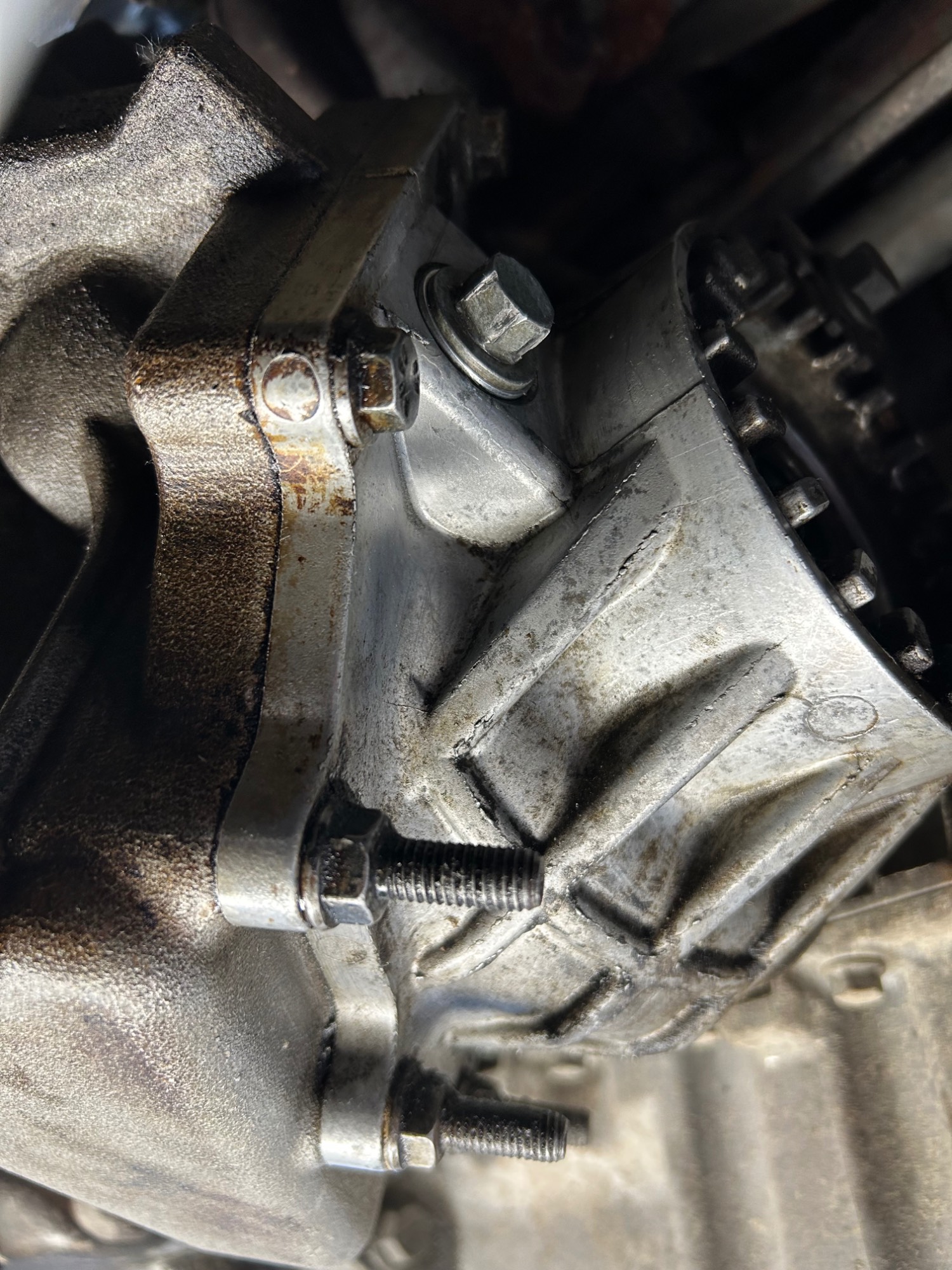

Seems like a good time to top up the angle gear, as the axle shaft isn’t in the way. My case is wet - could be seals? I tightened up the case bolts along the bottom - just a snug and most didn’t move much, I’ve nervous around aluminum.
I tried the filler plug next and it is NOT coming out. I used quite a lot of force including a dead blow mallet on a box end - started to mar the head. I’m not going to force it in aluminum.
So how much oil is in there…??

Yep, seemed surprisingly easy….uh oh..Blacklab467 wrote: 01 Jul 2025, 17:11 That seal doesn't really do anything important, its just a dust/ water seal. Did you get the driver's axle out without a fight?

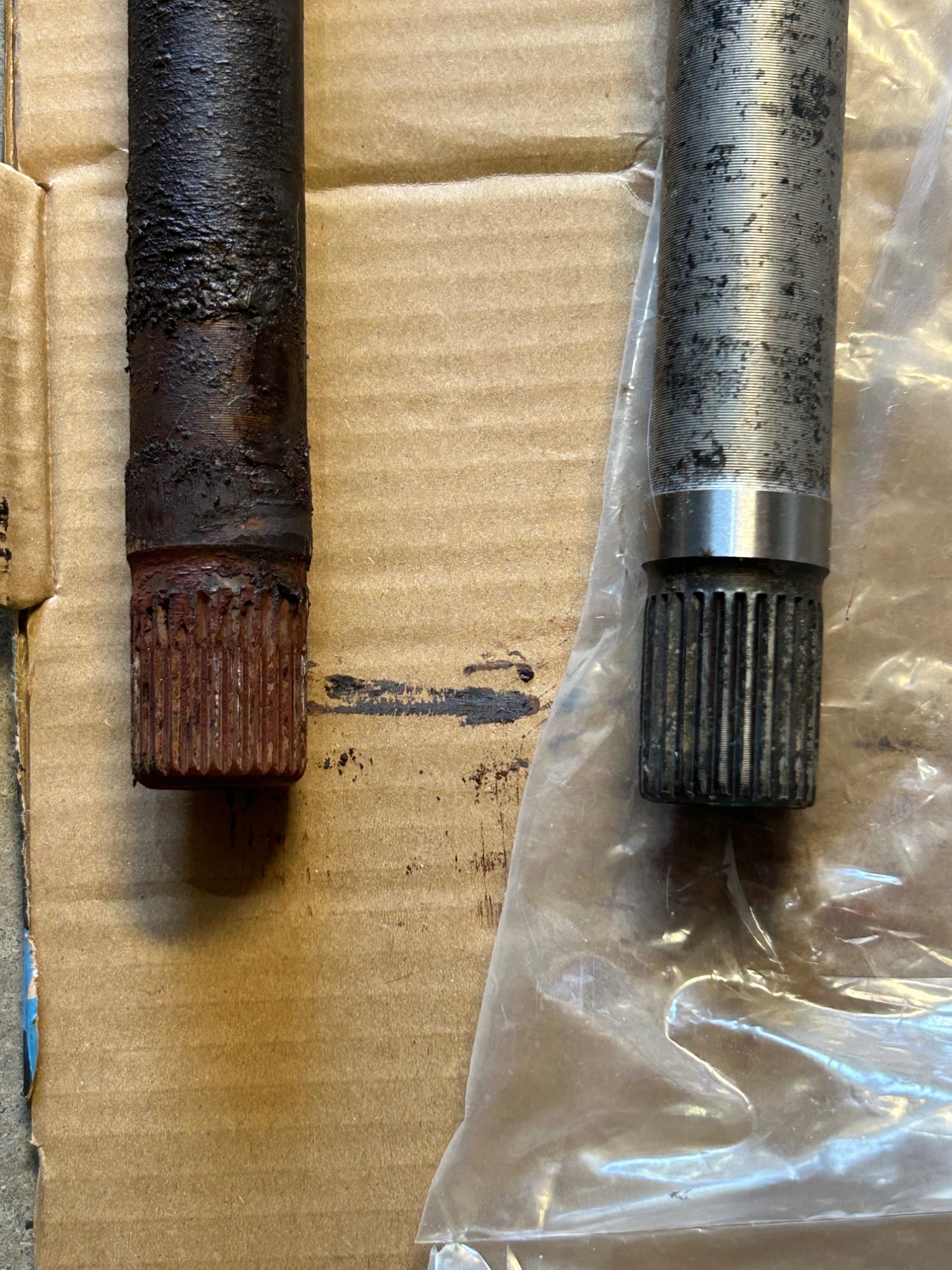

It holds about 800 ml as I recall and takes Volvo pn ; 31259380. They're usually pretty greasy so It'd be good to find out how much is in there, maybe try an impact or a half inch drive ratchet. The drain/ fill plug will be iron ant the aluminum threads on the Angle gear are coarse and large so I wouldn't be afraid to reef on it. Are those new axles GKN? If not, keep your old ones around.

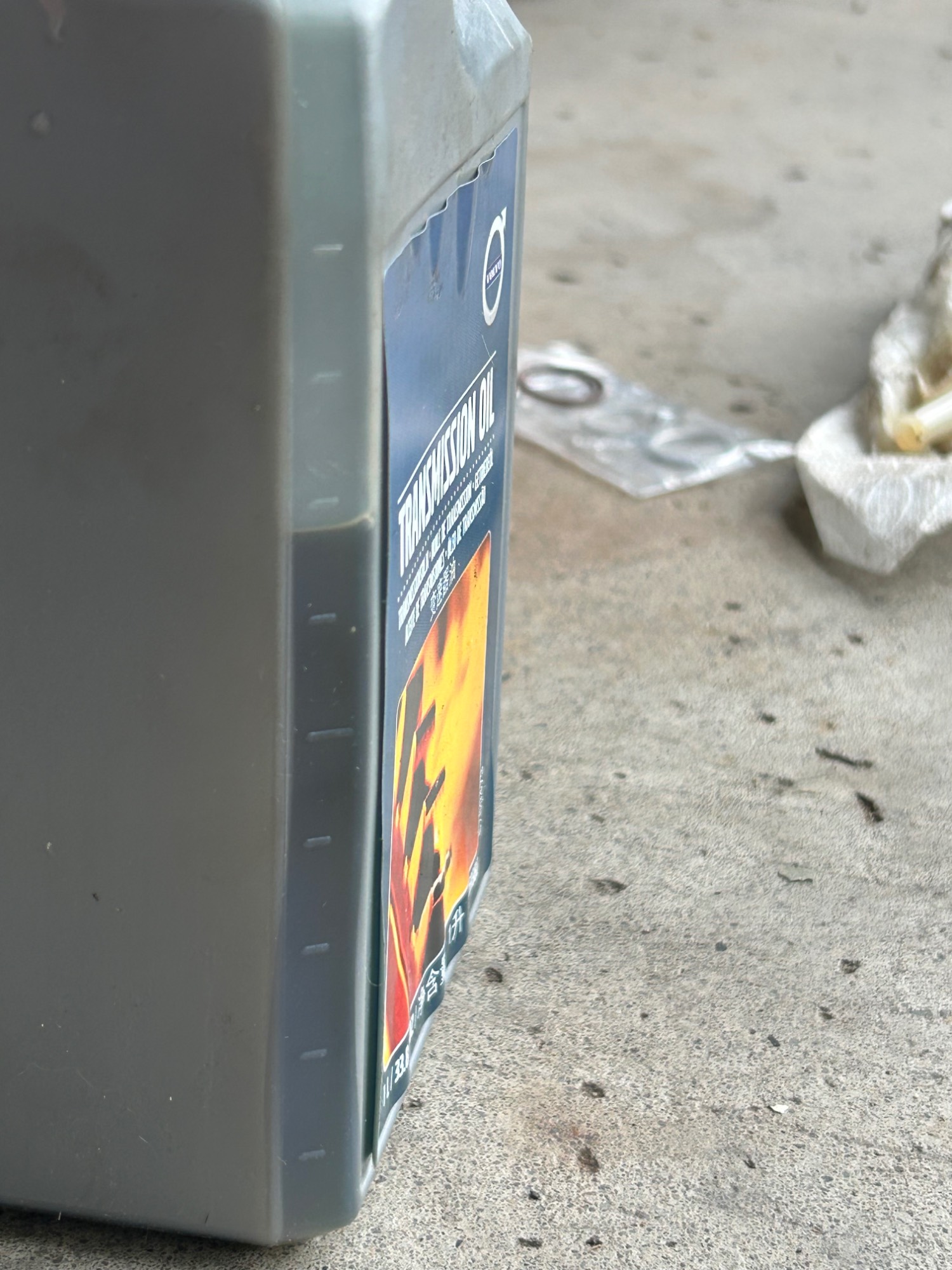

OK, big breaker bar on a tiny socket and my foot on the frame, it came out. Copper washer smashed by somebody.
I have the Volvo angle gear oil.
I used 3 basters full with my arm through the subframe like the axle would do. 2 ticks down on the bottle.
New aluminum crush washer.
Axle is new from 1A Auto - we’ll see.

I’m going home, I’m exhausted. Got everything supported and loose underneath, drilled out rear SF bushings - it’s way easier if you don’t grind the bit against the steel hole……
