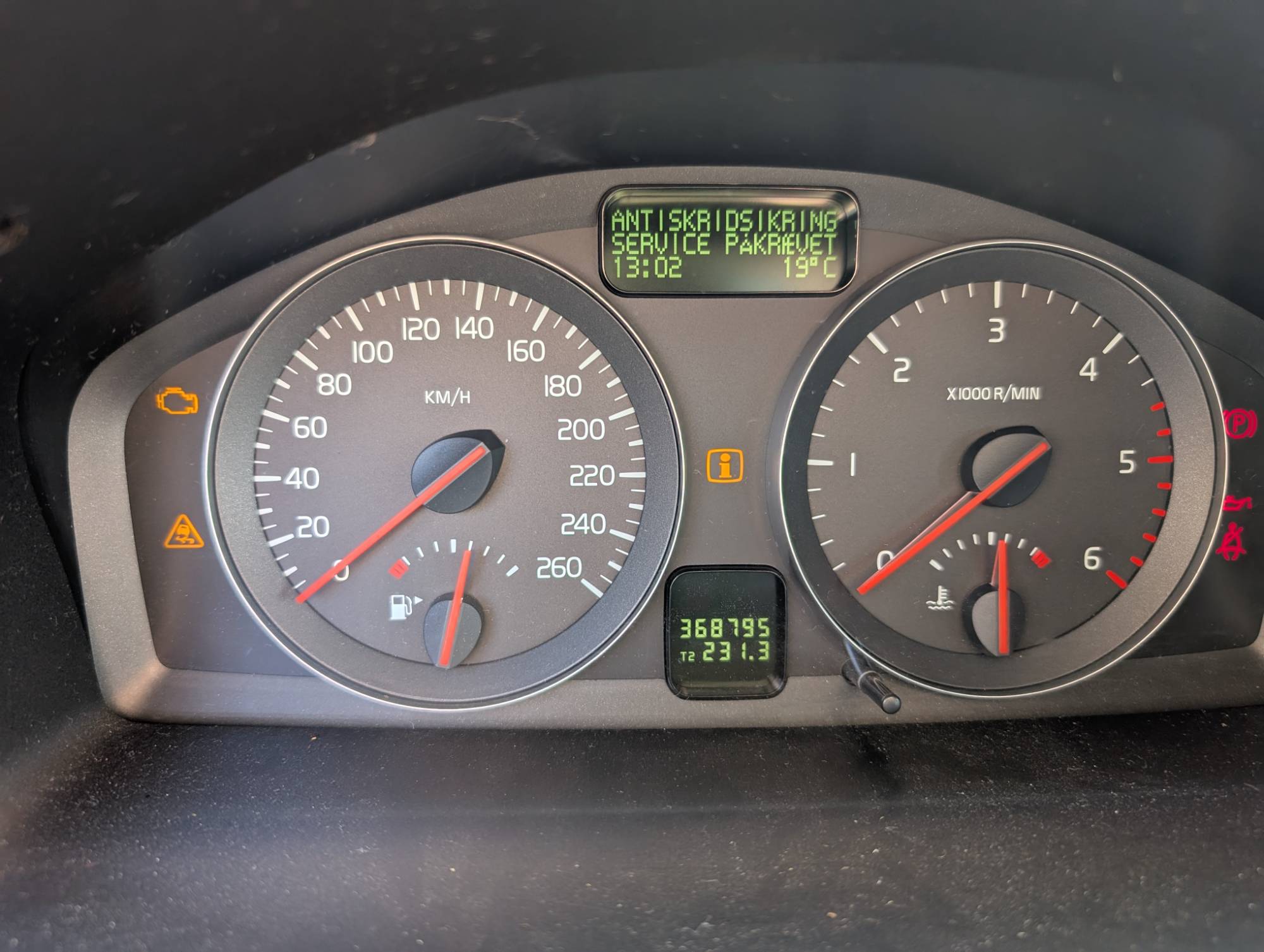

I completed the repair no issues and assembled everything then I suddenly got the "Antiskid service required" message
I went too a dealer and they said I had turned the steering wheel 360 degrees while it was off. They told me it might fix it just Turning it back but otherwise i would need a new clock spring. I turned it back didn't work. Ordered a new (used) clock spring and installed it. After installation the message switches between "service required" and "temporarily off" when it says temporarily off I can calibrate it with the whole turn left turn right drive straight. But the message keeps coming back sometimes after 15minutes other times the next day and sometimes it just switches from temporarily off too service required. But it always comes back as soon as I hit gravel road. Does anyone have a clue what's going on?

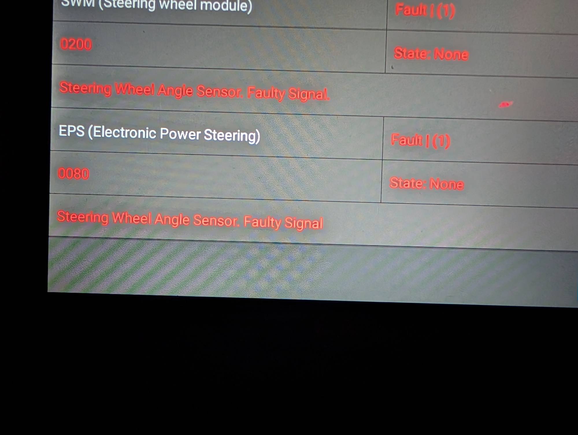

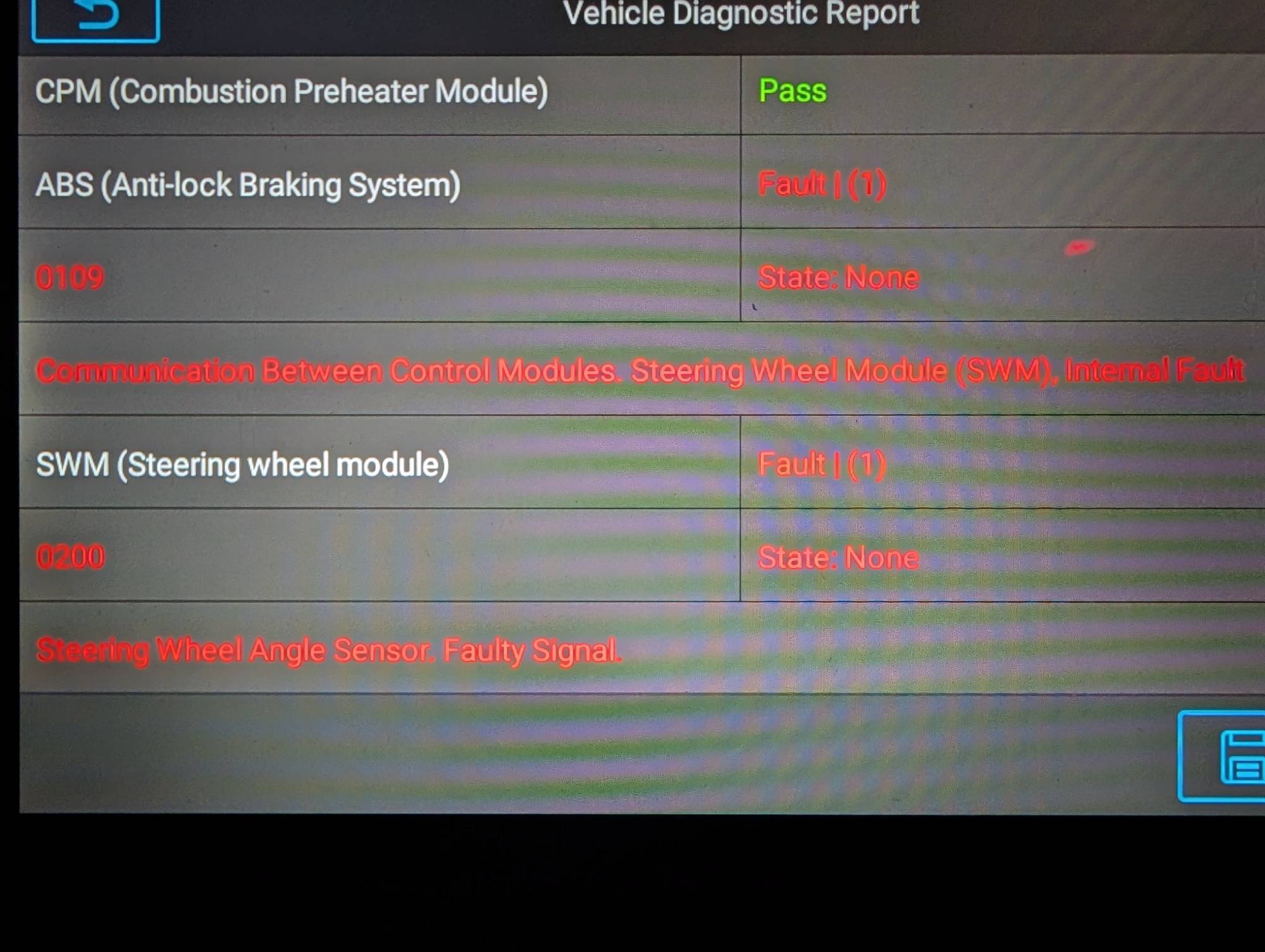

My obd reader is throwing the 3 codes you can see in the picture. I've also tried calibration via my OBD reader which only fixed it temporarily and came back again as soon as I hit gravel road.

ANTISKID SERVICE REQUIRED

I can't really think of anything you haven't done. Only thing I can think of there is a bad connection somewhere or you have not got the steering wheel calibrated correctly so it is on or near a limit. Are you sure it is the electrical system? You are showing an ABS error. If your ABS is not reading the speed signal correctly then it turns off the Anti-skid.
Check your ABS sensors are good and that the reluctor rings on the end of the axles are not corroded, cracked or dirty.
