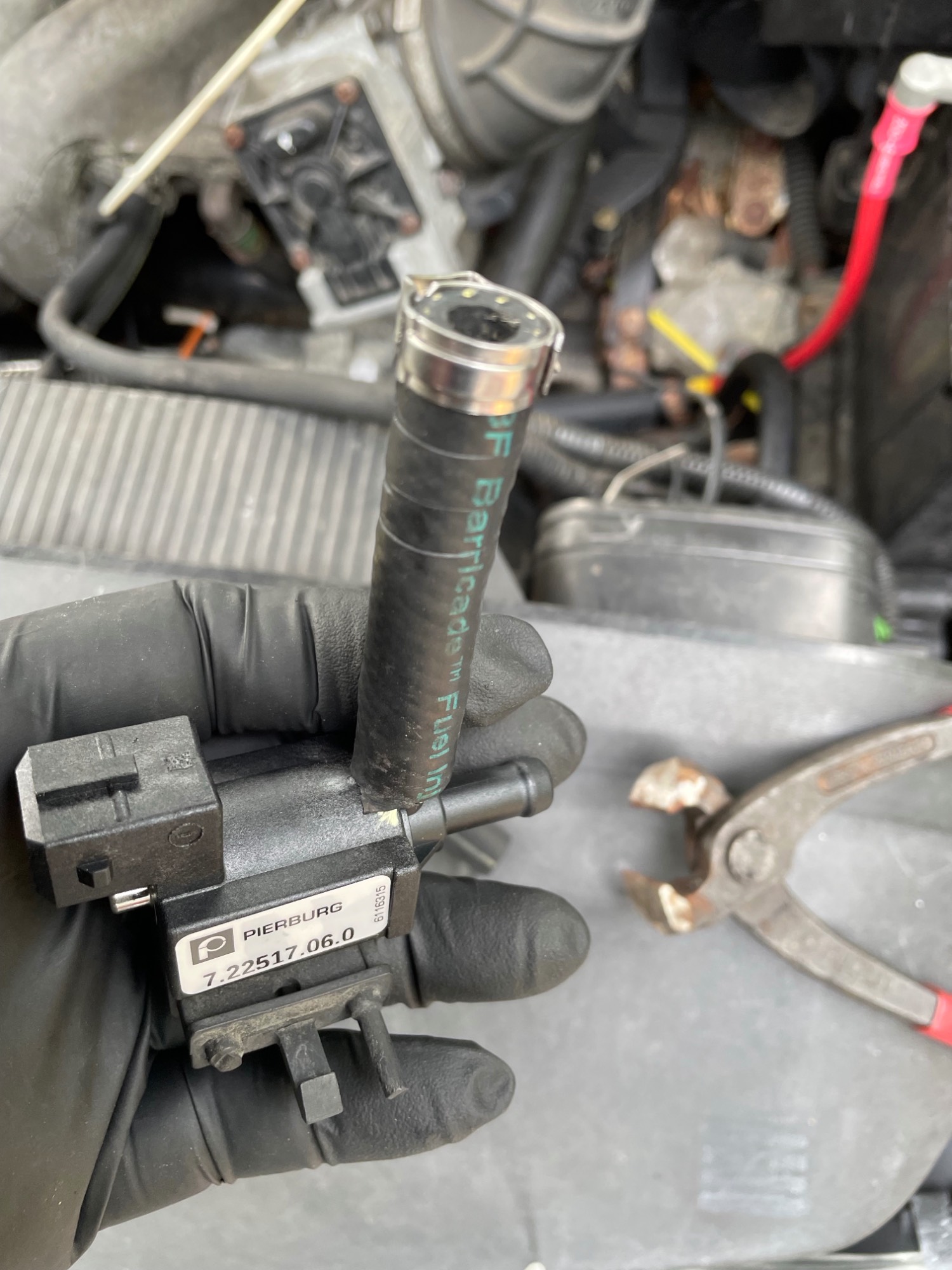

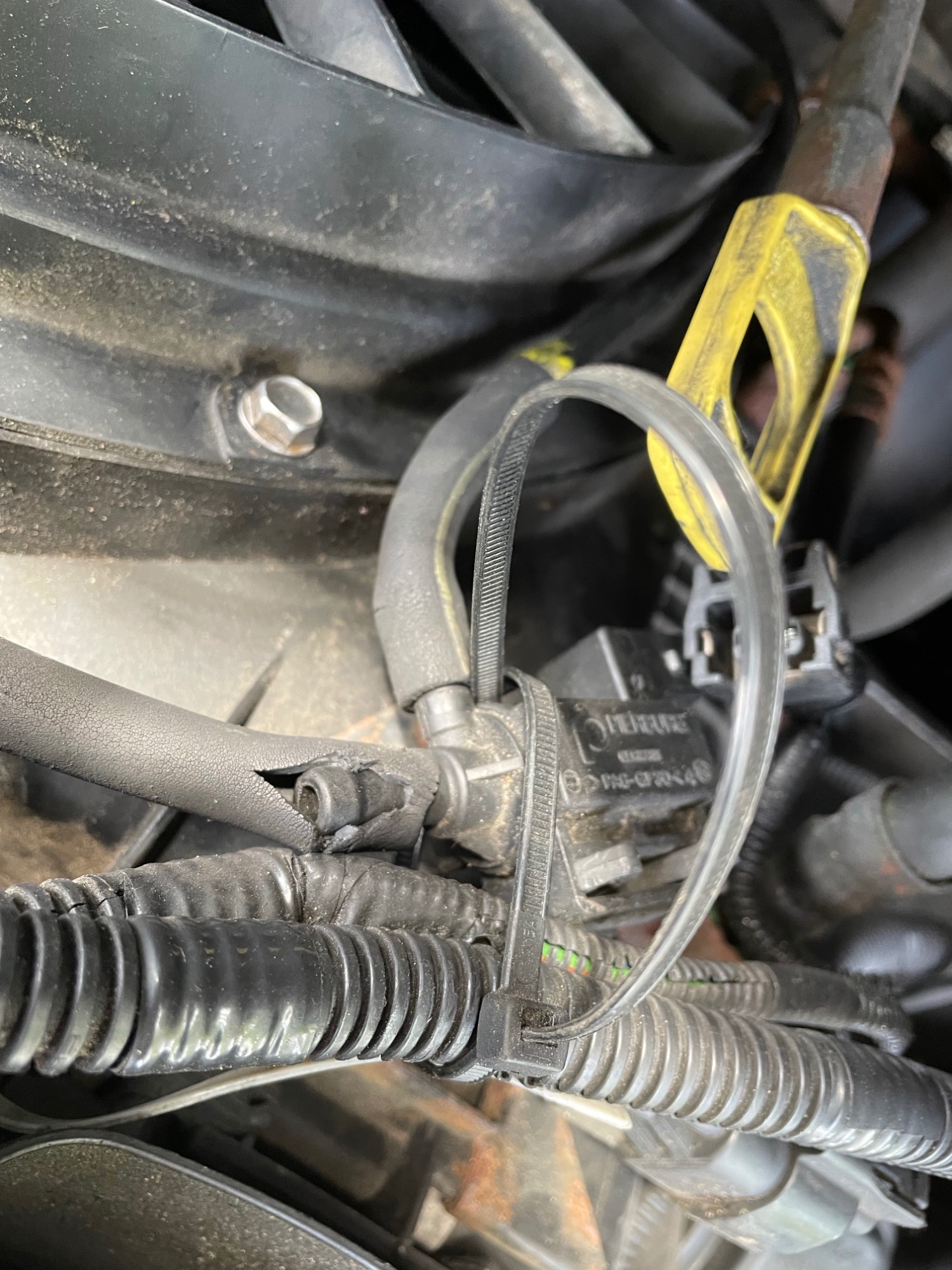

Purge valve hose inspection revealed this
In addition , removing purge valve and testing for glow showed is stuck open, it should be Normally closed with no voltage applied.
I used some J309 fuel line as a new piece and a tight Oetiker to get a lamp onthe hard purge line.
Note there is a VIN split or two part numbers for the purge valve on the 1998-9 so match parts to order.
All good!

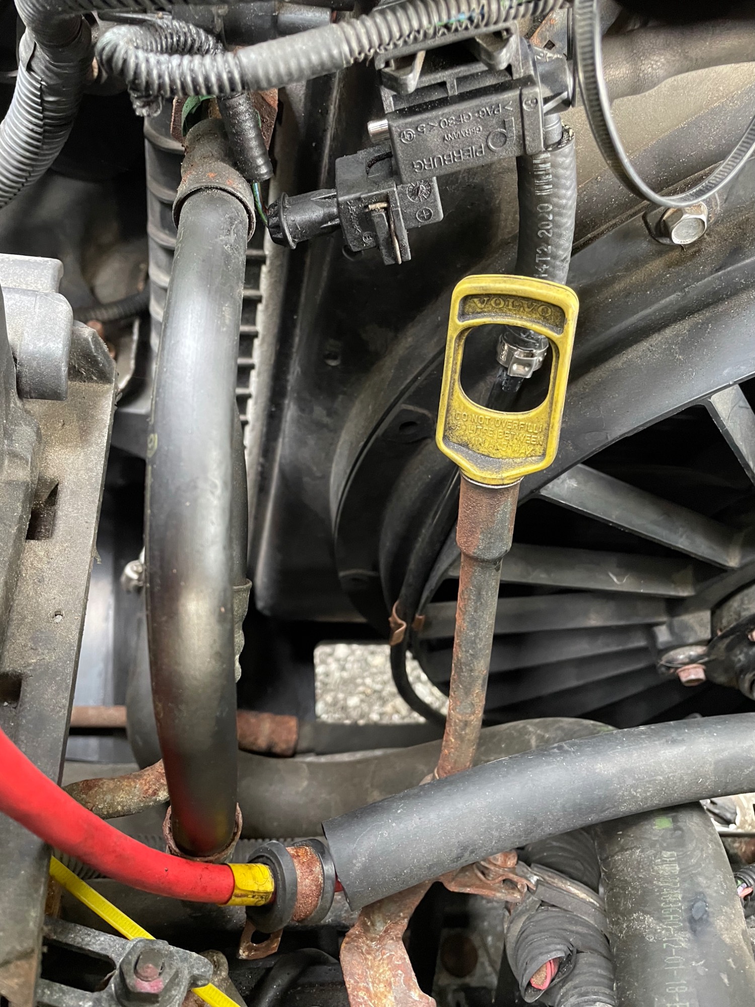

Hmmm, I’ve got to move that connector under the ATF line to protect those wires from chafe
