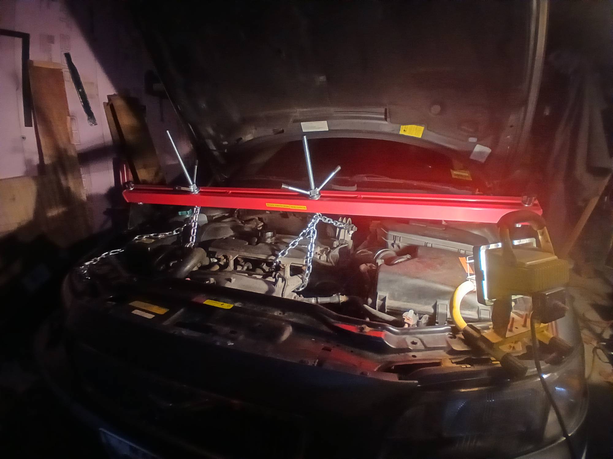

the slow leak is a flood so I got into it this afternoon, it took over 2 hours just to uncouple the steering shaft.
not enough room to open the driver door when the car is between the lift posts, I rolled it out and did it outside then rolled it back in the garage.with no steering. Disconnected the battery and got the engine support bar set up.
Can't see the rear motor mount looking down, where is it ? Do I need to pull the intake pipe from the turbo?
I'm beat and I haven't even loosened the wheel bolts yet.

Don’t need to disconnect anything on the turbo, you don’t even need to disconnect the steering coupler but it’s not a bad idea to avoid damage.. the rear motor mount is visible from below and is attached with a 13 or 14 mm, also remove the passenger side mount and rear subframe bolts and the passenger side wheel. The idea is to increase the space between the engine and rear subframe to maneuver the pressure line out and into place. To do this, you’ll likely have to lower the subframe a couple inches while simultaneously lifting the engine with a small jack on the oilpan. Create lots of space to make the job easier, if it’s your first time, take pictures of the routing of the line before you take it off/ out. If you’re alone it will probably take you all day but it is doable. Good luck.

13 mm socket on a long extension, behind the sway bar. Only 1/4" extension fits as is, but you can push the sway bar with crowbar upwards and make space for 3/8" extension.

vtl wrote: 11 Nov 2025, 07:14 13 mm socket on a long extension, behind the sway bar. Only 1/4" extension fits as is, but you can push the sway bar with crowbar upwards and make space for 3/8" extension.
That is what I did exactly.
from below?
I thought the top fastener of the rear motor mount has to be removed first.

jonesg wrote: 11 Nov 2025, 10:28 from below?
The rear engine pad sits on the rack. You remove the lower bolt.

Do I loosen the rack at any point or does the rack come down with the subframe.
Do you feed the ext past the sway bar first then put the socket on,?

jonesg wrote: 11 Nov 2025, 13:16 Do I loosen the rack at any point or does the rack come down with the subframe.
Unbolt the intermediate shaft (between steering rack and steering column) if not done already.
jonesg wrote: 11 Nov 2025, 13:16 Do you feed the ext past the sway bar first then put the socket on,?
Yes.

yes, steering shaft is disconnected.
Alright, I just need to use a better light, headlights don't always shine where I need to see.
