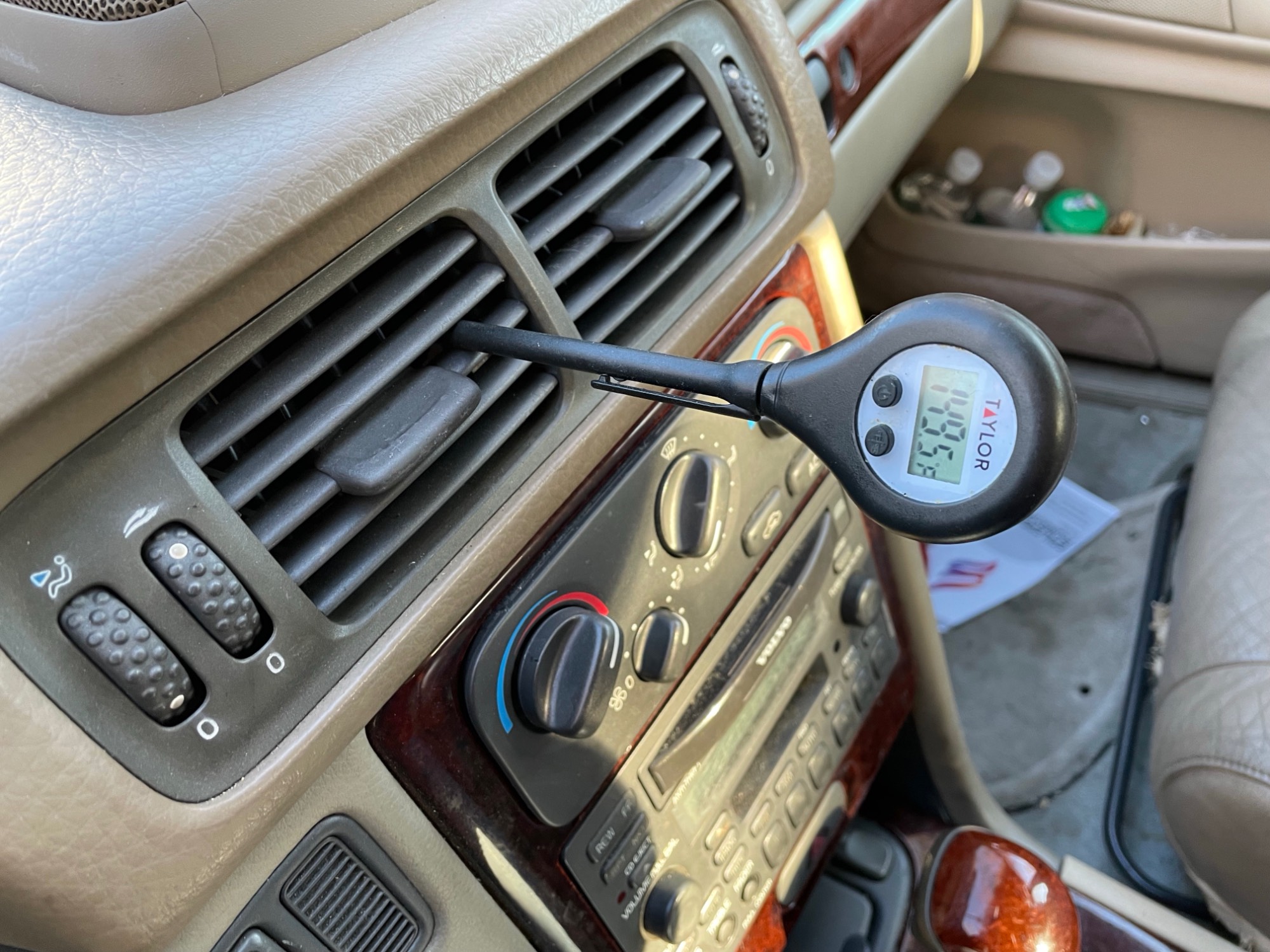

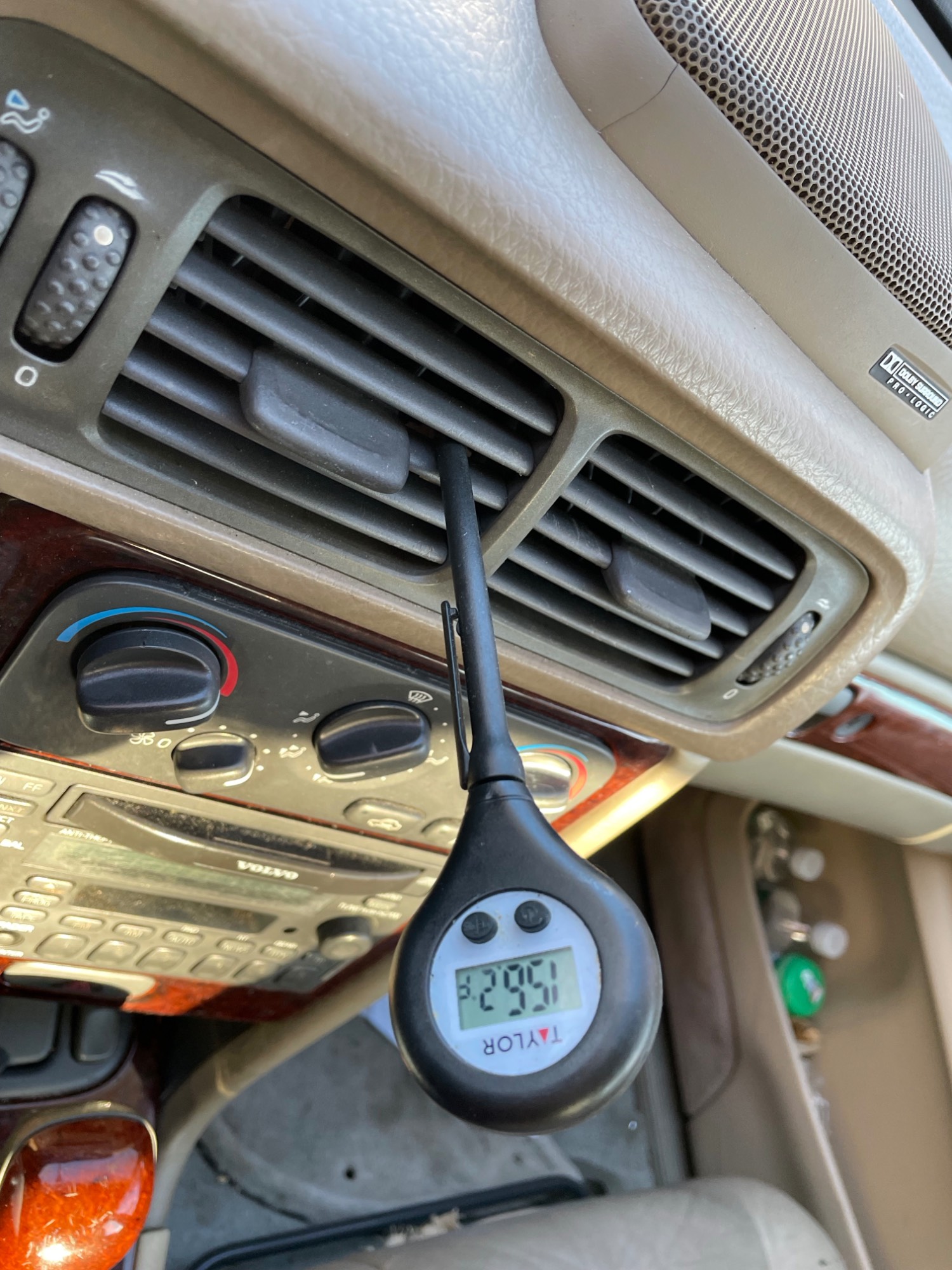

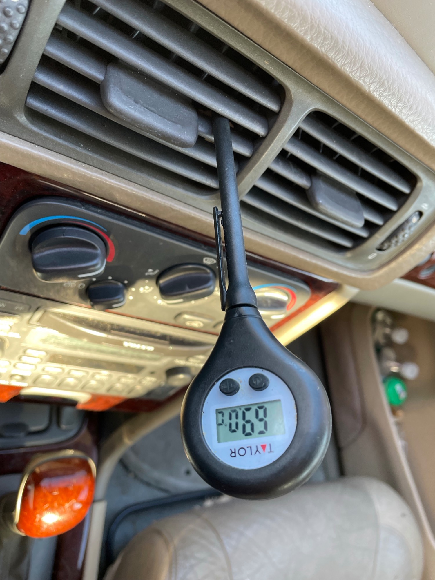

New Nissens heater core on a 1999 s70
Outside 40F
Fresh coolant
90C thermostat stable at ect reporting 90C
On fan speed 3-4 reporting 150F at dash vents on fresh air steady state
P80 heater temperature data
