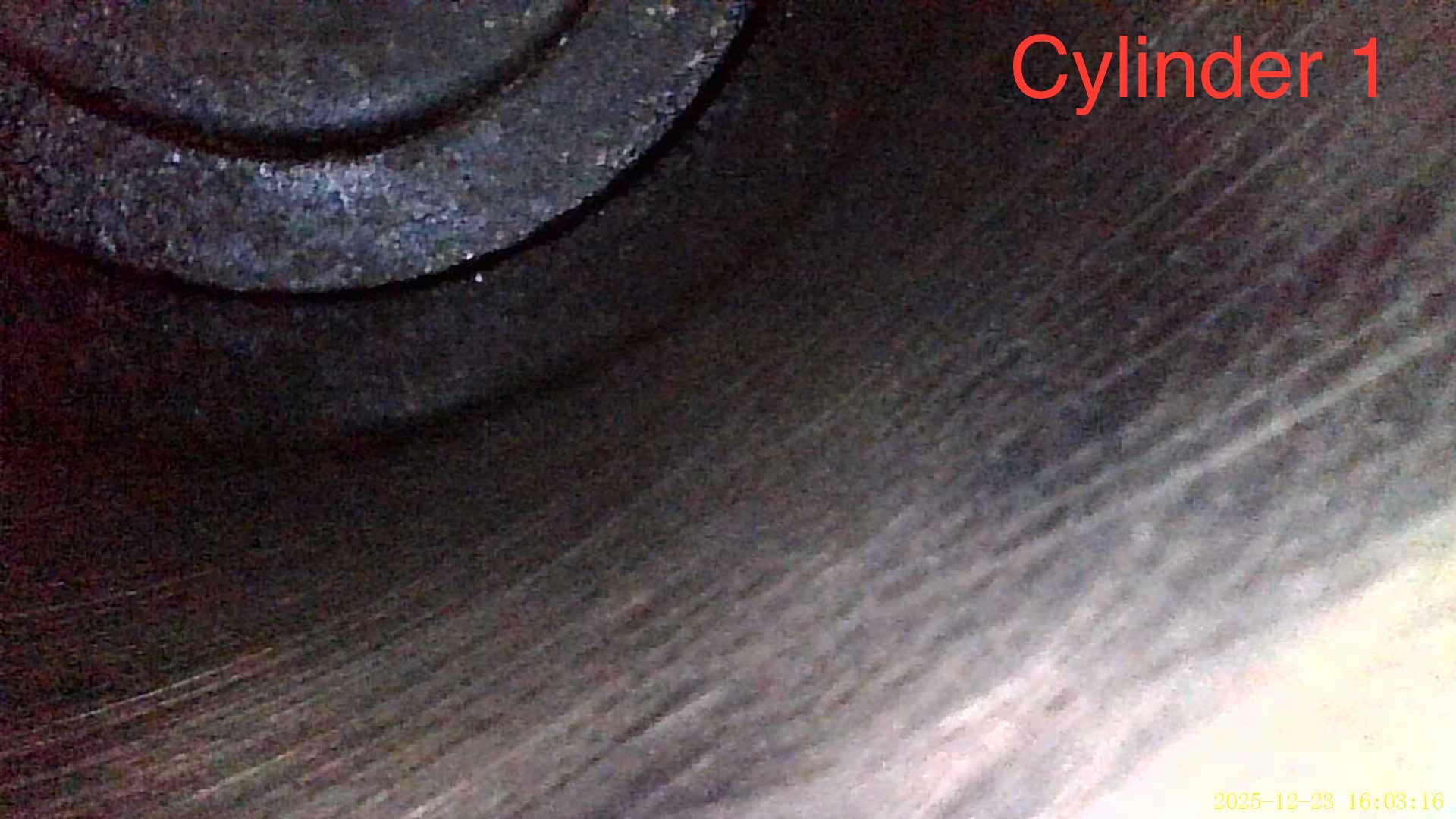

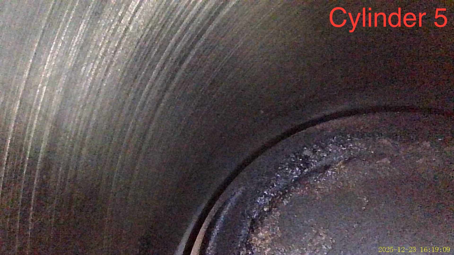

Bought a budget boroscope to check the cylinders out.
The car burns oil, especially at stop lights and long idle.
Compression is evenly across all cylinders. I don’t have a compressor to perform a leak test.
Any guesses on the pictures if a valve stem seal job is enough?
The car has 450k km currently. I drive less that 7500km a year.
How are my cylinders looking?

Those cylinders look beautiful. New seals and you should be good to go.

Yes, good cross hatch honing pattern.

Agree as well. As already mentioned, new valve stem seals are needed.

I’ll put the valve stem seals Ann’s tools on my to buy list for the next round of repairs. Unless it doesn’t pass emission tests that’s soon to be due.

Buy the stem seals in the kit, not by the piece. Since you live in the Health Care side of the Atlantic , you can get them from Skandix.de pretty cheaply
The kit has both the seals and the little protective nipples if you choose the sadistic path of doing the stem seals with the head on
