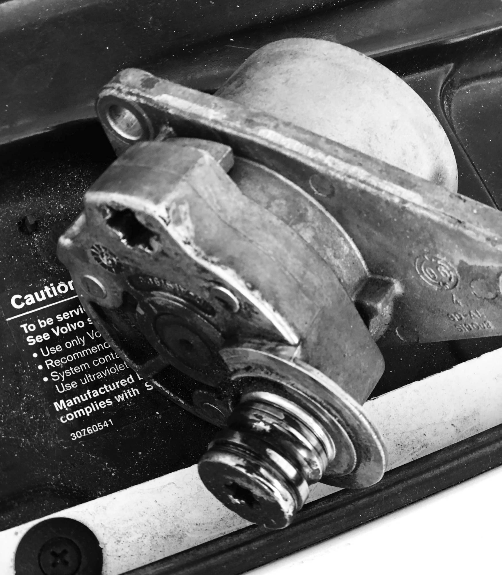

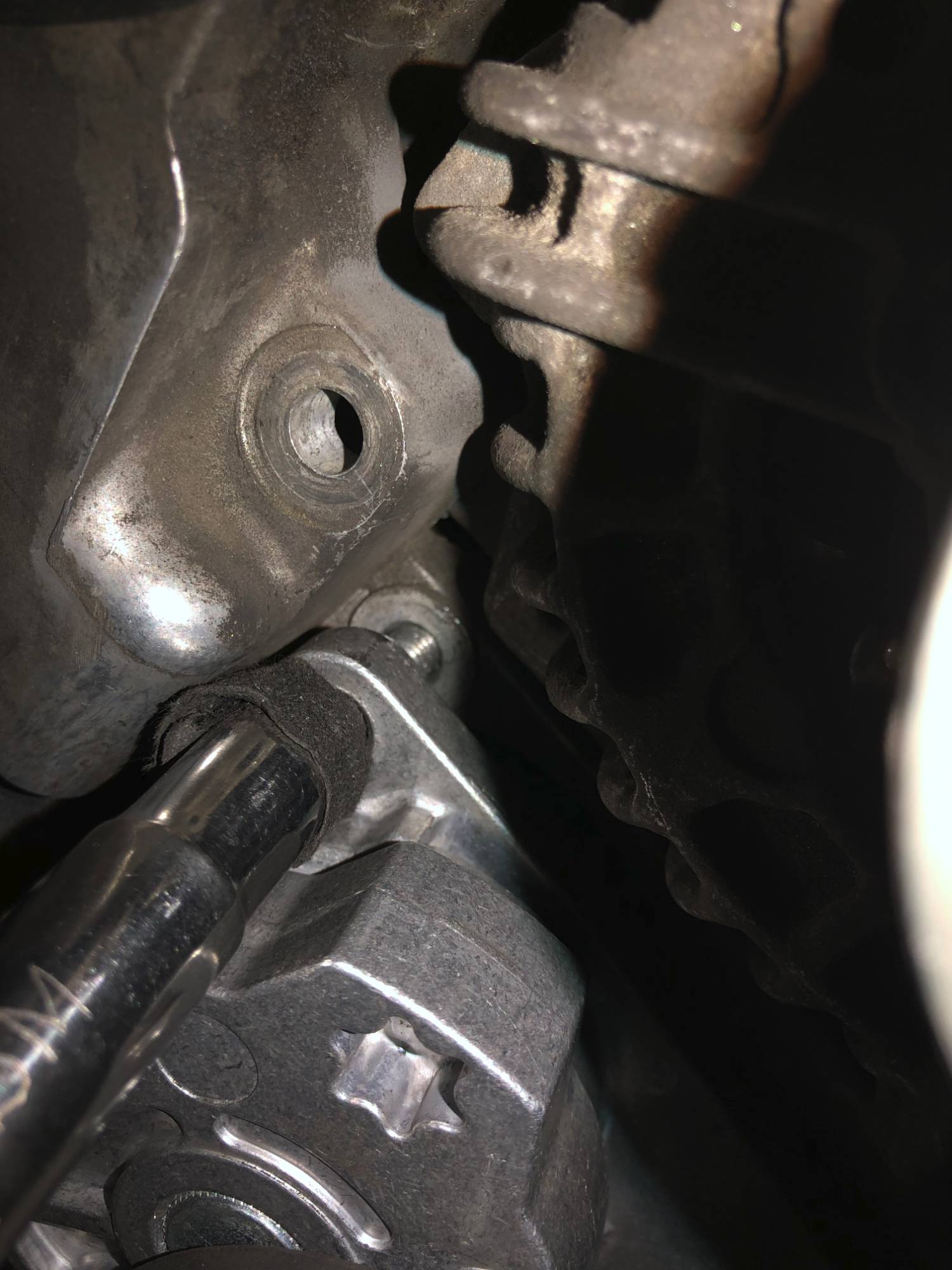

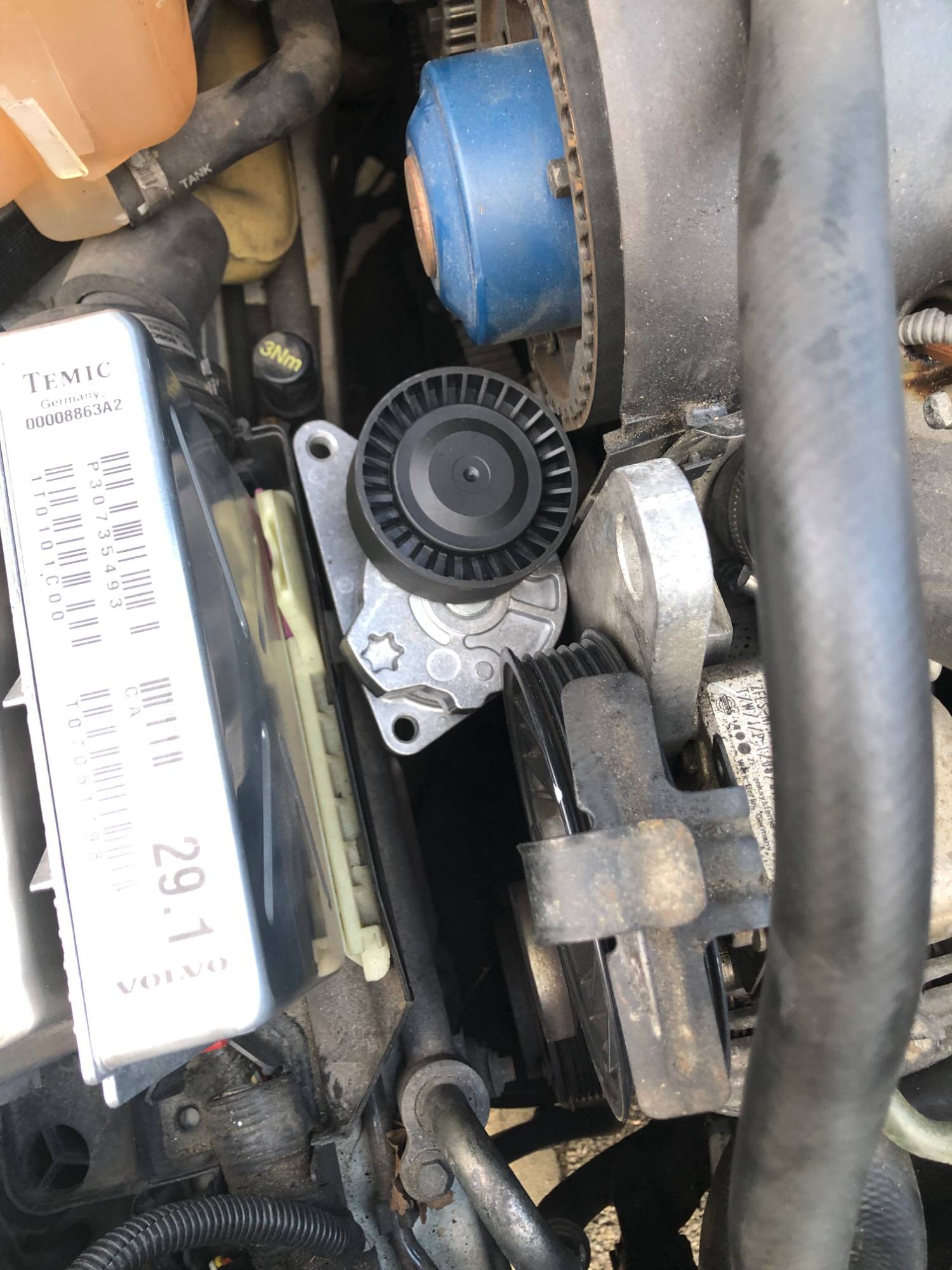

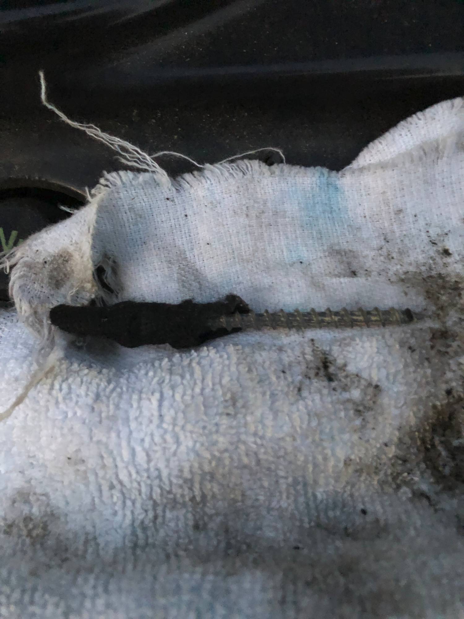

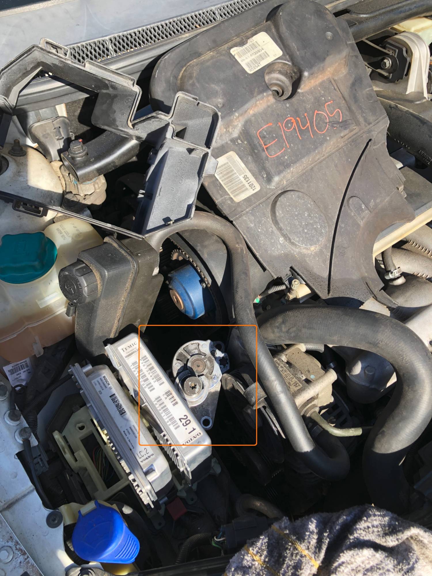

So I took a look today while the weather was good and sunny. Many questions I had were answered as I removed things. Took an hour but I managed to get the broken tensioner out from the top. Not sure I will be able to put it back from the top as the area is super tight and the wheel and bearing will require more room.
I followed the FCP video besides removing the cover, case for the modules and timing cover to provide more room for my hands and the tensioner bolts. There are two bolts on the tensioner and one for the side timing cover and all are10mm. I found two debris from the wheel and bearing that came apart. Would have to remove the splash guard to see if anything else is lodged down there.

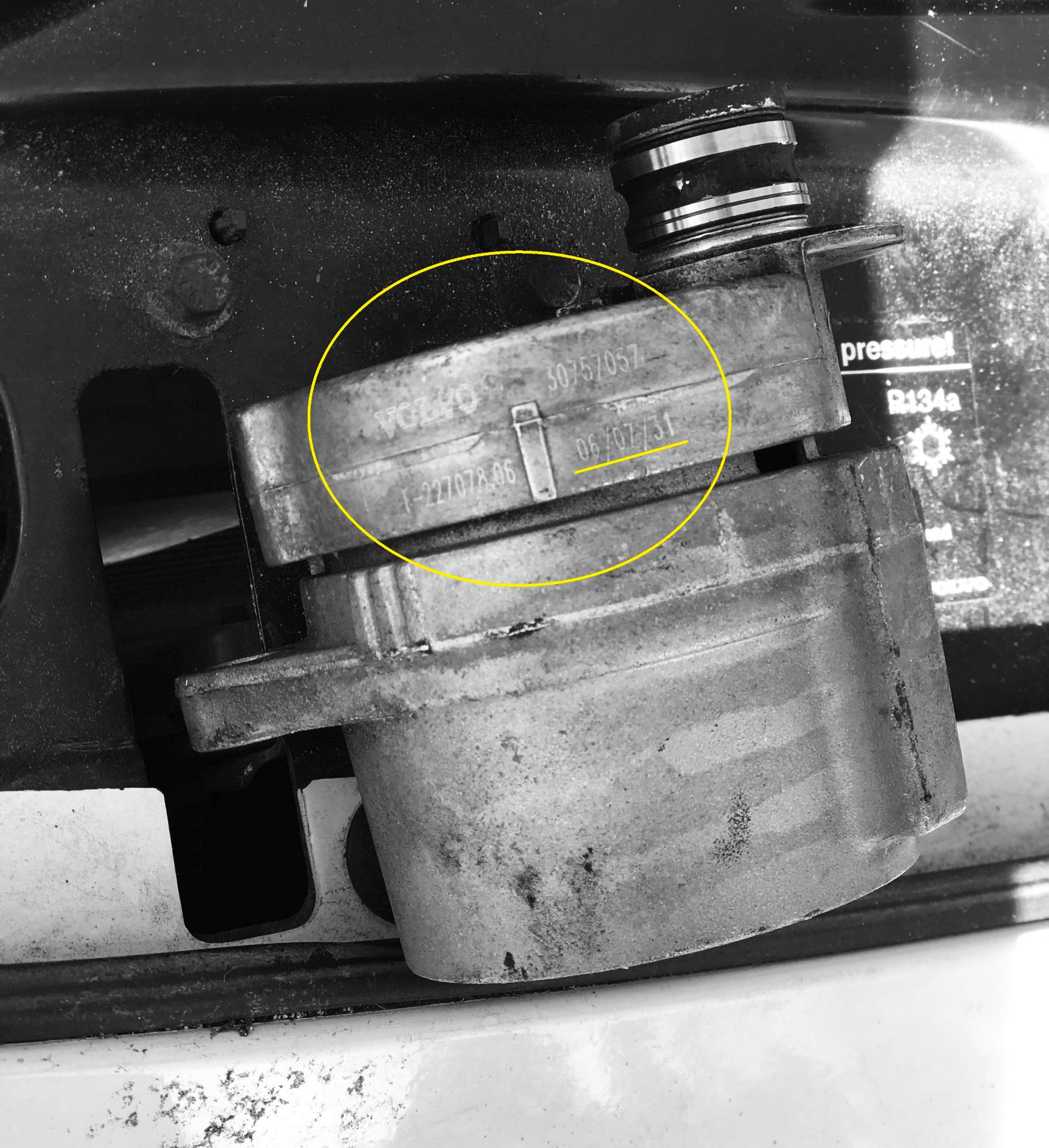

1) OE Volvo Tensioner 06/07/31 so probably 7/31/2006.
2) Wheel n Bearing Gone
3) Tensioner Removal

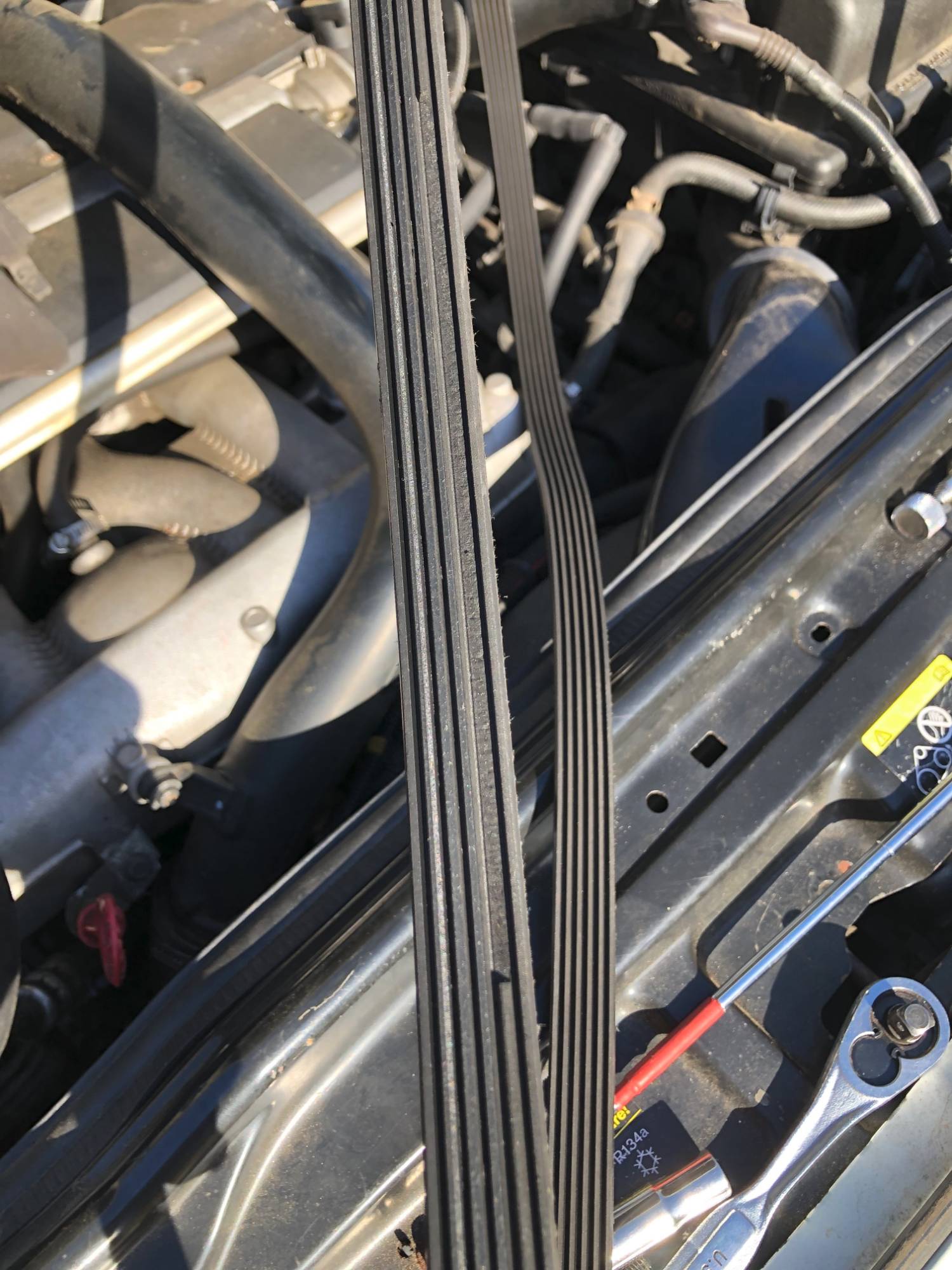

4) Belt Damage But Didn't Come Off Even Without The Wheel n Bearing To Ride On. Still Driveable w/Hard Steering

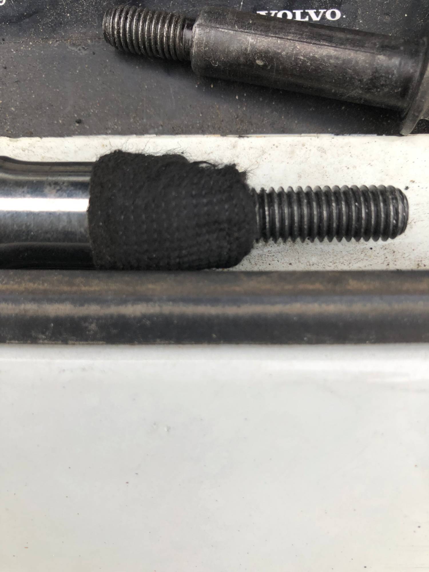

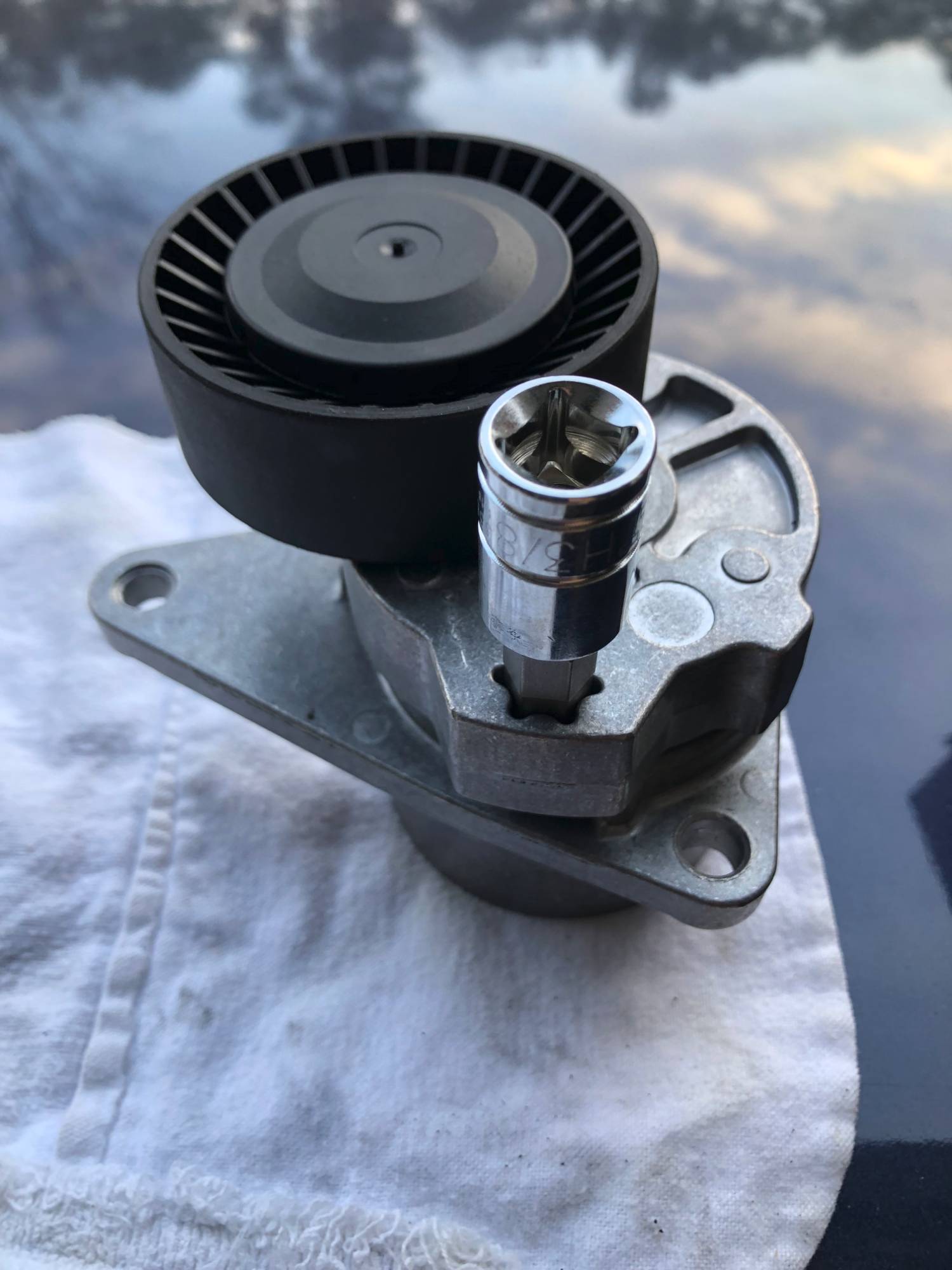

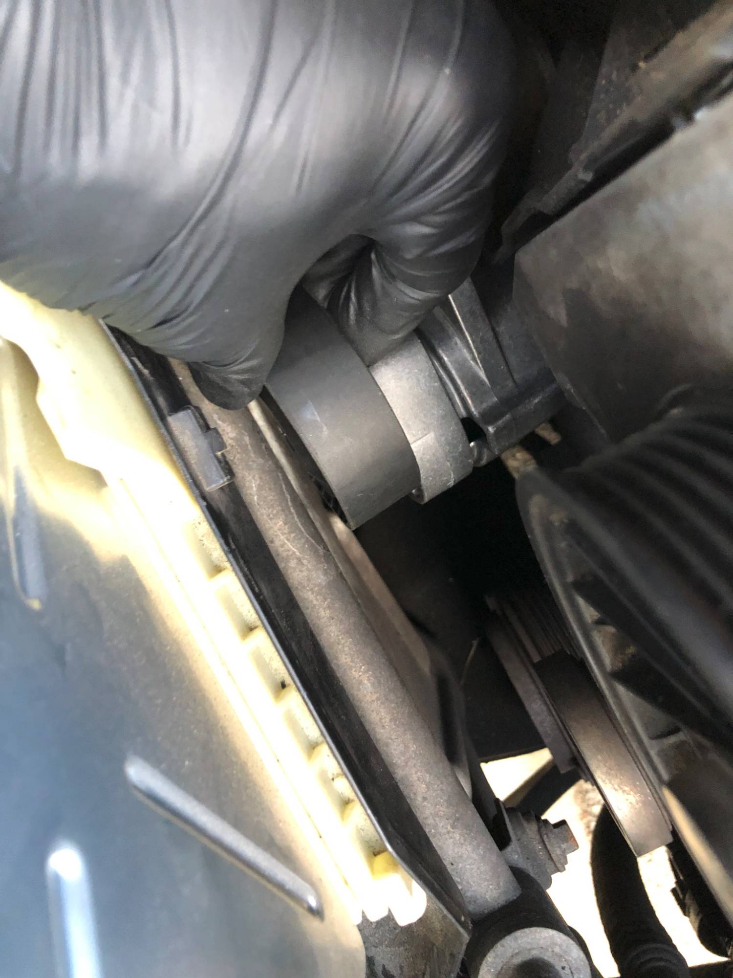

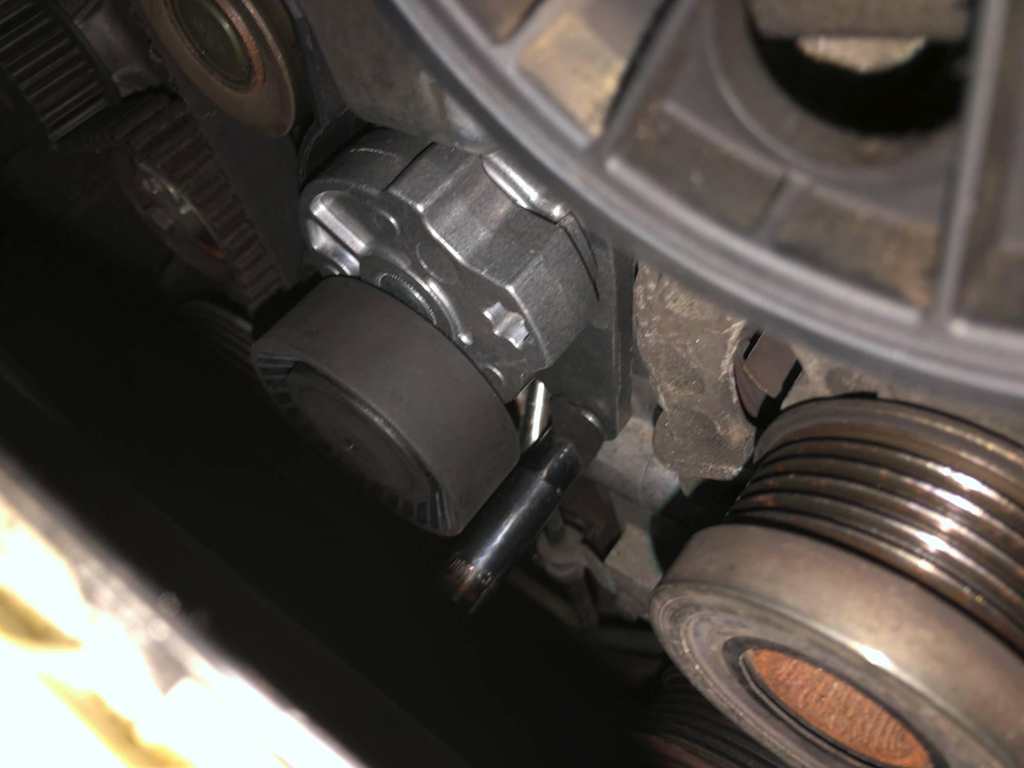

The new tensioner can go in from the top. If you don't have a T60 Torx Bit for the tension adjuster, I think that's the OE size, a H3/8 Hex Head Socket should work. Will confirm when the belt is installed in the next couple of days. Suggest to lay a light color towel on the bottom to catch the bolt, socket or tool if you drop them like I did. Next, wrap a 3" sheetrock screw with some self sticking felt harness tape for the lower hole as a guide. Make sure it's snug enough so it doesn't go through the tensioner hole. Use the same tape for the socket and bolt. Secure the upper bolt first then the lower.
