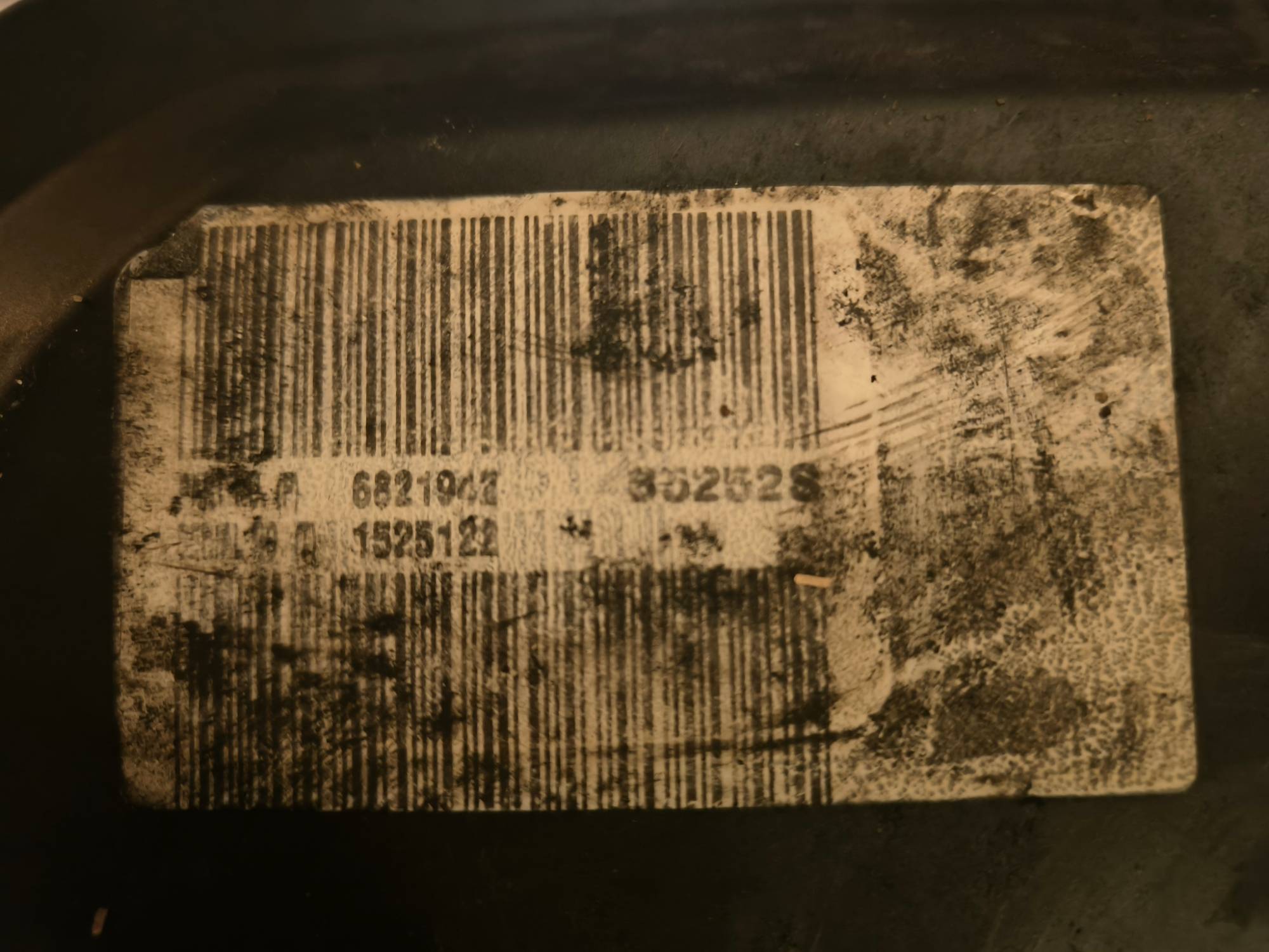

You are on the transition months between hydraulic and mechanical tensioners. What is your engine number , either on the sticker or punched into the engine near the water pump?

Thanks for the reply! I made a picture of the upper timing belt cover. I think the engine code is 1525122.

Details on the engine number change from hydraulic to mechanical tensioner for the timing belt, courtesy of RickHaleParker
1998 S70/C70/V70/XC/R:
Hydraulic tensioner engine serial number --- 1266127.
Mechanical tensioner engine serial number 1266128

I am a bit at a loss... The last time a small shop changed the timing belt. A belt with 144 teeth was fitted. Even if I wanted, the 138 teeth belt does not fit, that is not even a maybe. I know some timing belts are really hard to fit around the sprockets and such, but this is a no no. I think the former mechanic faced the same issue. Any advice how to proceed?
