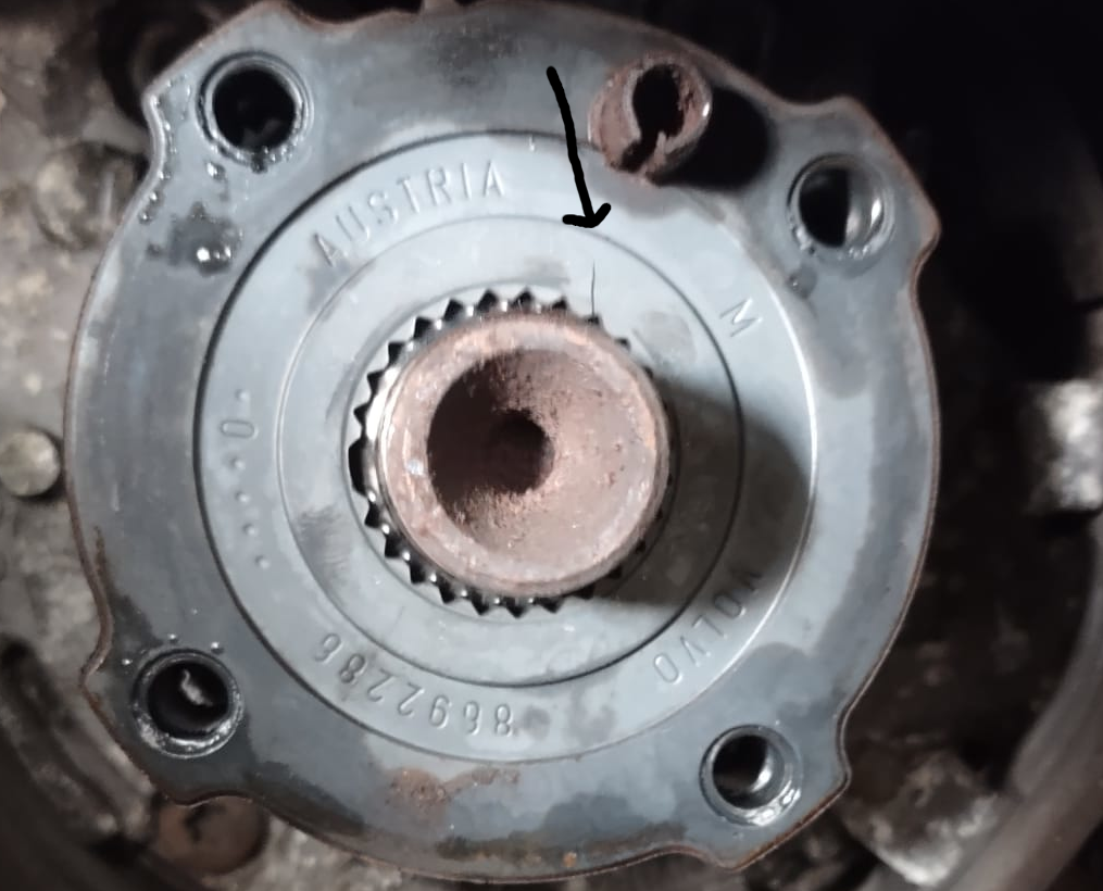

Hi Folks,
I hope all is well. Bit of an odd problem here: about time to change the timing belt and I stumbled upon a cracked crankshaft timing gear :shock: I have no idea how this could have happened as I've owned the car for more than a decade and never abused it.
I'm comfortable with timing belt changes but seeing as I have replace this gear, I may have to bite the bullet and get a cam/crank timing kit to keep the crank locked in place as I pull the old and re-press the new gear. I am well aware of CTA tools 2863 and I would also need the crankshaft pin, however these seem to be quite expensive (to the tune of $400!)
Has anyone had any good experience with the cheaper timing kits e.g. found on ebay/amazon or elsewhere? I am reading mixed reviews but would like to hear anyone's take here if possible.

As an aside, how consequential is that crack in the crank gear? I'd be interested to hear from those with actual engine/machine experience (though I'm sure armchair/internet quarterbacks will be eager to chime in!).

Thanks for the insight Erik! I had changed the timing belt back almost a decade ago, without any locking tools, and for other cars and was able to get by fine.
To your point, most of the complaints I heard were about the bolts in the kit being subpar. My eagerness to use the crank pin comes from whether I have to replace this crank gear; between using the proper puller and pressing the new one in with a rubber mallet, I don't want the crank to move at all.
At least the crank gear seems keyed, so there's only one way it goes in.
When I see that crack it concerns me that if it gets worse to the point where it breaks, I don't want to say goodbye to an otherwise perfectly good engine :roll:
But who knows, maybe I'm overthinking this

- Idk why you remove the pulley to do TB. No need to do that.
- Personally, I'd not worry about that tiny cracks. That is a solid piece of steel, so a bit of crack is inconsequential in my book. The load on that crank gear is light.

Swap the crankgear out, I only paid around $90 for mine.
I think you will find spline damage when it comes off, it might fight removal. I used a steering wheel puller.
No crank lock needed, zip it off and back on again with a bit of blue loctite.
I made my own timing marks rather than trying to see the tiny ticks on the gear.
Install belt before tightening the crank nut, it won't matter if it moves.

If the OP decides to replace the crank gear (PN 8692286), then time to replace the Front oil seal too. Corteco or Volvo brand.
But anyway, this crank gear is indestructible. Never heard of it being a problem in Volvo forum.

If this were my car, I'd put the belt pulley back on and that is it.

I’m struggling with that crack.
The load is spread out over the 26? Splines so any one spline sees very little load, but on the von side, the pulley is getting 2000 strikes per second of impact. That impact is damped by the pulley so the timing belt system doesn’t feel it.
I’m a viscous cheapskate but if I had this that far apart, I would replace it, especially since it’s hard to inspect.
That crack is probably at least 50% longer than it looks, and it’s headed for the locator pin.

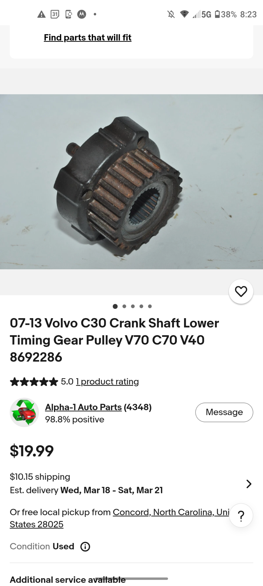

New $130.
Used (eBay etc) ~$20.
This is a part that I feel comfortable buying used. It is a solid piece of steel. Never seen anyone in forums replace it. Basically you have to use a grenade to blow it up...
Attached is a random photo from eBay so you can see...
