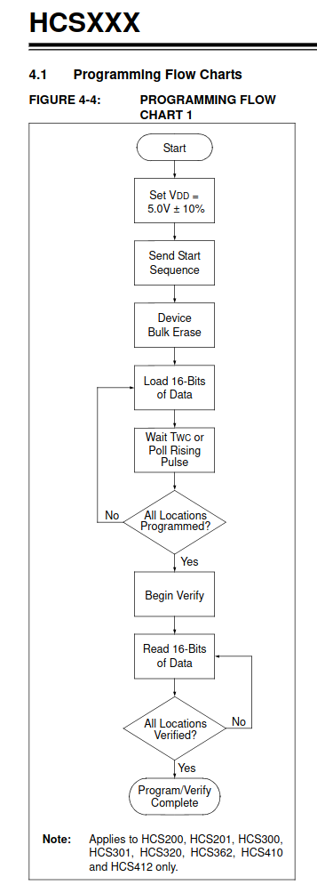

If only we knew Volvo's security key to program HCS412... Because upon entering program mode it self-erases.
Screenshot at 2026-04-03 11-29-53.png (88.29 KiB) Viewed 380 times

https://handwiki.org/wiki/Engineering:KeeLoq
Ah, a side-channel attack, my favorite :)
