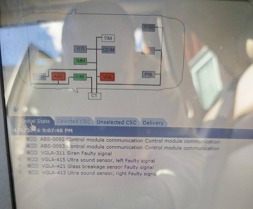

I think I'll have to take the car to a professional mechanic, but I have the latest update. I swapped the fuel injectors again, moving the injector from cylinder 1 to cylinder 3 and from cylinder 3 to cylinder 1. All the old errors disappeared from the VIDA! The engine is running better but still far from perfection. Twice I even had a little trouble getting the car to start, which has never happened before. ECM 3502 , ECM 3503 , ECM2120 (first oxygen sensor) ECM 9150 (throttle position sensor) have disappeared. What could that mean? Could that loud knocking sound coming from the engine be a faulty fuel injector?
Right now, I don't see any coolant leaks (I sealed up the one pipe that I think was leaking coolant) since 2 weeks.

It is hard to tell anything about noise without hearing it. You can record video and post it on YouTube and share here. That loud noise can be a misfire vs mechanical issue that causes misfire vs something just not bolted properly...I applaud your decision to take it to a mechanic(Hopefully a good one) and ask him for diagnostic help. In the meantime time, if car has no problems and drives good, you can try to add injector cleaner to the fuel and drive around(will not harm).
- Posts: 36137
- Been thanked: 4063 times
I would guess moving the injector reseated a gasket or oring on the injector and stopped your misfire. I lubricate them with a small shot of silicone to help them pop in easily
