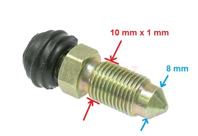

I posted info on ATE bleeder screw in this thread below...
P2 brake bleed nipples, Brake Bleed Screw is ATE-390354
viewtopic.php?t=94805&start=10
The ATE bleeder dimension is as shown. If you can find a conical copper washer with O.D. ~ 8mm,
it should solve the problem. Conical washers are used in fuel lines etc. Or you can simply use a flat
washer and tighten it down, it will become a conical washer...
