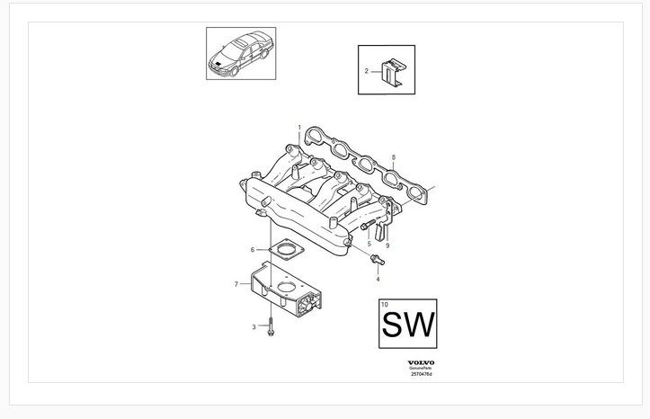

Soy confuso - the 1999 models dont have a position sensor like the -1998, all the sensing is done internally to the Electronic Throttle BodyJohnG1965 wrote: 16 Apr 2026, 04:40 Thank you both for the responses. It is a base SE model.
My lovely assistant will not be available until Friday after work. I should have the new position sensor delivered by then.
Since I still have the original throttle body installed, would a new sensor still require a software update?
Can you post up a picture or part number of the thing being replaced?
- Posts: 36153
- Been thanked: 4068 times
I think that is the 1998 version and wont work on a 1999 unless you have some FrankenVolvo going on.
If you dont have a mechanical cable running over top of your engine to the rear of the block (left side of car, facing forward, but pretty much middle of engine bay) that sensor wont fit anywhere.
Diagrams attached
Diagrams attached
- 1999 Throttle Body (Turbo underneath IM, non turbo on left side of IM)
- Screenshot 2026-04-16 at 08.49.30.png (68.4 KiB) Viewed 275 times
- 1998 Throttle Body
- Screenshot 2026-04-16 at 08.48.35.png (266.08 KiB) Viewed 275 times
