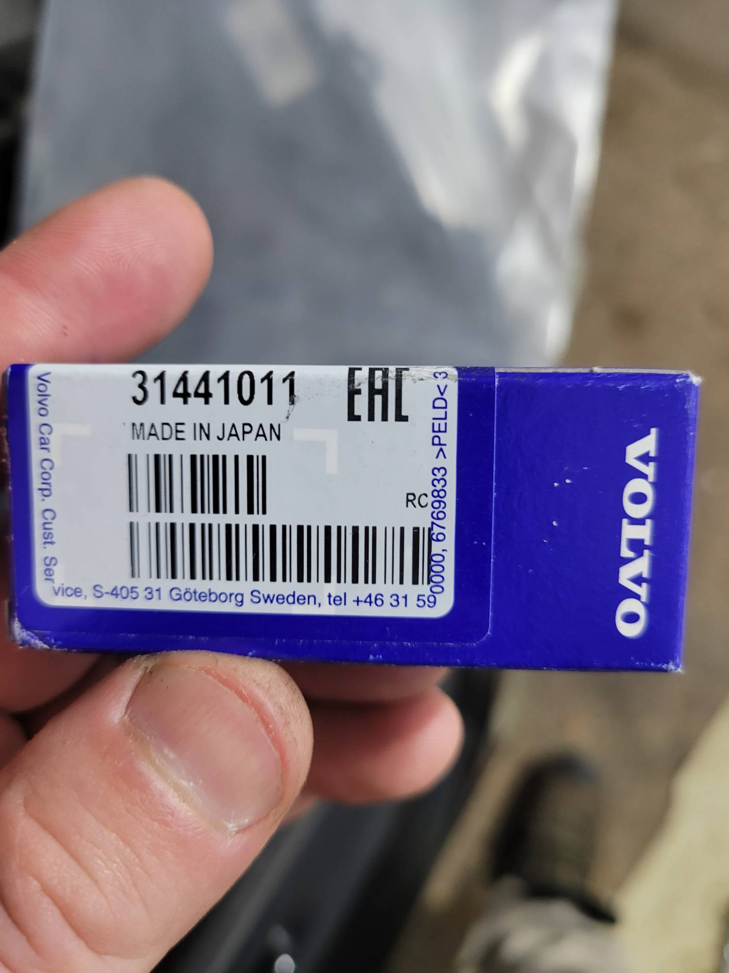

Parts cannon was fired due to inability to narrow further possible causes.

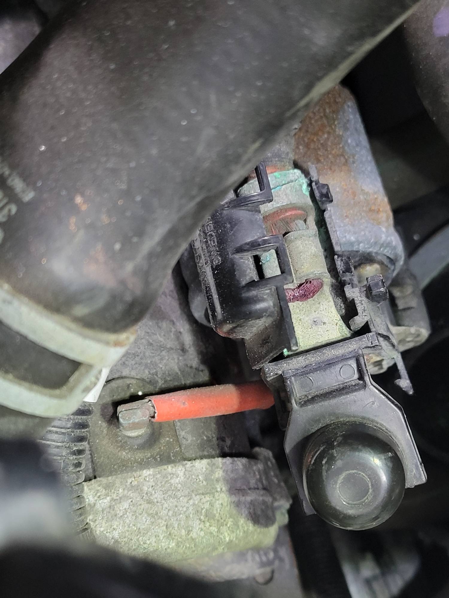

Knock sernsor was replaced. In case someone ever will need this, sensor located on the front of the engine. It is hidden more towards passenger side of the vehicle and can be seen between starter and throttle body. It is located in a way that you are unable to replace it without removing of the intake manifold or the throttle body. Due to not having a new manifold gasket I decided to go with throttle body removal aproach.

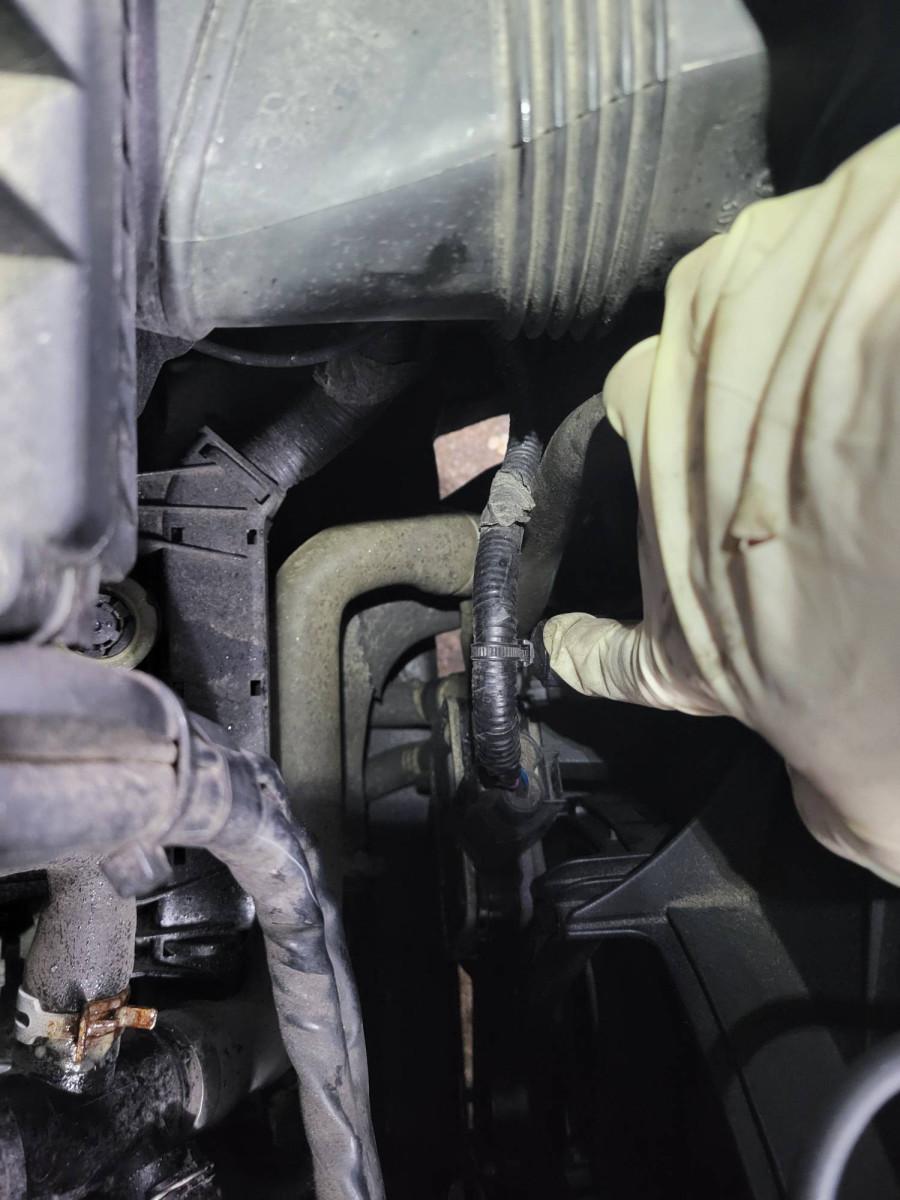

3. Disconnect big electrical connector from engine fan.
4. Carefully mive the plastic coolant pipe from the top of the fan shroud.

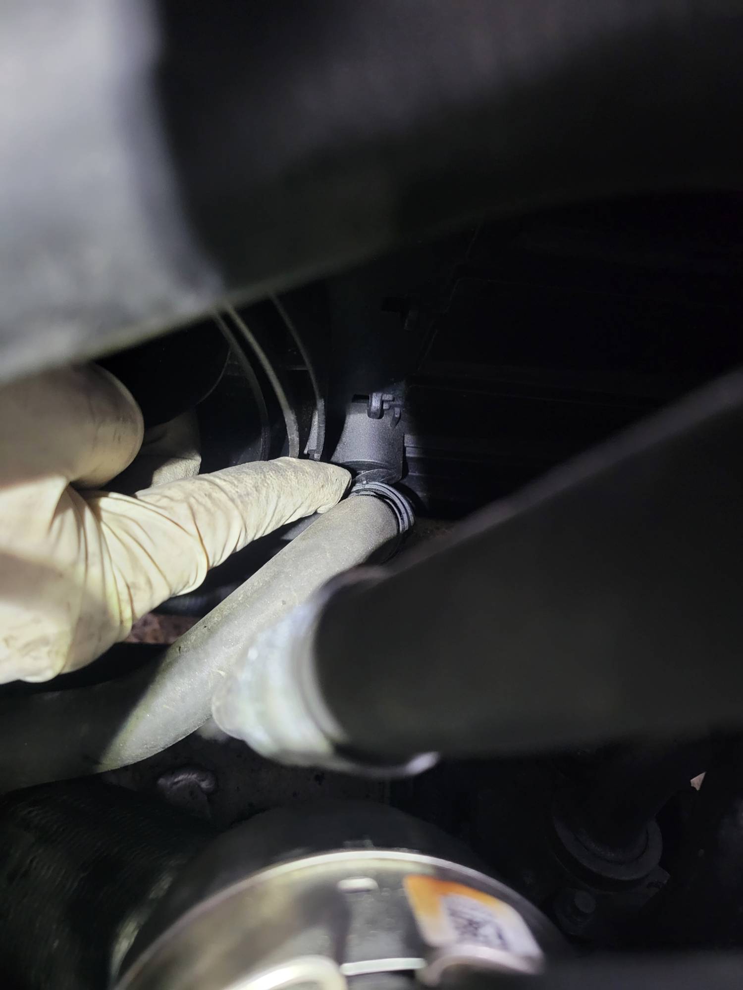

5. Look on the passenger side of the shroud towards bottom. You will see a clamping hose attachment holding the hose running there. Lift the clamp up and remove the hose from it.
6. Shroud is attached to the radiator with 2 top clamps(similar to P2), but they are way stiffer. Use plastic(preferably) trim tool to gently pry the tab on one side and lift the shroud past that clip. Repeat for the other side.
7. In order to get more "wiggle room" remove 2 triangular looking radiator holders located next to the hood locks. It is T30 i believe screw holding them after which you simply lift them up.
8. You will need all your patience here. Start moving the shroud out towards the top. It is a delicate process and room is very limited. You possibly will need to put some pressure on the plastic of the shroud to get it past metal sheet that is located on top of the radiator. I was able to remove the shroud by first lifting it up from lover support "hooks"(during reassemble please note that shroud will need to get inside of those hooks to stay stable), then passenger top corner and slowly wiggling it out. You also will need to be watching radiator hoses and push them aside to prevent damage. Luckily they are rubber. Cut a piece of cardboard and plase next to radiator to prevent damage.

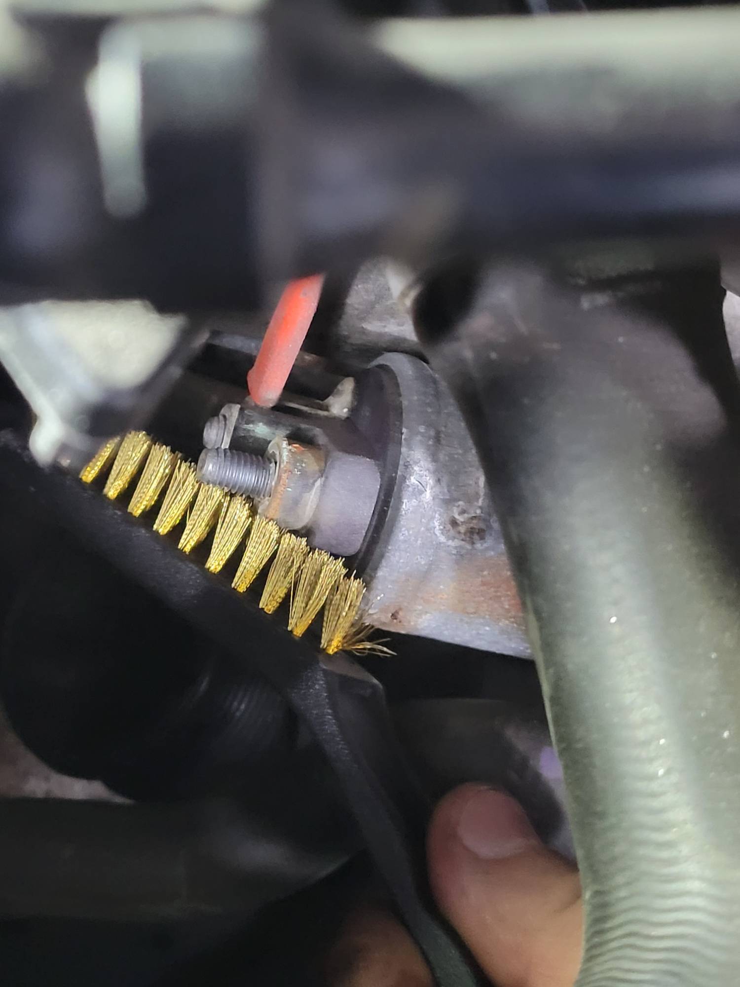

10. Look at your starter cables. If you are in the rust belt, you might see plenty of corrosion here.

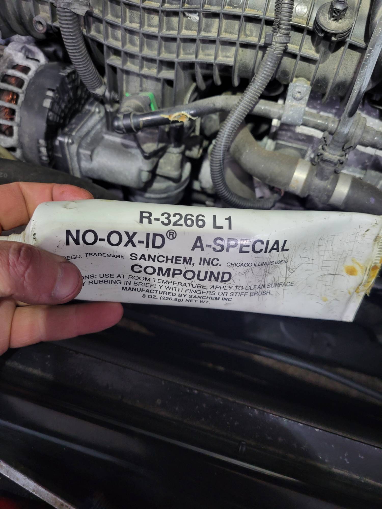

Remove the cables by unscrewing 10mm and 13mm nuts. Move cables away. For reassemble, clean everything nicely with brass wire bush and remove oxidation. Apply NO-OX-Id paste tight back.

14. Remove connector from knock sensor.
15. Remove t25 or t30 bolt holding evap(or cooling)plastic pipe located just below the knock sensor.
16. Unbolt knock sensor. 13mm long bolt.
17. inspect the connector of the knock sensor and throttle body for any damage or oxidation. Clean with electric parts cleaner spray/deox electric spray. Dry with compressed air or juat wait some time(it will evaporate quickly)

19. Install new sensor and reassemble in reverve order.
