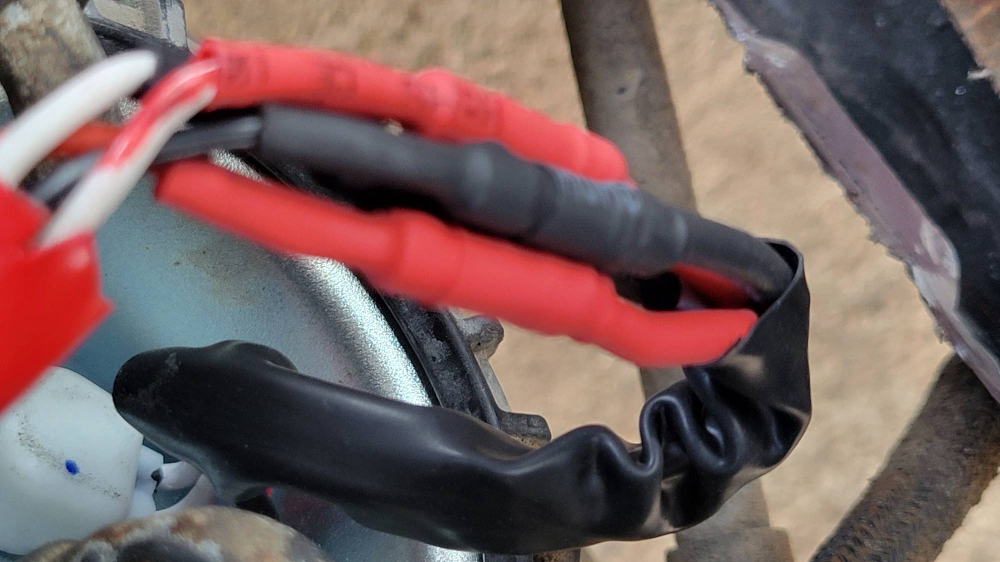

Yes I went through the cut process and installed the pump that I got from FCP. I got that because of their lifetime warranty policy. I plan on trying to find a way to repair the original one or may just get the Vast (looks just like PPS with DW200 to be put inside). I had no idea about the Vast. Only saw the DW200 pump being available. For now, PPS pump started the car right away with temporary connection (all 4 wires twisted to corresponding wires). I will be putting 3.5mm bullet connectors to those wires for future removal.

Do a hard solder with nasa splice and heat shrink on those wires, especially of you are in humid country.
