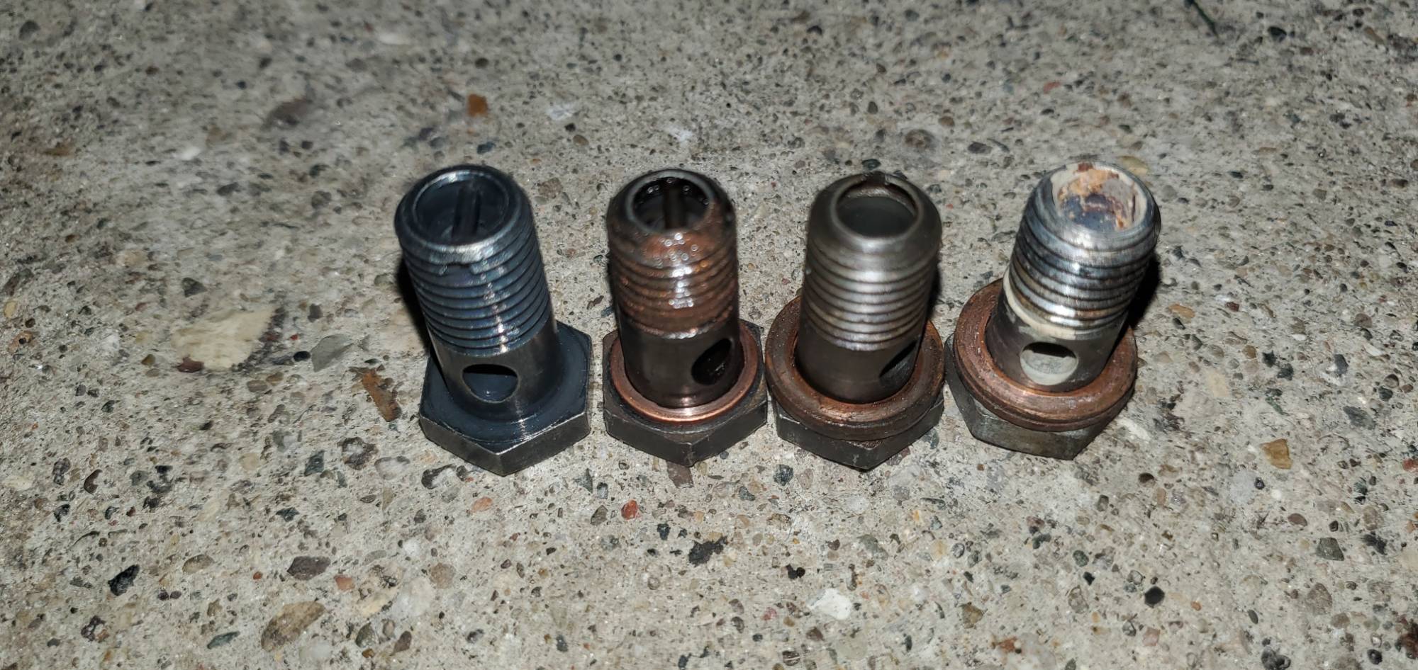

I had a bad banjo bolt destroy the top end on a P2 car. So I sorted through this issue and interpret that the most updated part is 31325709. On all my P2 cars I replace the banjo bolt pre-emptively with a 31325709, unless there is a record it's been done already.

Here is a picture of several Volvo P2 banjo bolts:
From left to right: New style check valve with drilled pin holes and a roll pin pressed through the holes (no crimp), old style with crimped pin retention on the end of the banjo bolt and the pin is still present, old style with missing crimped pin and no check valve guts because they went into cylinder 3, and on the right, cooling/oil system banjo bolt which has no guts.

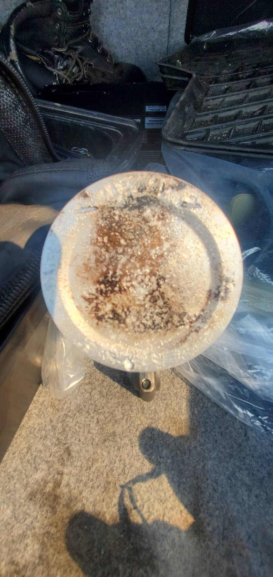

After the guts of the check valve destroy the engine valves and top of the piston in cylinder 3, they then go out an exhaust valve and destroy the turbo vanes on the hot side: Top of the cylinder #3 piston: Valves before replacing the head - note the big gouges in cylinder 3: Thankfully the engine is running perfectly after replacing the head, piston 3 and piston rings, and turbo.
