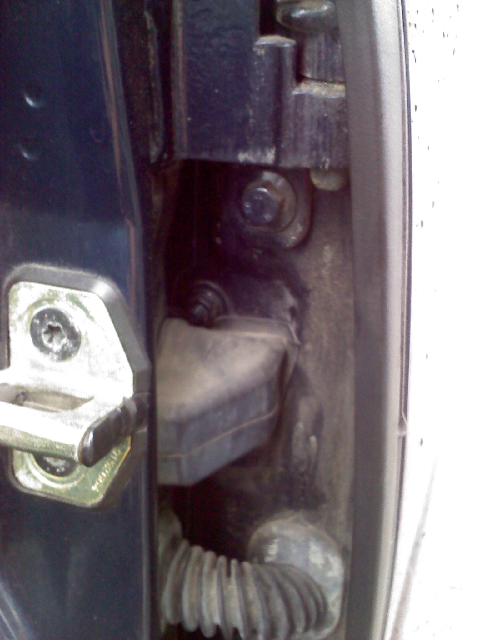

Post by jblackburn »
I think you should be able to unbolt the door from the front of the car and gain access to the door panel tabs.
Will it give you enough flexibility to move it around to release the latch? I don't know.
