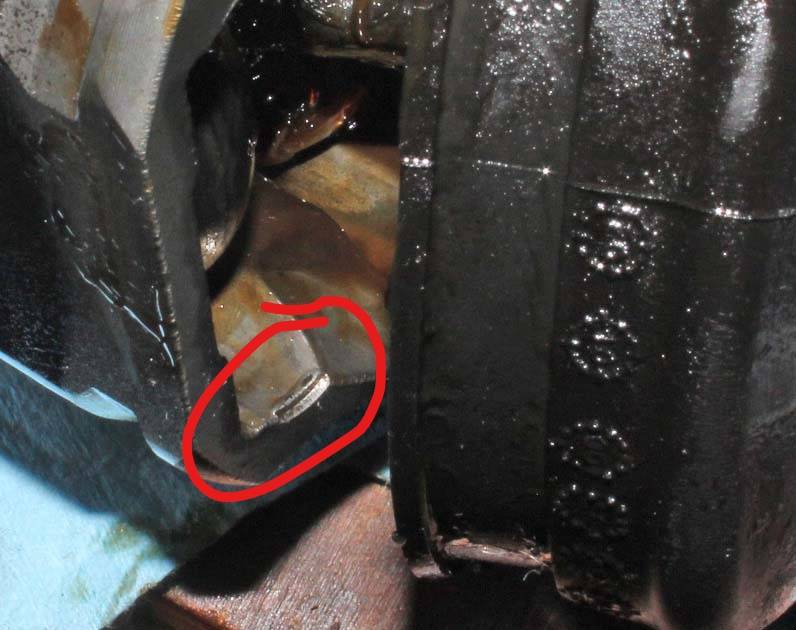

I got it apart but it will not re-assemble again, I want to trial fit before greasing it up.
is there a trick?

Post by cn90 »
The Tripod CUP has stakes to hold the joint in place.
Look carefully, you will see the factory stakes on the CUP itself.
Either file the stakes a bit or stand it up and use rubber hammer to drive it in.
At factory, they install the tripod then used a staking tool to create a stake.

jonesg wrote: 03 Aug 2026, 18:55 I got it apart but it will not re-assemble again, I want to trial fit before greasing it up.
is there a trick?
S
Inkedvolvo inner cv joint staked end_LI.jpg (65.46 KiB) Viewed 685 times
FIle down or peen/hammer down.

Post by jonesg »
got it all done, test drove it yesterday and its good.
