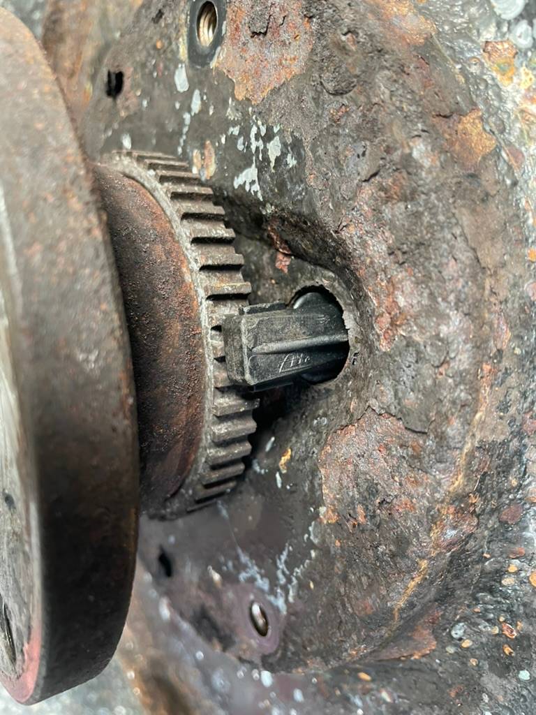

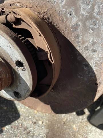

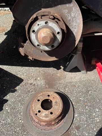

15 minutes to strip down
19mm lugs
10 mm rotor screw
13 mm caliper bolts
punch and hammer for pins
30 seconds MAPP - then an 11mm flare wrench to loosen hard line
Sledge hammer on rotor
1999 V70 T5 M56 seized rear right caliper... brake job 31262626/31262480 31262622/ 3(now turned into a bad parts thread)

Yikes! I really don't envy your East coast cars. They sure get crusty. We get corrosion here too with the road salt and de-icing agent used on the roads, but still not typically that bad. They only cars that get that bad are the ones that never get fixed and sold when the last straw breaks.

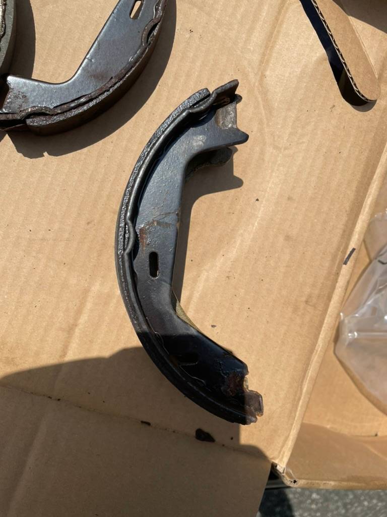

Circling back to this job. I bought 622 awd and 626 fwd rear parking brake shoes to see if this was the problem
Hmmmm
Hmmmm
- Posts: 36149
Maybe I’m using awd disc/drums and got my parts muddled?

The 626 shoes sure have a deeper notch into the actuated side of the shoes. Unless the problem is the disc/drum, it sure seems like the shies aren’t close to the right position on the backing plate. I recall at rest, the chrome clips are almost fully engaged on the shoes at the rest position, mine are less than half ( photo upstream)
