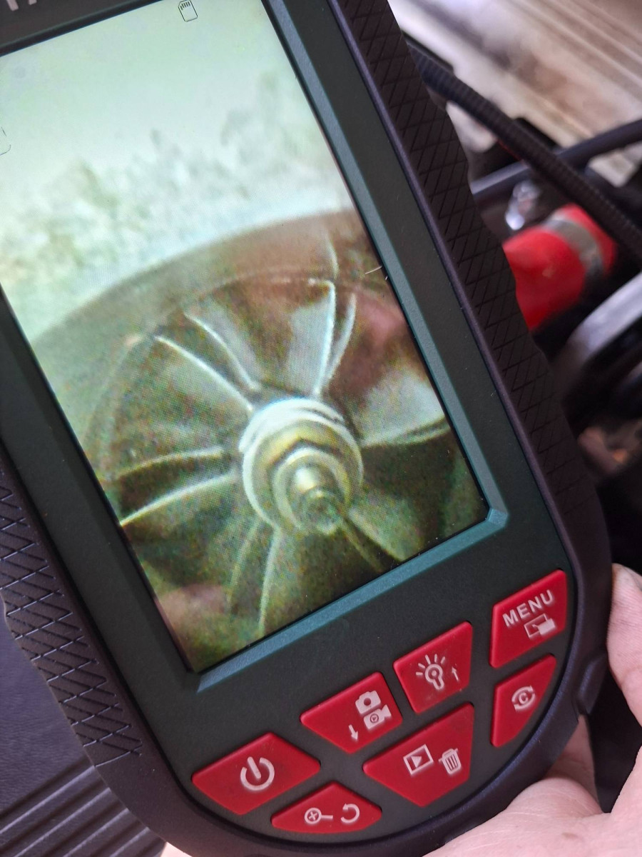

Found the issue!!!
Hello everyone! I want to say thanks for the great ideas and tips. Well the good news is that I found the issue for cheap, the bad news is that the issue is not cheap hahah.
So a friend and I used a cheap pump, vacuum lines and literal cigarrets to smoke the car for vacuum leaks. Worked great! (If you use a rubber glove to force the air into the system instaid of going out the filter). We had also taken out the front panels to see every clamp and rubber fitting. There where 2 "leaks" (see photo's). One is on the bottom of the intercooler, while the other is at the back of the car, connected to the intake with vacuum line and the other to petrol pressure line. I do have a question, what are they,is it normal and what is it for?
To get to the point, we checked the turbo Turbine again to make sure it was not simply that...well...4 weeks ago i also checked and I found nothing...maybe I was drunk or high as a kite since the play we found was a centimeter or so (3rd of an inch for you americans) so yeah the turbo is cooked. We also saw with a camera line tool some scraping and stuff (see photo) so it was simply that.
Now I have a 850t5-r engine, my question is now: which type of turbo is it normaly? 15G? And is it the coned or straight variant/how can you confirm that? Furthermore which turbo's are plug and play and also do not need a new ECU tune?
Kind regards, Thegingerwiththevolvo
