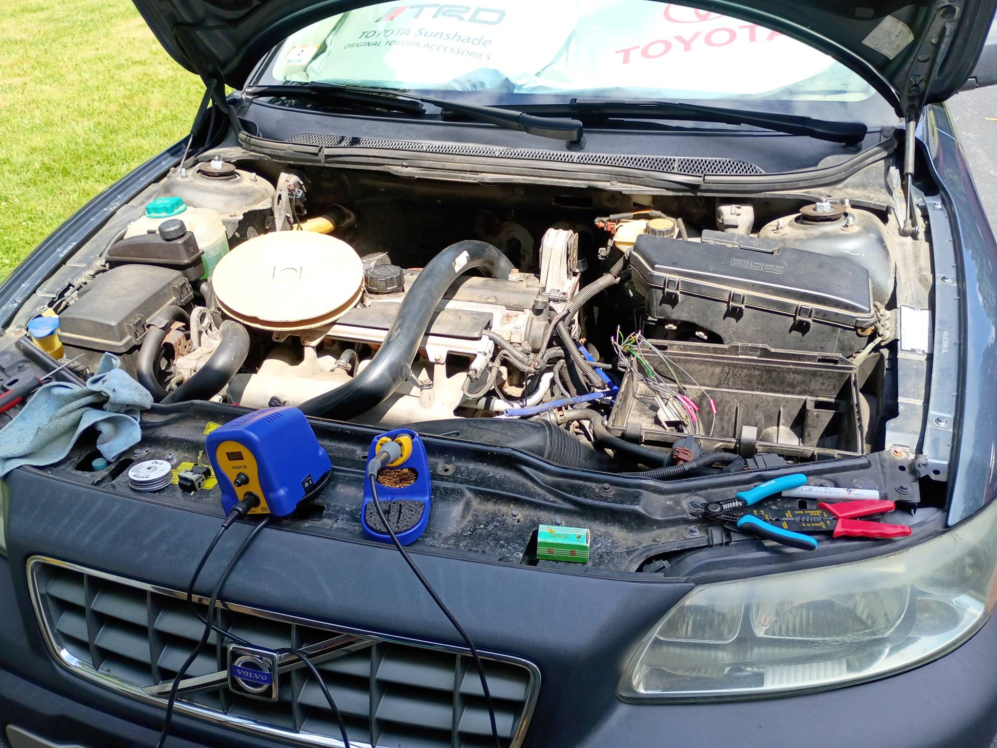

Thanks for the speedy response @DavidE7--I did try swapping the cylinder 1 coil out after replacement, no luck there.
I don't have a compression tester so haven't gone that route, but I would think it would run kinda poor all the time if I'd lost compression on cylinder 1...
I've had the cover that hides the ignition coils off for weeks as I troubleshoot this. Wiggling the wire harness or the coil plugs doesn't help or hurt. Between the new connector for coil 1, and the fact that I have good continuity through the harness to the ECU even while poking around and nudging the wire harness, I'm pretty sure the wiring is good.
I'm not sure I follow your comment about exposed ignition wires--the business end of the ignition coils where the high voltage lives is hidden inside a rubber boot down in the spark plug wells--I've certainly seen the tiny sparks you mention and been rudely shocked by a few cracked plug wires on old distributor-based systems, but all the wiring here is low voltage. +12V, ground, and a 12V control signal that drops to ground to initiate a spark from the coil.
I haven't personally pinched the wire loom with the cover, but I've only owned this car for a tiny fraction of its 24 years...

Okay, I guess there's some consensus these symptoms could be caused by bad compression on cylinder 1, but would that really cause intermittent misfiring? I would think worn rings, stuck valves, blown head gasket etc. would manifest with a constant rough idle/misfire. The engine runs very smoothly until suddenly it doesn't and the CEL comes on. Could that really be due to poor compression? Also, would poor compression cause a "no signal coil 1" error code?
I bought a set of new injector o-rings, and pulled the fuel rail to investigate the effect of swapping injector 1 and 2 to see if that would shed any light, but the cylinder 1 injector had a substantial chip out of the plastic ring above the block-facing o-ring. That ring then came off completely while removing the old o-ring---it doesn't appear this plastic washer is a replaceable part, so I went ahead and ordered a new injector to put on cylinder 1.
I should have time to work on it this weekend and will report back what happens with the new injector and perhaps a compression test if that doesn't provide any insights...
