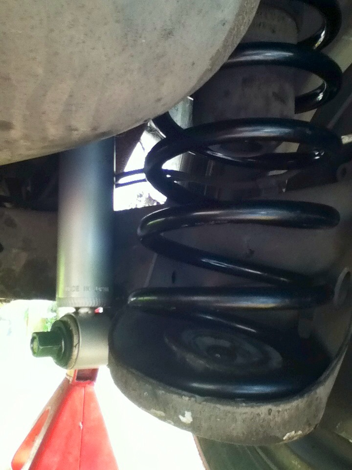

I replaced a pair of rear coil springs and rear shocks on my 850 wagon yesterday. Is it required that I have the rear wheel alignment done?
- IMG_0001_2.jpg (149.62 KiB) Viewed 1400 times
